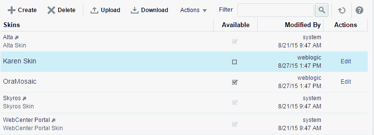

Shared assets are identified by the Shared
icon. To work with shared assets, you must use the Shared Assets page (see Working with Shared Assets).

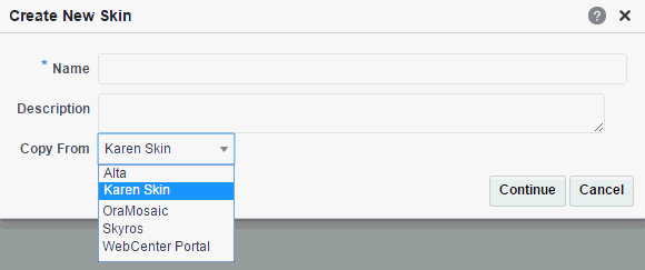

Skins |
Yes |
Only by making a copy of another skin |

Editing Assets
The Assets page enables you to edit the assets that have been created within a portal. It provides two options for editing assets:
Edit—Provides a means of editing an asset either in Structure view in the page editor or in an Edit dialog.
Edit Source—Enables you to work with the source code of an asset.
You may want to edit an asset's source file to make advanced edits to its code without having to download the file, edit it in JDeveloper, and upload it back into WebCenter Portal. You can even use the Edit Source option to create an asset from scratch; by creating the asset and then replacing its default source code with your own original code. Note, however, that, due to the heavy hand-coding requirement, this scenario is not recommended, and should only be done by experienced ADF developers.
You cannot edit built-in assets. If you want to modify a built-in asset, you must first create a copy of the asset and then edit the copy according to your requirements.
WebCenter Portal supports round-trip development of assets. To get enhanced functionality for your assets, you can download the asset, edit it in JDeveloper, and then upload it back into WebCenter Portal. For more information, see Working with Portal Assets in JDeveloper.

Showing and Hiding Assets
The system administrator can make shared assets available for use in all portals, or hide some assets so that they cannot be selected in a portal. At the portal level, you can make a custom asset available for use in a portal by marking it as available, or you can hide an asset to prevent users of your portal from selecting it. For example, you may want to hide an asset while you are making further refinements to it after its initial creation and publication.
Even if an asset is hidden, it can still be referred to by its internal ID through an EL expression. For example, you can refer to a hidden page template by using an EL expression to set the Page Template value on the Settings page in portal administration.
The following table shows several skins. The built-in shared skins are all available, the custom OraMosaic skin is available, and the custom Karen Skin is hidden.
Figure: Showing and Hiding Assets
When you first create or upload an asset, by default it is marked as hidden. A hidden asset is not available for wherever assets are selected. For an asset to become available, it must be published, that is, made available. For example, the figure shows the list of skins that are available for selection as the portal’s default skin. Note that the hidden skin, Karen Skin, is not included in this list.
Figure: Hidden Asset Not Available for Selection to Assign
You can, however, use a hidden asset as the starting point for creating a new asset. For example, the figure shows that the hidden skin, Example Skin, is listed in the Copy From list when you create a new skin.
Figure: Hidden Asset Available for Selection to Copy
To show or hide an asset:
- Open the Assets page for the portal that owns the asset.
- Click the type of asset that you want to show or hide (for example, Page Templates).
- Select or deselect the check box in the Available column for the asset that you want to show or hide.
Copying an Asset
You can create copies of most assets, including the built-in assets. This is useful for when you want to:
When you create a copy of an asset, the copy is initially hidden regardless of the status of the original asset.

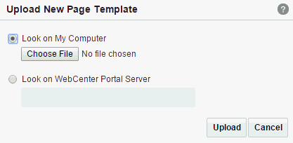

Uploading an Asset
You cannot download an asset from one portal, then upload that same asset to another portal. In other words, migrating assets from one portal to another is not supported. To use an asset across multiple portals, the asset must be created as a shared asset.
When you upload an asset to WebCenter Portal:
Shared assets are available for use in all portals, unless a portal has been specifically excluded.
Portalassets are available for use only in the portal in which they are created.4
To upload an asset:
Portalassets are available for use only in the portal in which they are created.5
