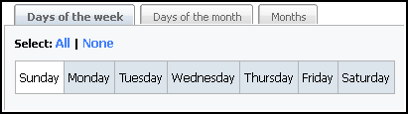

Now you select days, months, hours, and minutes to set a schedule.
The form for setting a publish event is similar to the form for setting a timed action event in workflow. See Setting Up the Timed Action Event.
Example schedule:
For example, to set a schedule so that WebCenter Sites publishes the assets approved for this destination at 7 a.m., 4 p.m., and 8 p.m. every day of the week except Sunday, you would complete these steps:

Days of the week are expressed as numbers 0 (Sunday) through 6 (Saturday) and end with the slash (/) character.
If either no days or all days were selected, the publish event runs every day of the week. An asterisk (*) character is in the field in that case.
If multiple days are scheduled, the selected days are displayed with commas separating them.
The example schedule includes all the days of the week except Sunday. Therefore, the days of the week are appended to the display as follows: 7,16,20:0:0 1,2,3,4,5,6/

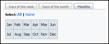

After the string are the months, displayed as numbers from 1 (January) through 12 (December).
The list of months is separated with a comma.
If all the months are selected, the publishing event will run every month. An asterisk (*) character is in the field in that case.
The example schedule specified all the months. Therefore, the final result is:
7,16,20:0:0 1,2,3,4,5,6/*/*

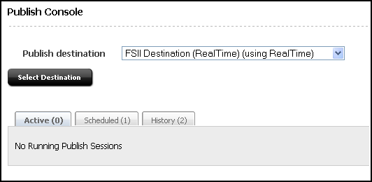

17.6 Monitoring Sessions in the Publishing Console
You use the Publish Console to monitor publishing sessions. To open the Publish Console, click the Publishing button at the top of the WebCenter Sites interface. The Publish Console form will open.
The console displays a summary of all the publishing activity, including any sessions that are currently running, scheduled, or completed.
