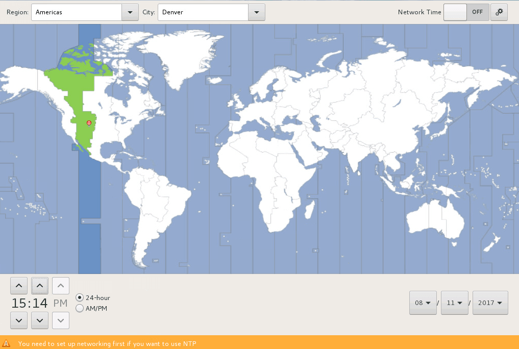

Date and Time
The Date & Time screen lets you set the following:
                              Time zone for the system
                              Actual time and the format for displaying time
                              Current date
Figure 3-5 Date & Time
To select the system's time zone, select an area on the map that corresponds to where the system is. Or, you can select from the Region and City drop down lists to specify that location.
To select the system's time zone, select the appropriate location from the Region and City dropdown lists.
To specify time, time format, and date, select the appropriate buttons at the bottom of the screen.
To enable NTP, switch the Network Time switch at
        the upper right corner of the screen to ON. Select
          Settings to display a dialog box, where you can configure NTP
        servers for the system to use.
You can skip configuring NTP until later by using the Chrony suite. See Oracle Linux 9: Setting Up Networking. See also Configure Chrony on Oracle Linux.
