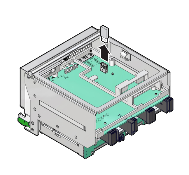

Remove the Internal USB Flash Drive
This is an internal component that is accessible from the back of the server by removing the SMOD. Perform this procedure to access and remove the internal SMOD USB flash drive.
  1. Prepare the server for cold service.
    This is a cold-service component. Power down the system and disconnect the AC power cables from the server before performing this procedure.
    See Preparing the Server for Component Replacement.
  2. Remove SMOD0 or SMOD1.
  3. Set the SMOD on a flat surface with the front side facing toward you.
  4. Close the SMOD handles.
  5. Rotate the SMOD 180 degrees so the back (connector) side is facing toward you.
  6. Turn the SMOD upside down and locate the HBA card.
    The connector (back) side of the SMOD should still be facing you.
  7. To remove the USB drive, pull it out of its slot.
    The USB flash drive slot is located inside SMOD0 or SMOD1 next to the HBA card.
    Image showing USB drive being removed.
