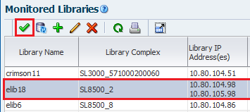

Test the Library Connection
Test the connection between STA and each library. For SNMP, this test is required. For SCI, it is highly recommended.
To avoid dropped connections and lost library data, you should perform
this procedure for each monitored library whenever you add or change connection settings
for the library or the STA client.
