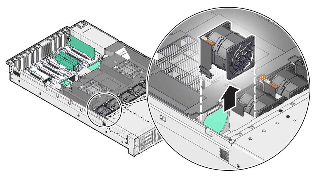

  5. Using your forefinger and thumb, lift the fan module straight up and out of the chassis and set it aside on an antistatic mat.
    Caution:
    Excessive movement or rocking of the fan module during removal can cause damage to the internal connector on the fan module board. When removing a fan module, do not rock it back and forth.

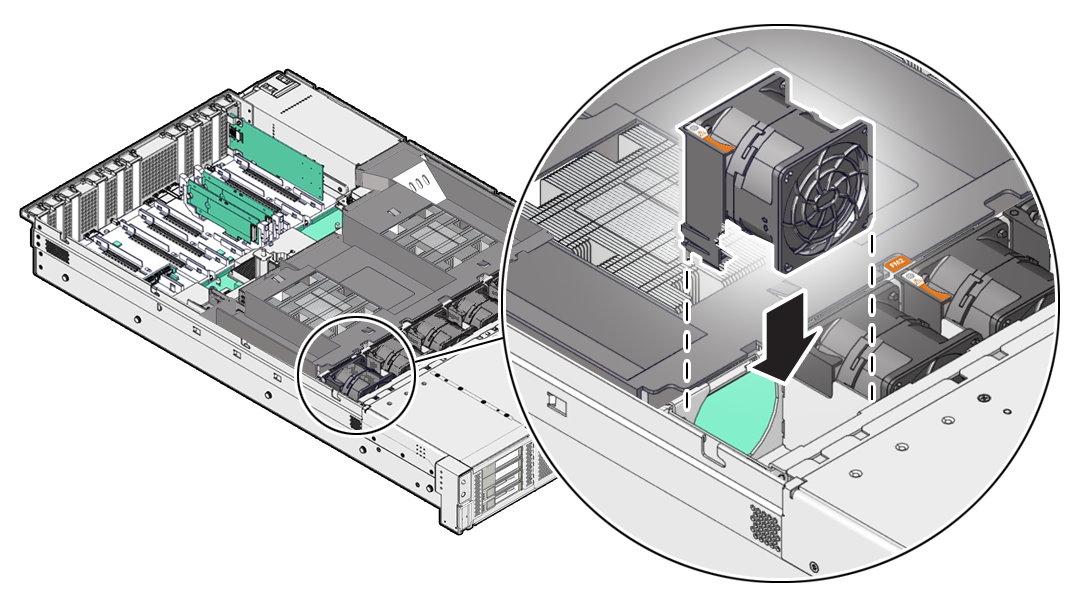

  6. Position the replacement fan module so the connector on the bottom of the module is aligned with the connector on the inside of the slot and all keying and labeling are correctly positioned.
    The fan modules are keyed to ensure that they are installed in the correct orientation.
    Figure showing how to install a fan module.
  7. Press down on the fan module to fully seat the fan module.
