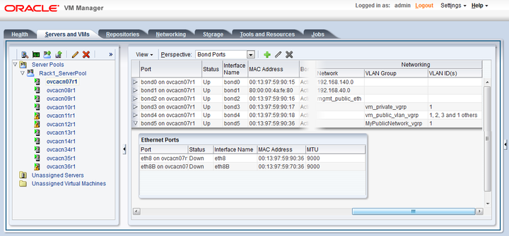

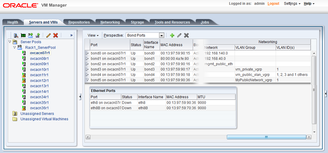

Figure 2.4 shows a custom network named MyPublicNetwork, which is VLAN-enabled and uses the compute node's
bond5interface consisting of Ethernet ports (vNICs)eth8andeth8B.To disconnect servers from the custom network use the remove network command.
