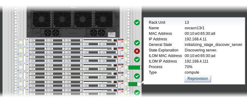

Reprovisioning a Compute Node when Provisioning Fails
Log in to the Oracle PCA Dashboard.
Go to the Hardware View tab.
Roll over the compute nodes that are in Error status or have become stuck in the provisioning process.
A pop-up window displays a summary of configuration and status information.
If the compute node provisioning is incomplete and the server is in error status or stuck in an intermittent state for several hours, click the Reprovision button in the pop-up window.
When the confirmation dialog box appears, click OK to start reprovisioning the compute node.
