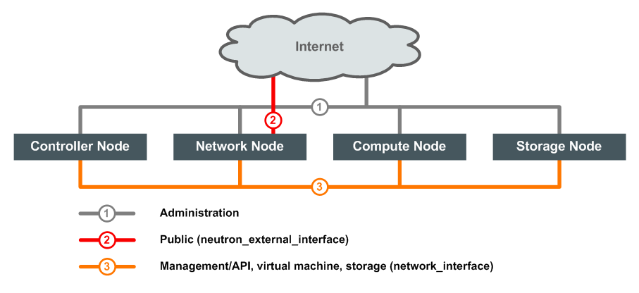

Figure 3.1 shows the default network configuration and the properties that specify the network interfaces on the target nodes.
Figure 3.1 Default Network Configuration
In the default configuration, the neutron_external_interface property specifies the name of the network interface on the public network. To make it easier to get started with deploying OpenStack services, the management/API, virtual machine, and storage networks are consolidated into a single network. The network_interface property specifies the name of the network interface on this network. This configuration requires the minimum number of network interfaces.

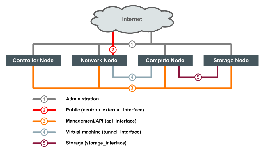

While consolidating the management/API, virtual machine, and storage networks into a single network makes it easier to deploy OpenStack services, for performance and security reasons it is best to separate and isolate these networks. Figure 3.2 shows a fully-expanded network configuration and the properties that specify the network interfaces on the target nodes.
Figure 3.2 Expanded Network Configuration
With this configuration, the neutron_external_interface property specifies the name of the network interface on the public network, and there are separate properties for specifying the names of network interfaces on the management/API (api_interface), virtual machine (tunnel_interface), and storage (storage_interface) networks. This configuration requires the maximum number of network interfaces.
