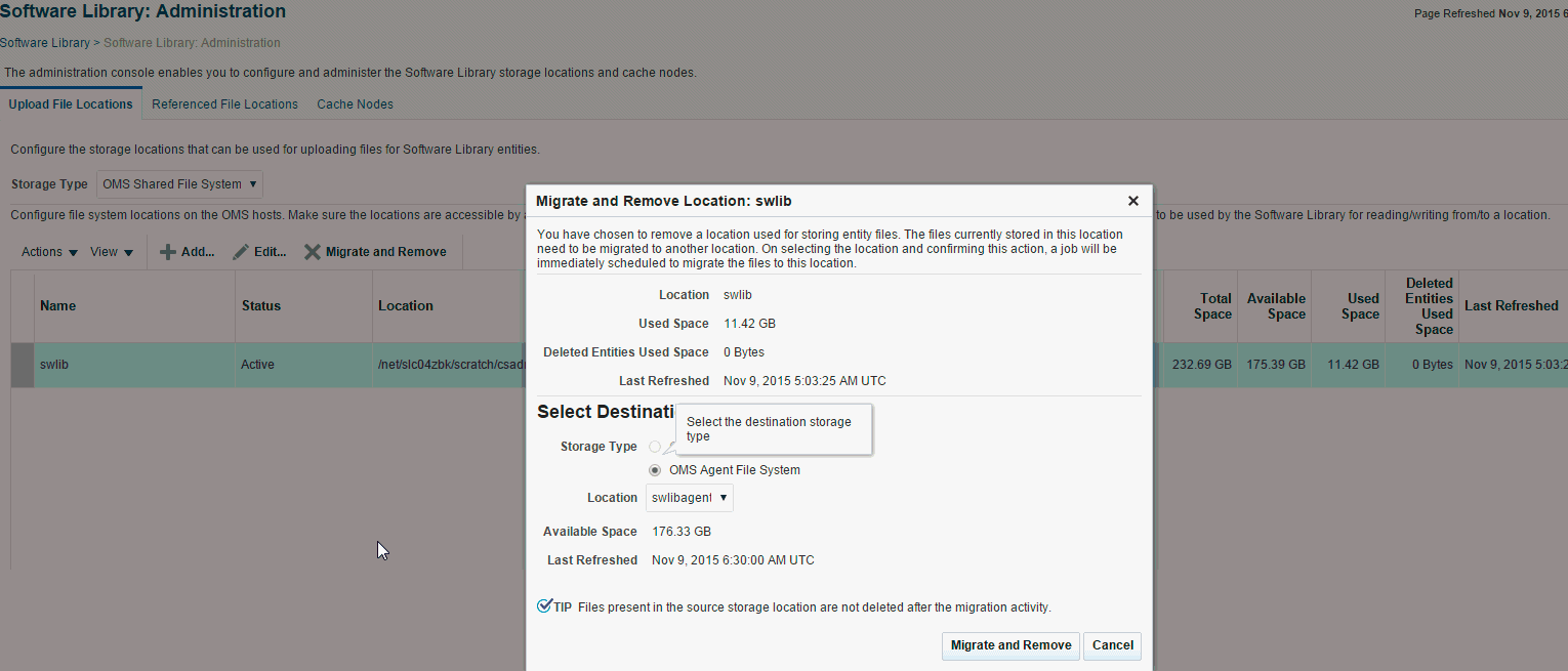

Software Library Storage Administrators have the required privileges to delete a storage location. If a storage location is not in use, then you can remove it instantly. However, if it is in use, then you must migrate the contents to another location so that the entities using these files continue to remain usable.
Before removing a storage location that is currently in use, you are prompted for an alternate location for the files. After you select an alternate location, a migration job is submitted, and the location is marked as Migrating. After successful migration of the entity files to the new location, the location configuration is deleted. In case of any errors during migration, the location is marked as Inactive. Once the errors are fixed, and the storage administrator ascertains that the location is good to use, the location is marked as Active.
To remove a location from OMS Agent File System or Referenced Agent File System storage, you must have a view privilege on the credentials for the location being removed, and the alternate location where the files are migrated.
To delete a configured storage location, perform the following steps:

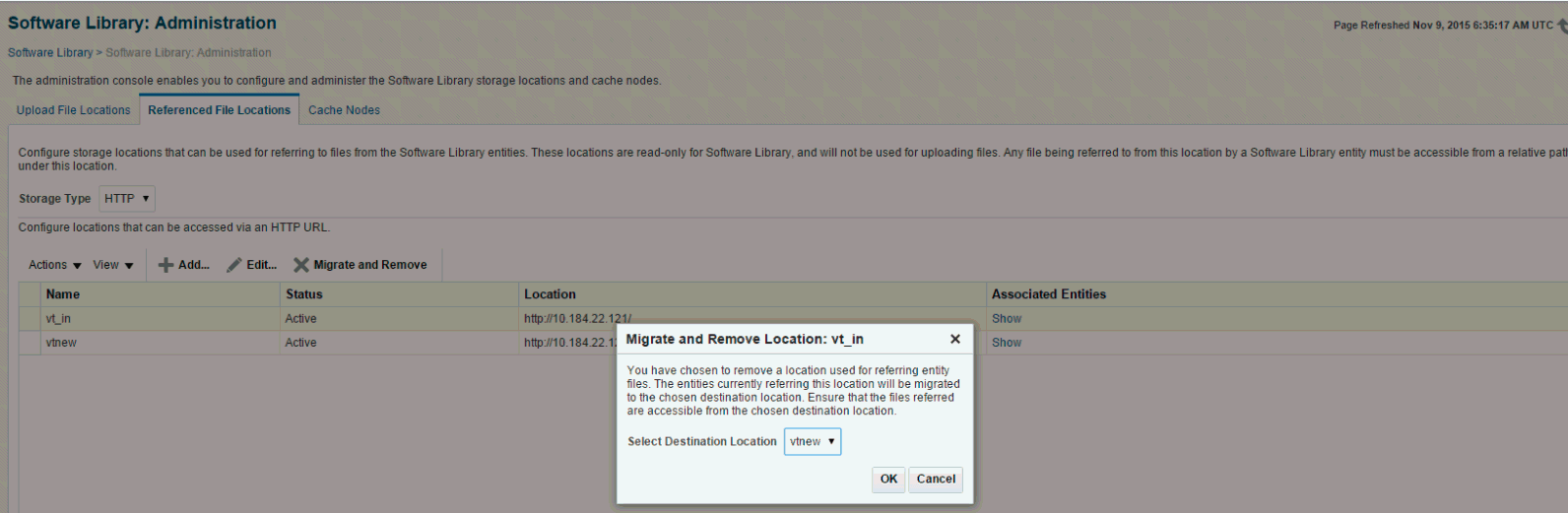

To remove a configured reference storage location (HTTP/ NFS/ External Agent Location), perform the following steps:

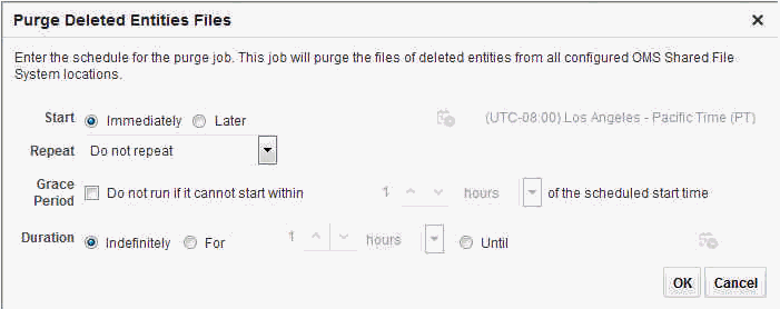

Starting with Enterprise Manager 12c the purge job can be scheduled. To do so follow these steps:
In Cloud Control, from Setup menu, select Provisioning and Patching, then select Software Library.
On the Software Library Administration page, select the storage location, and from the Actions menu select Purge. The following dialog box appears where you can schedule the purge job:
Enter all the details and click OK to submit the job, on successful completion of the job all the deleted entities are removed from the storage location.
