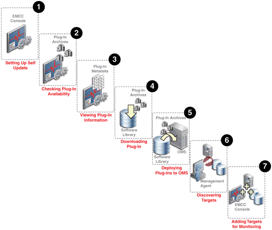

Figure 23-1 illustrates the workflow of plug-in deployment—how you typically set up the Enterprise Manager infrastructure, deploy plug-ins to OMS, and discovery and monitor targets using the deployed plug-ins.
Figure 23-1 Plug-In Deployment Workflow
Step 1: Setting up Self-Update Console
Self Update console is a common dashboard used for reviewing, downloading, and applying new updates available for Enterprise Manager. The console frees you from having to monitor multiple channels to get informed about new updates that are available from Oracle. The updates automatically downloaded by Self Update include plug-ins. For checking the availability of plug-ins and downloading them to Enterprise Manager, you must set up the Self Update Console. Set up the Self Update Console as described in Oracle Enterprise Manager Cloud Control Administrator's Guide.
Step 2: Checking Plug-In Availability
Checking the plug-in availability essentially refers to the act of verifying whether the plug-ins are available on My Oracle Support for download and deployment in Enterprise Manager. This is a prerequisite before downloading plug-ins. To check plug-in availability, follow the steps outlined in Checking the Availability of Plug-Ins.
Step 3: Viewing Plug-In Information
Viewing plug-in information refers to the act of viewing basic information related to a particular plug-in, such as the plug-in ID, the plug-in release number, and other basic information. You must view plug-in information to understand what targets and operating systems are certified for plug-ins. You can also check whether or not a particular plug-in has already been deployed. To view plug-in information, follow the steps outlined in Viewing Information about Plug-Ins.
Step 4: Downloading Plug-Ins
Downloading plug-ins is the act of downloading plug-in archives or components, and its metadata, from My Oracle Support to Oracle Software Library (Software Library), so that they can be deployed suitably for discovering and monitoring certain targets. If you find that a particular target is not being monitored by plug-ins, you must download the required plug-ins. You can download both in online mode and offline mode. To download plug-ins, follow the steps outlined in Downloading Plug-Ins.
Step 5: Deploying Plug-Ins to OMS
Deploying plug-ins to OMS is the next natural course of action once a plug-in is downloaded from My Oracle Support. This is to ensure the OMS capabilities are extended to either manage a new target or to add a new vertical capability. The installation and configuration of plug-ins on the OMS is essentially referred to as Deployment. Some plug-ins, when deployed, require the OMS to be re-started.

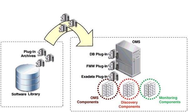

Figure 23-2 illustrates how plug-ins are deployed to the OMS.
Figure 23-2 Deploying Plug-Ins to OMS
When the plug-in archives are deployed from the Software Library to the OMS, the OMS receives three different components for each plug-in, namely the OMS plug-in components, the discovery plug-in components, and the monitoring plug-in components.
Discovery plug-in components are those components that help in the discovery of unmanaged targets. Monitoring plug-in components are those components that help in the adding of discovered targets to Enterprise Manager Cloud Control Console for monitoring purposes.

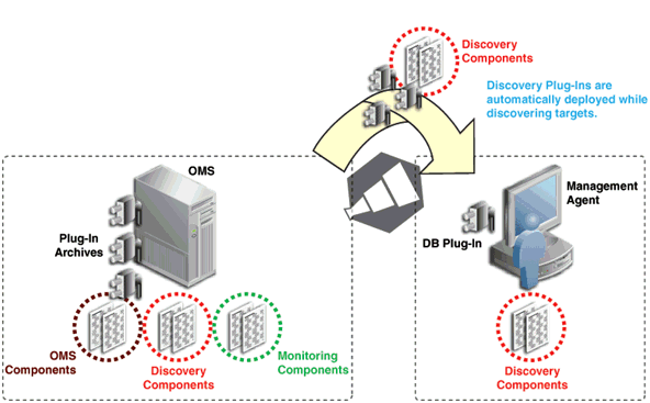

Figure 23-3 illustrates how the discovery plug-in components are deployed to the Management Agent while discovering new targets.
Figure 23-3 Discovering Targets

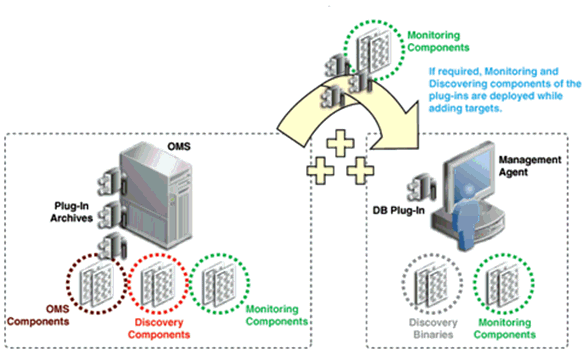

Step 7: Adding Targets for Monitoring
Once the targets are discovered, they are added to the infrastructure, so that they can be monitored in Enterprise Manager Cloud Control. While adding targets, the monitoring components of plug-ins are deployed to the Management Agent home.
Figure 23-4 illustrates how the monitoring plug-in components are deployed to the Management Agent while adding targets.
