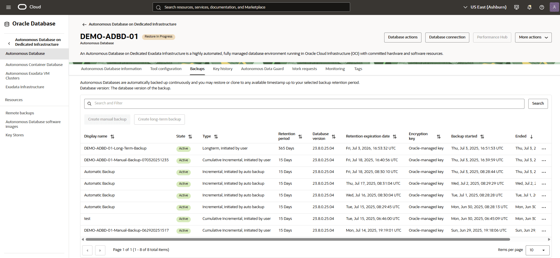

- From the OCI console, you can navigate to Autonomous AI Database, and then select Backups tab.
- From the Backups tab, select the three-dot navigation menu , and then select the Restore button.
- A warning message will appear to confirm the results of the attempted restore. This action will restore the current database to the selected timestamps. After confirming, select the Restore button.
- Return to the Backups tab within your Autonomous AI Database to view the State of your restore process. Once the restoring process is complete, the State will change from Active to Restore in Progress.

- From the OCI console, select Autonomous AI Database that you are using.
- Select the Backups tab. Do not select any backup from the list that has the following attributes:
- Display name: Automatic Backup
- Type:Longterm and initiated by user
- From the three-dot navigation menu, select either the Restore or Create clone option.

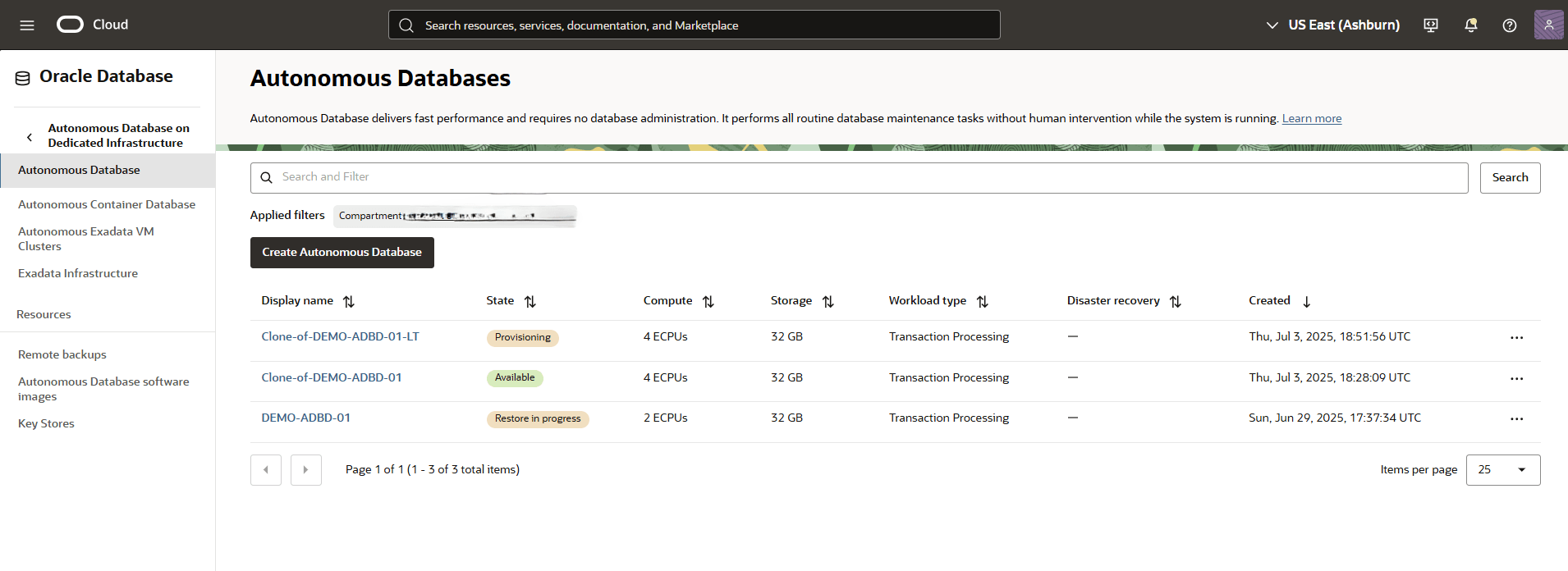

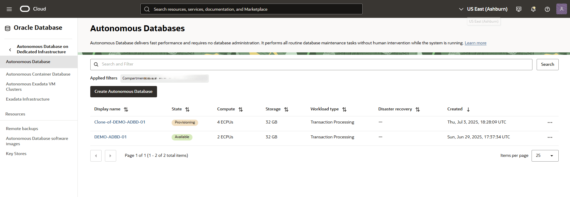

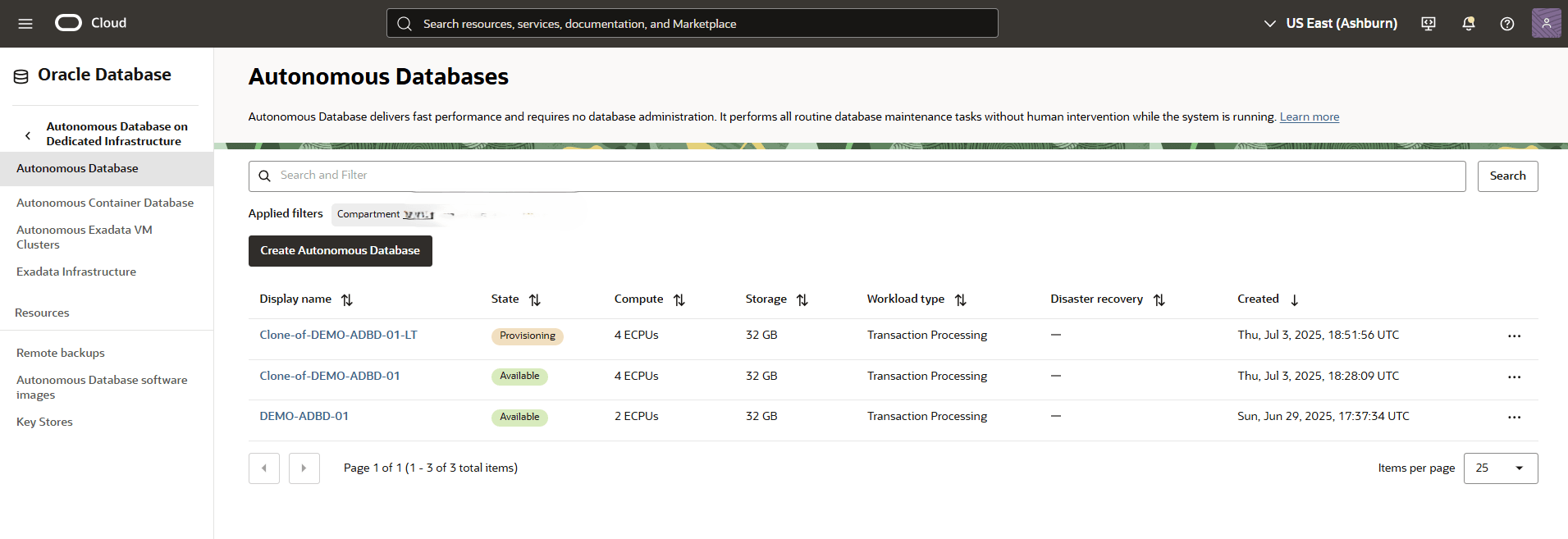

- Return to the Autonomous AI Database to view the State of your clone or restore process. Once the process is complete, the State will change from Available to Restore in Progress.

- Return to the Autonomous AI Database to view the State of your clone process.

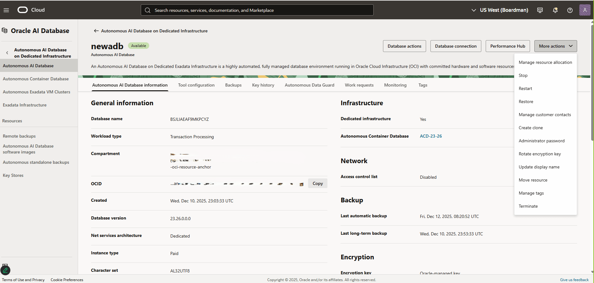

- Select the More actions button, and then select the Restore.

- Return to the Autonomous AI Database to view the State of your restore process.

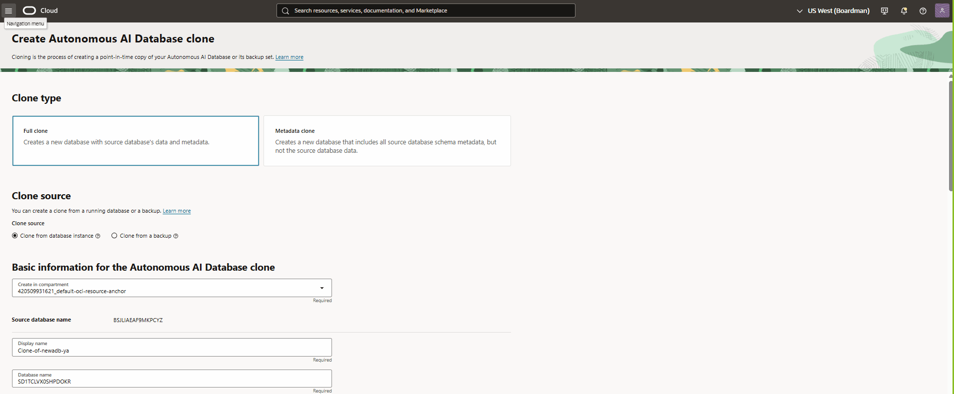

- Select the More actions button, and then select the Create clone option.

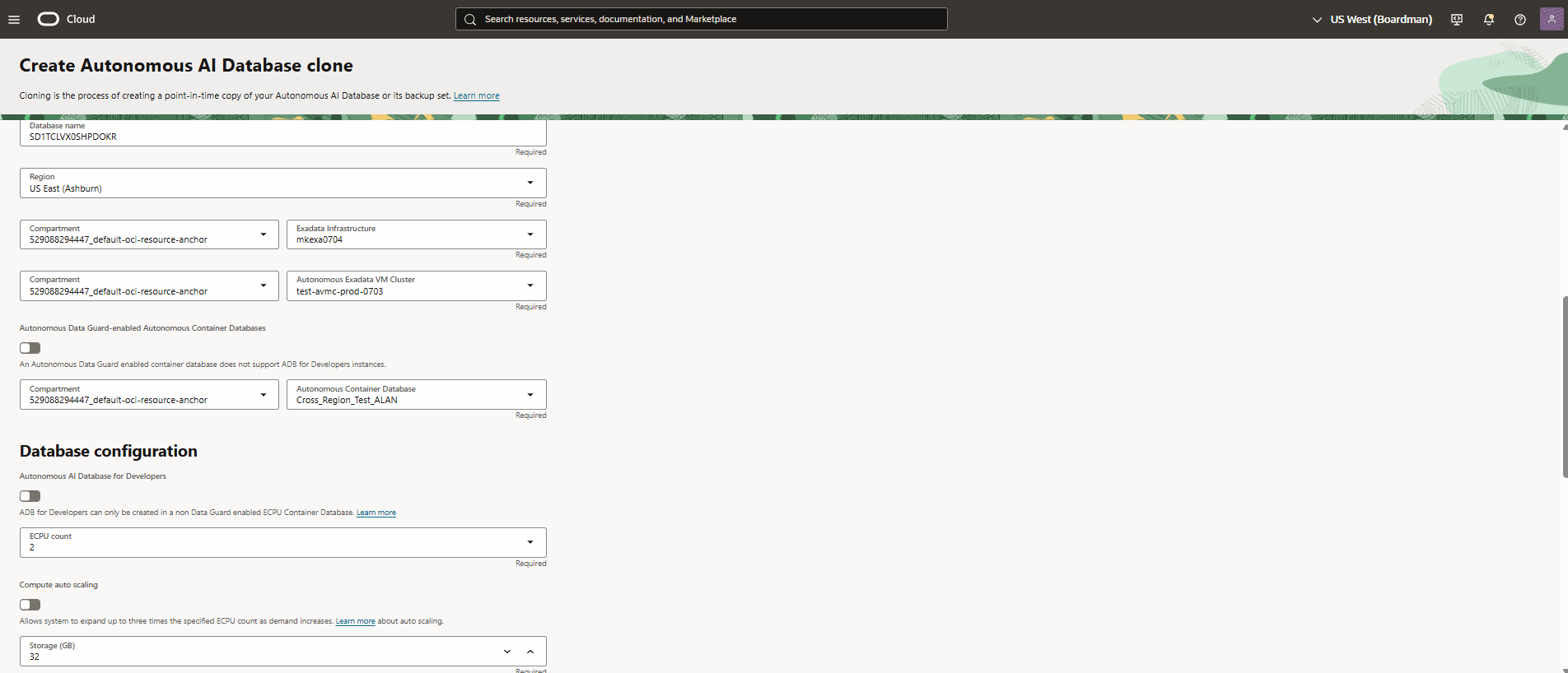

- From the Create Autonomous AI Database clone page. Complete the following substeps:
- Select your Clone type as Full clone.
- Select the Clone from a backup option as your Clone source. Choose a date and time.
- Select your compartment that you want to create the clone in.
- Enter a Display name that helps you easily identify the resource. The display name must be 1 to 255 characters, of letters, numbers, underscores (_) and hyphens (-). Display name must start with a letter or underscore (_) and cannot contain two successive hyphens (-).
- Specify a Database name. The database name must contain only letters and numbers, starting with a letter. It can be up to 30 characters. Spaces are not allowed.
- From the Region list, select the target region where your backup will be restored.
Note
The OCI region Ashburn is mapped to the AWS region N. Virginia. The target Autonomous AI VM Cluster is physically located in N. Virginia. - From the Compartment dropdown list, select your compartment in which your Exadata Infrastructure resides.
- From the Exadata Infrastructure dropdown list, select your Exadata Infrastructure.
- From the Compartment dropdown list, select your compartment in which your Autonomous Exadata VM Cluster resides and then select your target Autonomous Exadata VM Cluster.

- Navigate to the Database configuration section. To enable Autonomous AI Database for Developers, turn on the toggle. This step is optional.
Note
Autonomous AI Database for Developers can only be created in a non Data Guard enabled ECPU Container Database. For more information, see Autonomous AI Database for Developers. - Select the ECPU count from the dropdown list. Only available ECPU values are displayed.
- The Compute auto scaling is optional. This option allows the system to expand up to three times the specified ECPU count as demand increases. For more information, see CPU Allocation When Auto-Scaling.
- Specify the Storage (GB).

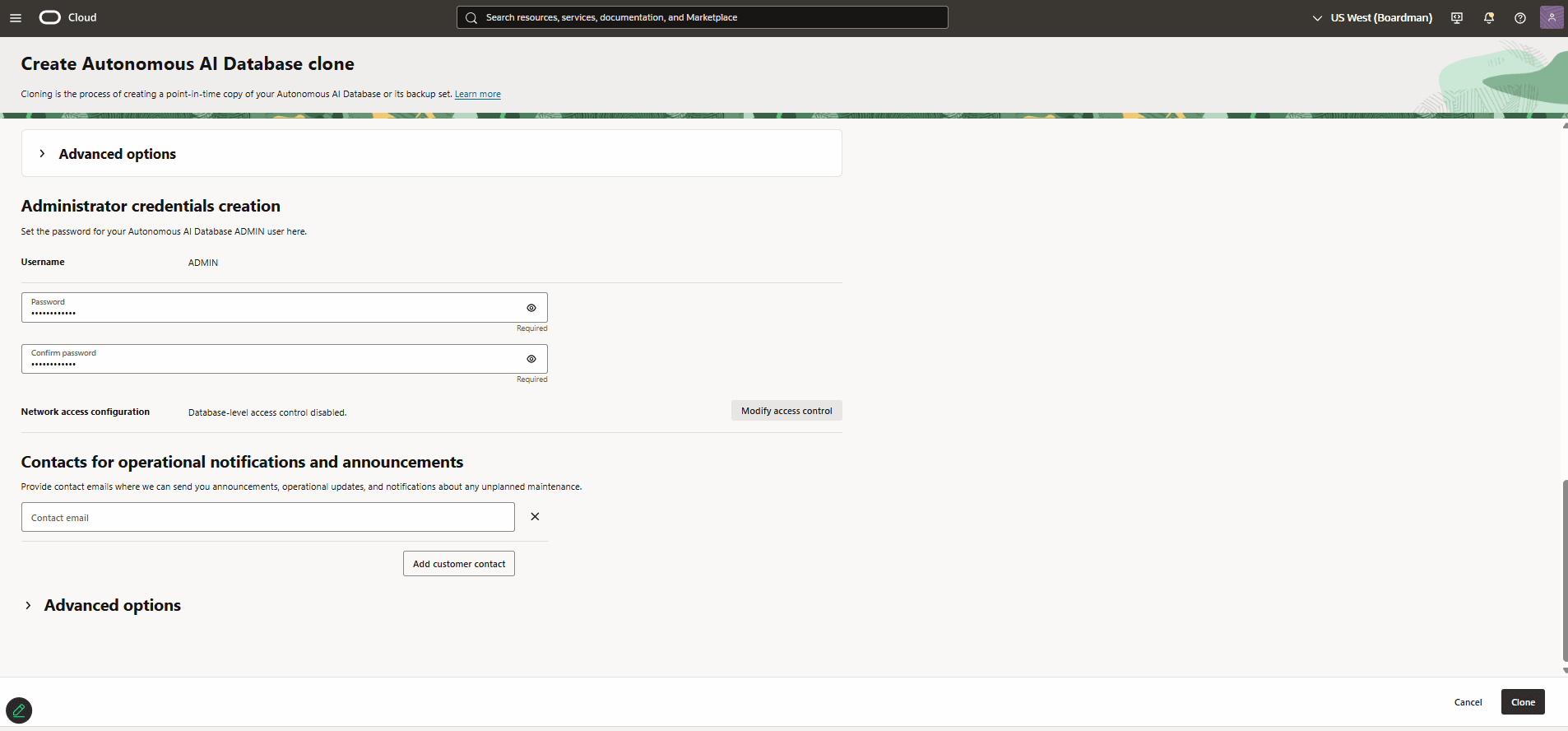

- Navigate to Administrator credentials creation section, and then enter your Password. The password must be 12 to 30 characters and contain at least one uppercase letter, one lowercase letter, and one number. The password cannot contain a single quote (') or a double quote (") character or the user-name "admin".
- Reenter your password in the Confirm password field. The confirm password must match password you entered in the previous step.

- Enter your Contact email for operational notifications and announcements. You can select the Add customer contact, and then enter the required information.
