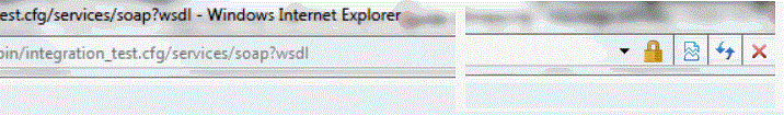

  2. Click the lock icon, as shown in Figure 2-1.
    Figure 2-1 The Lock Icon in the Browser Window for Internet Explorer Browser
    Description of Figure 2-1 follows
    Description of "Figure 2-1 The Lock Icon in the Browser Window for Internet Explorer Browser"

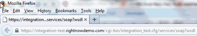

    Figure 2-3 shows the location of the lock icon in the Mozilla Firefox browser.
    Figure 2-3 Location of Lock Icon in Mozilla Firefox Browser Indicated by Arrow
    Description of Figure 2-3 follows
    Description of "Figure 2-3 Location of Lock Icon in Mozilla Firefox Browser Indicated by Arrow"

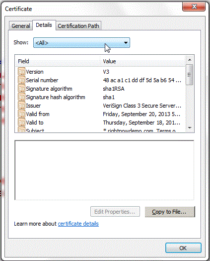

  3. After clicking View Certificates, another window is displayed, providing the details of the certificate. Open the Details tab and click Copy to File, as shown in Figure 2-5.
    Figure 2-5 Certificate Details Pop-up
    Description of Figure 2-5 follows
    Description of "Figure 2-5 Certificate Details Pop-up"

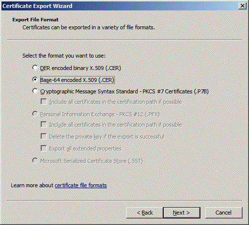

  4. The Windows Certificate export wizard opens. Click Next and select Base-64 encoded X.509 (.CER) option, See Figure 2-6.
    Figure 2-6 The Certificate Wizard, with Base-64 encoded X.509m(.CER) Selected
    Description of Figure 2-6 follows
    Description of "Figure 2-6 The Certificate Wizard, with Base-64 encoded X.509m(.CER) Selected"

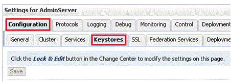

  5. Proceed to the Keystores tab, as shown in Figure 2-7.
    Figure 2-7 The Keystores Tab
    Description of Figure 2-7 follows
    Description of "Figure 2-7 The Keystores Tab"

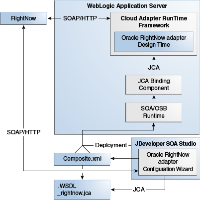

  • The adapter also has a runtime component:
    • You use the runtime part of the adapter for delivering the information generated during design time to the service endpoint. This is where the invocation of the Web Service occurs.
    • Figure 2-9 shows the complete runtime lifecycle and the activities related to performing the Oracle RightNow adapter runtime.
    • Figure 2-9 Oracle RightNow Adapter Runtime
      Description of Figure 2-9 follows
      Description of "Figure 2-9 Oracle RightNow Adapter Runtime"
