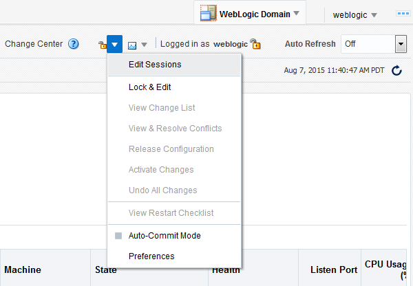

To create an edit session:
  1. From Fusion Middleware Control, click the Changes arrow, and then click Edit Sessions, as shown in the following figure:
  2. From the Edit Sessions dialog, click Create.
  3. From the Create a New Edit Session dialog, enter a name for the session into the Name field, and then click Create.
  4. Select the session you just created and click Switch Edit Session. If prompted, click Switch Edit Session on the dialog that appears.
    The edit session is now active.
  5. To lock the session and edit the configuration, click the Changes arrow, and then click Lock and Edit.
You can now create users and groups, as described in the remaining tasks in this chapter.

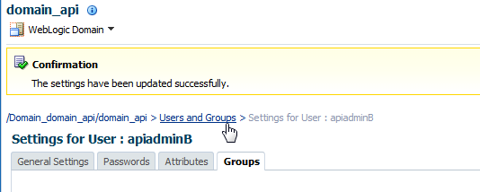

To add API Manager users to groups:
  1. Log in to Fusion Middleware Control as a user with administrator privileges.
  2. In the Target Navigator, expand WebLogic Domain, and right-click the name of your domain. Navigate to Security > Users and Groups to display the Users and Groups page.
  3. Click the Users tab.
  4. In the Users table, click the name of the user you created in Creating API Manager Users.
  5. From the Setting for User page, click the Groups tab.
  6. Select the groups to which you want to add the user and then click the right arrow to add them to the Chosen list. As an example, an API Curator user should be added to the API Curators group.
  7. Click Save , and then click the Users and Groups links, as shown in the following figure, to return to the Users and Groups page.
  8. Repeat steps 4 through 7 for each user you created in Creating API Manager Users.
