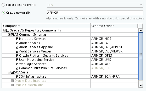

Select Create new prefix, specify a custom prefix, then select the SOA Suite schema. This will automatically select SOA Infrastructure, along with the following schemas as dependencies:
Metadata Services
Audit Services
Audit Services Append
Audit Services Viewer
Oracle Platform Security Services
User Messaging Service
WebLogic Services
A schema called Common Infrastructure Services is also automatically created; this schema is grayed out and cannot be selected or deselected. This schema enables you to retrieve information from RCU during domain configuration. For more information, see "Understanding the Service Table Schema" in Creating Schemas with the Repository Creation Utility.
The custom prefix is used to logically group these schemas together for use in this domain only; you must create a unique set of schemas for each domain as schema sharing across domains is not supported.
Tip:
For more information about custom prefixes, see "Understanding Custom Prefixes" in Creating Schemas with the Repository Creation Utility.
For more information about how to organize your schemas in a multi-domain environment, see "Planning Your Schema Creation" in Creating Schemas with the Repository Creation Utility.
Tip:
You must make a note of the custom prefix you choose to enter here; you will need this later on during the domain creation process.
Click Next to proceed, then click OK on the dialog window confirming that prerequisite checking for schema creation was successful.

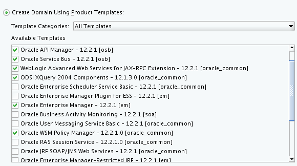

On the Templates screen, make sure Create Domain Using Product Templates is selected, then select the following templates:
Oracle API Manager - 12.2.1. [osb]
Selecting this template also selects the following dependencies:
Basic WebLogic Server Domain - 12.2.1. [wlserver]
Oracle Service Bus - 12.2.1 [osb]
WebLogic Advanced Web Services for JAX-PRC Extension - 12.2.1 [wlserver]
ODSI XQuery 2004 Components - 12.2.1 - [oracle_common]
Oracle Enterprise Manager - 12.2.1 [em]
Oracle WSM Policy Manager - [oracle_common]
Oracle JRF - 12.2.1 [oracle_common]
WebLogic Coherence Cluster Extension - 12.2.1 [wlserver]
Tip:
For more information about the options on this screen, see "Templates" in Creating WebLogic Domains Using the Configuration Wizard.

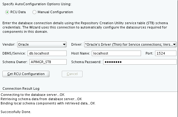

Select RCU Data to activate the fields on this screen. The RCU Data option instructs the Configuration Wizard to connect to the database and Service Table (STB) schema to automatically retrieve schema information for the schemas needed to configure the domain.
If you choose to select Manual Configuration on this screen, you will have to manually fill in the parameters for your schema on the JDBC Component Schema screen.
After selecting RCU Data, fill in the following fields:
| Field | Description |
DBMS/Service |
Enter the database DBMS name, or service name if you selected a service type driver. |
Host Name |
Enter the name of the server hosting the database. |
Port |
Enter the port number on which the database listens. |
Schema Owner Schema Password |
Enter the user name and password for connecting to the database's Service Table schema. This is the schema user name and password that was specified for the Service Table component on the "Schema Passwords" screen in RCU (see Creating the Database Schemas). The default user name is |
Click Get RCU Configuration when you are finished specifying the database connection information. The following output in the Connection Result Log indicates that the operating succeeded:
Connecting to the database server...OK Retrieving schema data from database server...OK Binding local schema components with retrieved data...OK Successfully Done.
Tip:
More information about the RCU Data option can be found in "Understanding the Service Table Schema" in Creating Schemas with the Repository Creation Utility.
More information about the other options on this screen can be found in Datasource Defaults in Creating WebLogic Domains Using the Configuration Wizard

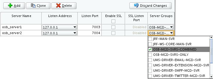

On the Managed Servers screen, a new Managed Server named osb_server1 is created:
These server names will be referenced throughout this document; if you choose different names be sure to replace them as needed.
Tip:
For more information about the options on this screen, see "Managed Servers" in Creating WebLogic Domains Using the Configuration Wizard.

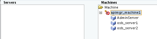

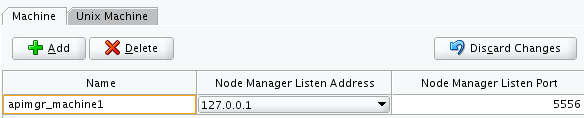

Use the Machines screen to create a new machine in the domain. A machine is required in order for the Node Manager to be able to start and stop the servers.
Tip:
If you plan to create a high availability environment and know the list of machines required for your target topology, you can follow the directions in this section to create all of the machines at this time. For more information, see "Optional Scale Out Procedure" in High Availability Guide.
If you are extending an existing domain, you can assign servers to any existing machine. It is not necessary to create a new machine unless your situation requires it.
Tip:
For more information about the options on this screen, see "Machines" in Creating WebLogic Domains Using the Configuration Wizard.
Use the Assign Servers to Machines screen to assign the Administration Server and Managed Servers to the new machine you just created:
Tip:
For more information about the options on this screen, see "Assign Servers to Machines" in Creating WebLogic Domains Using the Configuration Wizard.

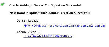

The Configuration Success screen will show the following items about the domain you just configured:
Domain Location
Administration Server URL
You must make a note of both items as you will need them later; the domain location is needed to access the scripts used to start the Administration Server, and the URL is needed to access the Administration Server.
Click Finish to dismiss the configuration wizard.

You can verify that the Administration Server is up and running by accessing the Administration Server Console. The URL is provided on the Configuration Success screen in Writing Down Your Domain Home and Administration Server URL.
Make sure that the database hosting your product schemas is up and running and accessible by the Administration Server.
http://administration_server_host:administration_server_port/console
The default Administration Server port number is 7001.
