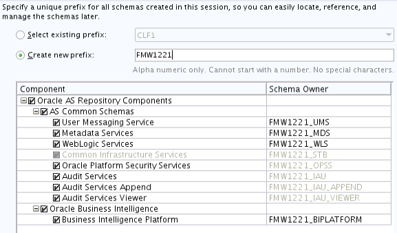

Task 4    Specifying a Custom Prefix and Selecting Schemas
  1. Specify the custom prefix you want to use to identify the Oracle Fusion Middleware schemas.
    The custom prefix is used to logically group these schemas together for use in this domain. For the purposes of this guide, use the prefix FMW1221.
    Tip:
    Make a note of the custom prefix you choose to enter here; you will need this later during the domain creation process.
  2. Select AS Common Schemas.
    When you select AS Common Schemas, all of the schemas in this section are automatically selected.
    A schema called Common Infrastructure Services is also automatically created; this schema is grayed out and cannot be selected or deselected. This schema (the STB schema) enables you to retrieve information from RCU during domain configuration. For more information, see "Understanding the Service Table Schema" in Creating Schemas with the Repository Creation Utility.
  3. Select Business Intelligence Platform.
Tip:
For more information about custom prefixes, see "Understanding Custom Prefixes" in Creating Schemas with the Repository Creation Utility.
For more information about how to organize your schemas in a multi-domain environment, see "Planning Your Schema Creation" in Creating Schemas with the Repository Creation Utility.
Description of GUID-79155536-2749-4F2F-A206-FF44CB0D3770-default.png follows
Description of the illustration GUID-79155536-2749-4F2F-A206-FF44CB0D3770-default.png
Click Next to proceed, then click OK on the dialog window confirming that prerequisite checking for schema creation was successful.

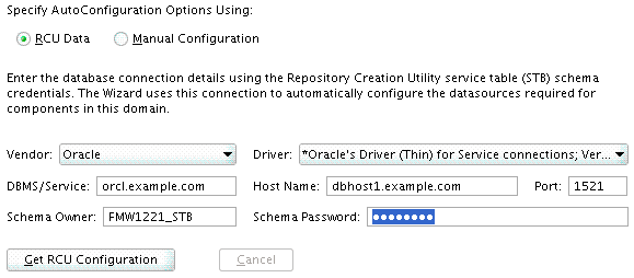

Task 6    Specifying the Database Configuration Type
Select RCU Data to activate the fields on this screen.
The RCU Data option instructs the Configuration Wizard to connect to the database and Service Table (STB) schema to automatically retrieve schema information for the schemas needed to configure the domain.
If you choose to select Manual Configuration on this screen, you will have to manually fill in the parameters for your schema on the JDBC Component Schema screen.
After selecting RCU Data, fill in the fields as shown in the following table. Refer to Figure 10-1 for a partial screen shot of a sample Database Configuration Type screen.
Field Description
DBMS/Service
Enter the service name for the Oracle RAC database where you will install the product schemas. For example:
orcl.example.com
Be sure this is the common service name that is used to identify all the instances in the Oracle RAC database; do not use the host-specific service name.
For more information, see Preparing the Database for an Enterprise Deployment.
Host Name
Enter the Single Client Access Name (SCAN) Address for the Oracle RAC database, which you entered in the Enterprise Deployment Workbook.
Port
Enter the port number on which the database listens. For example, 1521.
Schema Owner
Schema Password
Enter the user name and password for connecting to the database's Service Table schema.
This is the schema user name and password that was specified for the Service Table component on the Schema Passwords screen in RCU.
The default user name is prefix_STB, where prefix is the custom prefix that you defined in RCU.
Figure 10-1 Setting the Database Configuration Type for an Enterprise Deployment
Description of Figure 10-1 follows
Description of "Figure 10-1 Setting the Database Configuration Type for an Enterprise Deployment"
Click Get RCU Configuration when you are finished specifying the database connection information. The following output in the Connection Result Log indicates that the operation succeeded:
Connecting to the database server...OK
Retrieving schema data from database server...OK
Binding local schema components with retrieved data...OK
Successfully Done.
Click Next if the connection to the database is successful.

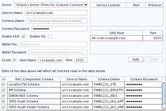

Task 8    Providing the GridLink Oracle RAC Database Connection Details
On the GridLink Oracle RAC Component Schema screen, provide the information required to connect to the RAC database and component schemas, as shown in Table 10-3 and in Figure 10-2 .
Table 10-3 Recommended Values for Selected Fields on the GridLink Oracle RAC Component Schema Screen
Element Description and Recommended Value
SCAN, Host Name, and Port
Select the SCAN check box.
In the Host Name field, enter the Single Client Access Name (SCAN) Address for the Oracle RAC database.
In the Port field, enter the SCAN listening port for the database (for example, 1521)
ONS Host and Port
In the ONS Port field, enter the SCAN address for the Oracle RAC database.
In the Port field, enter the ONS Remote port (typically, 6200).
Enable Fan
Select the Enable Fan check box to receive and process FAN events,
Figure 10-2 Sample Values for the GridLink Oracle RAC Component Schema Screen
Description of Figure 10-2 follows
Description of "Figure 10-2 Sample Values for the GridLink Oracle RAC Component Schema Screen"
For more information about specifying the information on this screen, as well as information about how to identify the correct SCAN address, see "Configuring Active GridLink Data Sources with Oracle RAC" in the High Availability Guide.
You can also click Help to display a brief description of each field on the screen.

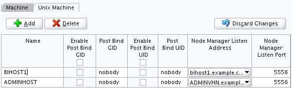

Task 18    Creating Machines
Use the Machines screen to create a new machine in the domain. A machine is required in order for the Node Manager to be able to start and stop the servers.
  1. Select the Unix Machine tab.
  2. Click the Add button to create the new UNIX machine.
    Use the values in the following table to define the Name and Node Manager Listen Address of each machine.
  3. Verify the port in the Node Manager Listen Port field.
    The port number 5556, shown in this example, may be referenced by other examples in the documentation. Replace this port number with your own port number as needed.
Table 10-5 Values to Use When Creating Unix Machines
Name Node Manager Listen Address Node Manager Listen Port
BIHOST1
The value of the BIHOST1 host name variable. For example, BIHOST1.example.com.
5556
ADMINHOST
Enter the value of the ADMINVHN variable.
5556
Figure 10-3 Example Values for the Configuration Wizard Unix Machines Screen
Description of Figure 10-3 follows
Description of "Figure 10-3 Example Values for the Configuration Wizard Unix Machines Screen"

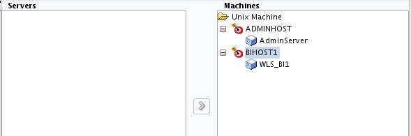

Task 19    Assigning Servers to Machines
Use the Assign Servers to Machines screen to assign the Administration Server and the Oracle BI EE Suite Managed Server to the appropriate machine.
The Assign Servers to Machines screen is similar to the Assign Managed Servers to Clusters screen. Select the target machine in the Machines column, select the Managed Server in the left column, and click the right arrow to assign the server to the appropriate machine.
Assign the servers as follows:
  • Assign the AdminServer to the ADMINHOST machine.
  • Assign the WLS_BI1 Managed Server to the BIHOST1 machine.

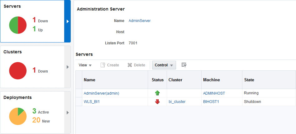

10.11.4 Validating the Administration Server
Before proceeding with the configuration steps, validate that the Administration Server has started successfully by making sure you have access to the Oracle WebLogic Server Administration Console and Oracle Enterprise Manager Fusion Middleware Control, which both are installed and configured on the Administration Serverls.
To navigate to Fusion Middleware Control, enter the following URL, and log in with the Oracle WebLogic Server administrator credentials:
ADMINVHN:7001/em
To navigate to the Oracle WebLogic Server Administration Console, enter the following URL, and log in with the same administration credentials:
ADMINVHN:7001/console

10.11.8 Starting the WLS_BI1 Managed Server on BIHOST1
Use Oracle Enterprise Manager Fusion Middleware Control to start the Managed Server on BIHOST1.
Fusion Middleware Control is available because you already started the Node Manager and Administration Server in a previous step:
  1. Enter the following URL into a browser to display the Fusion Middleware Control login screen:
    http://ADMINVHN:7001/em
    In this example:
    • Replace ADMINVHN with the host name assigned to the ADMINVHN Virtual IP address.
    • Port 7001 is the typical port used for the Administration Server console and Fusion Middleware Control. However, you should use the actual URL that was displayed at the end of the Configuration Wizard session when you created the domain.
      Tip:
      For more information about managing Oracle Fusion Middleware using Oracle Enterprise Manager Fusion Middleware Control, see "Getting Started Using Oracle Enterprise Manager Fusion Middleware Control" in Administering Oracle Fusion Middleware.
  2. Log in to Fusion Middleware Control using the Administration Server credentials.
  3. Select the Servers pane to view the Managed Servers in the domain.
  4. Select only the WLS_BI1 Managed Server and click Control on the tool bar. Then, under Control, select Start.
