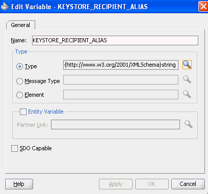

  3. Go to the Structure window. While this example describes variable creation from the Structure window, you can also create variables by clicking the Add icons to the right of the Input and Output fields of the Invoke dialog.
  4. Right-click Variables and select Expand All Child Nodes.
  5. In the second Variables folder in the tree, right-click and select Create Variable.
    The Create Variable dialog appears.
  6. Enter the variable name and select Message Type from the options provided:
    • Type
      This option lets you select an XML schema simple type (for example, string, boolean, and so on).
    • Message Type
      This option enables you to select a WSDL message file definition of a partner link or of the project WSDL file of the current BPEL process service component (for example, a response message or a request message). You can specify variables associated with message types as input or output variables for invoke, receive, or reply activities.
      To display the message type, select the Message Type option, and then select its Browse icon to display the Type Chooser dialog. From here, expand the Message Types tree to make your selection. For this example, LoanServiceRequestMessage is selected.
    • Element
      This option lets you select an XML schema element of the project schema file or project WSDL file of the current BPEL process service component, or of a partner link.
  7. Click OK.

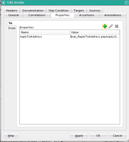

  2. On the invoke activity (for the callback), click the Properties tab.
  3. Click the Add icon to select the property and its content (either a variable or an XPath expression).
    In BPEL 1.1 processes, the properties are automatically displayed in the Properties column. Select the property in the Name column and double-click the Value and Type columns to enter appropriate values.
  4. In the Name column, scroll down and select the replyToAddress property. Do not select wsa.replyToAddress or bpel.replyToAddress.
  5. In the Value column, specify the variable name as the value (for this example, var_replyToAddress from Step 1 is entered), and click OK.
    The Edit Invoke dialog appears as shown in Figure 8-1.
    Figure 8-1 Properties Tab of Invoke Activity
    Description of Figure 8-1 follows
    Description of "Figure 8-1 Properties Tab of Invoke Activity"
  6. Click Apply, then OK.

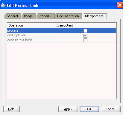

  1. In Oracle BPEL Designer, double-click the partner link that includes the operations for which to manage idempotence.
  2. Click the Idempotence tab of the partner link.
    By default, all operations are selected to be idempotent in the Idempotent column.
  3. If you want to define an operation to be nonidempotent, deselect the Idempotent check box for that operation. Figure 8-2 provides details.
    Figure 8-2 Idempotence Tab of Partner Link Activity
    Description of Figure 8-2 follows
    Description of "Figure 8-2 Idempotence Tab of Partner Link Activity"
  4. Click Apply.
  5. Click OK.

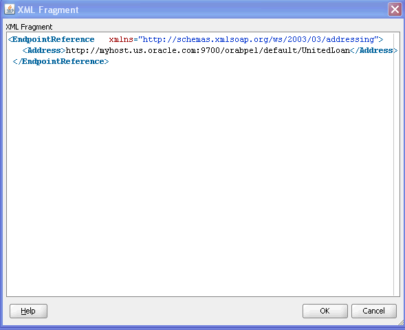

    The XML Fragment dialog for BPEL 1.1 appears. If you are using BPEL 2.0, the Literal dialog appears.
  8. Assign an XML fragment containing the endpoint reference to the partner link, and click OK. Figure 8-4 provides details.
    Figure 8-4 XML Fragment Dialog in BPEL 1.1
    Description of Figure 8-4 follows
    Description of "Figure 8-4 XML Fragment Dialog in BPEL 1.1"
    When complete, the BPEL file contains one of the services defined in the WSDL.
    The following provides a BPEL 1.1 sample:
    <EndpointReference xmlns="http://schemas.xmlsoap.org/ws/2003/03/addressing">
             <Address>http://host:port/soa-infra/services/domain_name
               /AlliedLoan/client</Address>
    <ServiceName xmlns:ns1="http://services.otn.com"
       PortName="LoanServicePort">ns1:AlliedLoan</ServiceName>
    </EndpointReference>

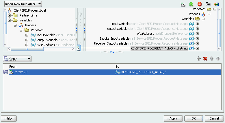

  1. Define a variable of type string (for example, KEYSTORE_RECIPIENT_ALIAS). Figure 8-5 provides details.
    Figure 8-5 Variable Definition of KEYSTORE_RECIPIENT_ALIAS
    Description of Figure 8-5 follows
    Description of "Figure 8-5 Variable Definition of KEYSTORE_RECIPIENT_ALIAS"
  2. In the Copy Rules tab of an assign activity, assign orakey to the variable KEYSTORE_RECIPIENT_ALIAS. Figure 8-6 provides details.
    Figure 8-6 Assignment of orakey to KEYSTORE_RECIPIENT_ALIAS
    Description of Figure 8-6 follows
    Description of "Figure 8-6 Assignment of orakey to KEYSTORE_RECIPIENT_ALIAS"

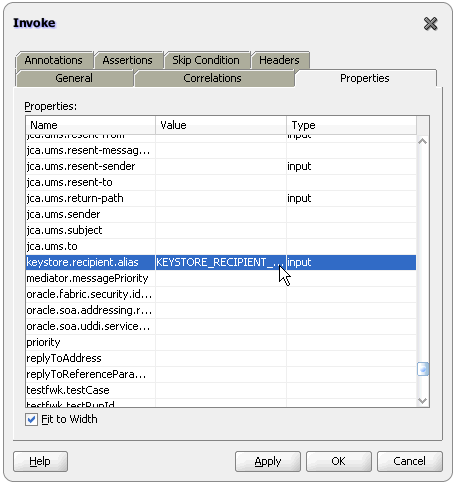

  3. In the invoke activity that invokes the partner link for the web service, click the Properties tab.
  4. Click the keystore.recipient.alias property.
    In BPEL 2.0 processes, the properties are not automatically displayed in the Properties column. You must click the Add icon to select the property and its content (either a variable or an XPath expression).
  5. Double-click the Value column to display the Browse (...) icon.
  6. Click the Browse (...) icon to display the Adapter Property Value dialog.
  7. Click the Browse icon to display the Variable XPath Builder dialog.
  8. Select keystore_recipient_alias as the value, and click OK. Figure 8-7 provides details. This property overrides the security certificates set in the WSDL file while invoking a web service in a BPEL process.
    In BPEL 2.0, there are only Name and Value columns in the Properties table. The Type column is not included.
    Figure 8-7 keystore.recipient.alias Normalized Message Property of Invoke Activity
    Description of Figure 8-7 follows
    Description of "Figure 8-7 keystore.recipient.alias Normalized Message Property of Invoke Activity "
  9. Click Apply, then OK.

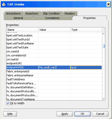

8.7 Overriding WSDL Files of Dynamic Partner Links
You may need to override the default WSDL file used by dynamic partner links for the following reasons:
  • You must integrate with services that use message protection security policies.
  • The WSDL may contain important information such as the certificate used for message encryption.
The normalized message property endpointWSDL enables you to specify the WSDL file of the dynamic partner link. You must specify the entire WSDL dynamically instead of just the endpoint. This enables it to be passed to Oracle Web Services Manager (OWSM), which can then retrieve the correct service certificate from the specified WSDL.

To override WSDL files of dynamic partner links:
  1. Define a variable of type string (for this example, the_wsdl_var is defined).
  2. In the Copy Rules tab of an assign activity, assign the WSDL to the_wsdl_var.
  3. In the invoke activity that invokes the partner link, click the Properties tab.
  4. Click the endpointWSDL property.
  8. Select the_wsdl_var as the variable, and click OK. This value specifies the WSDL of the dynamic partner link.
    Figure 8-8 endpointWSDL Normalized Message Property of Invoke Activity
    Description of Figure 8-8 follows
    Description of "Figure 8-8 endpointWSDL Normalized Message Property of Invoke Activity"
    When complete, the BPEL file is defined as follows:
