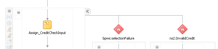

Fault handlers define how the BPEL process service component responds when target services return data other than what is normally expected (for example, returning an error message instead of a number). An example of a fault handler is where the web service normally returns a credit rating number, but instead returns a negative credit message.

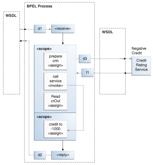

Figure 12-1 provides an example of how a fault handler sets a credit rating variable to -1000.
The code segment in the following example defines the fault handler for this operation in the BPEL file:
<faultHandlers>
<catch faultName="services:NegativeCredit" faultVariable="crError">
<assign name="crin">
<copy>
<from expression="-1000">
</from>
<to variable="input" part="payload"
query="/autoloan:loanApplication/autoloan:creditRating"/>
</copy>
</assign>
</catch>
</faultHandlers>

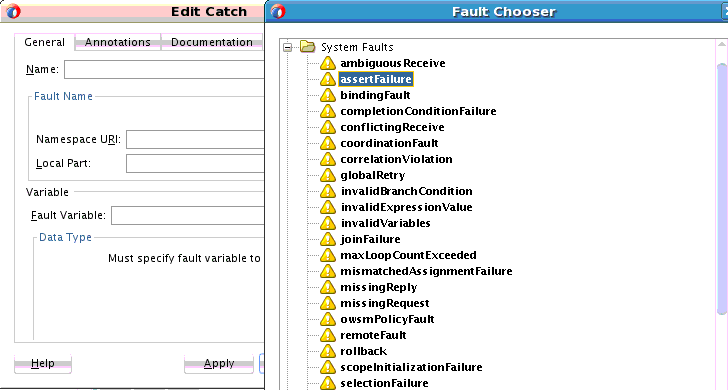

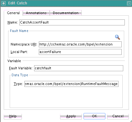

The faultHandlers tag contains the fault handling code. Within the fault handler is a catch activity, which defines the fault name and variable, and the copy instruction that sets the creditRating variable to -1000.
When you select web services for the BPEL process service component, determine the possible faults that may be returned and set up a fault handler for each one.
This section identifies the standard faults for BPEL 1.1 and BPEL 2.0.

Business faults are application-specific faults that are generated when there is a problem with the information being processed (for example, when a social security number is not found in the database). A business fault occurs when an application executes a throw activity or when an invoke activity receives a fault as a response. The fault name of a business fault is specified by the BPEL process service component. The messageType, if applicable, is defined in the WSDL file. A business fault can be caught with a faultHandler using the faultName and a faultVariable.
<catch faultName="ns1:faultName" faultVariable="varName">
Runtime faults are the result of problems within the running of the BPEL process service component or web service (for example, data cannot be copied properly because the variable name is incorrect). These faults are not user-defined, and are thrown by the system. They are generated for a variety of reasons, including the following:
The process tries to use a value incorrectly.
A logic error occurs (such as an endless loop).
A Simple Object Access Protocol (SOAP) fault occurs in a SOAP call.
An exception is thrown by the server.
Several runtime faults are automatically provided. These faults are included in the http://schemas.oracle.com/bpel/extension namespace. These faults are associated with the messageType RuntimeFaultMessage. The WSDL file shown in the following example defines the messageType:
<?xml version="1.0" encoding="UTF-8" ?> <definitions name="RuntimeFault" targetNamespace="http://schemas.oracle.com/bpel/extension" xmlns:xsd="http://www.w3.org/2001/XMLSchema" xmlns="http://schemas.xmlsoap.org/wsdl/"> <message name="RuntimeFaultMessage"> <part name="code" type="xsd:string" /> <part name="summary" type="xsd:string" /> <part name="detail" type="xsd:string" /> </message> </definitions>
If a faultVariable (of messageType RuntimeFaultMessage) is used when catching the fault, the fault code can be queried from the faultVariable, along with the fault summary and detail.

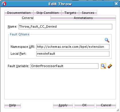

A bindingFault is thrown inside an activity if the preparation of the invocation fails. For example, the WSDL of the process fails to load. A bindingFault is not retriable. This type of fault usually must be fixed by human intervention.
A remoteFault is also thrown inside an activity. It is thrown because the invocation fails. For example, a SOAP fault is returned by the remote service.

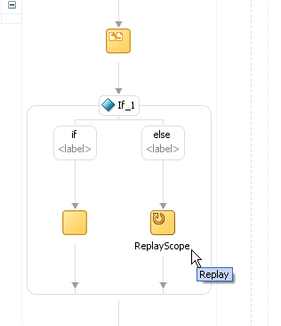

A replayFault replays the activity inside a scope. At any point inside a scope, this fault is migrated up to the scope. These faults are not populated into a common fault, but are an indication to BPEL to re-execute the scope. The server then re-executes the scope from the beginning.

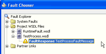

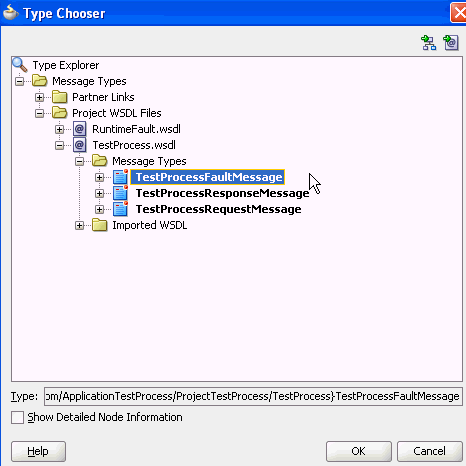

Modify the existing schema and WSDL files to include fault element, fault message, and fault operation details.

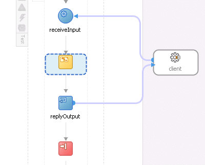

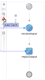

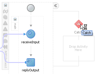

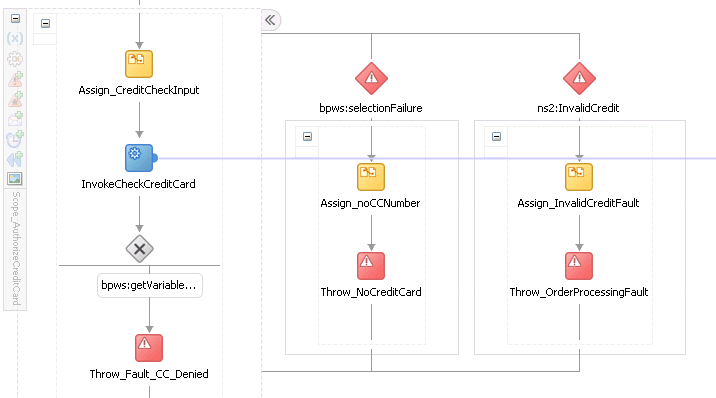

Add fault handling to the BPEL process (specifically, a catch activity).

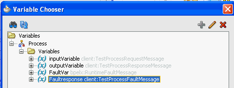

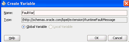

Create a fault variable with the fault message type you specified in the WSDL file.

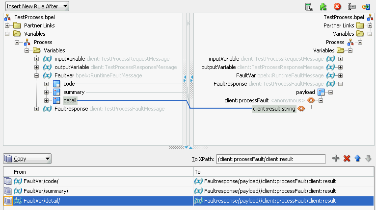

Add assign and reply activities with additional fault handling details.
To add an assign activity to the catch activity branch:

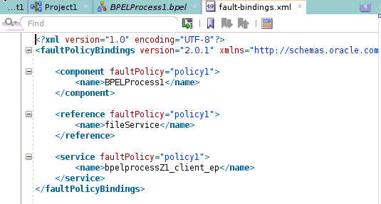

The fault policy file (fault-policies.xml) and fault policy bindings file (fault-bindings.xml) are placed in either of the following locations:
In the same directory as the composite.xml file of the SOA composite application.
In a different location that is specified with two properties that you add to the composite.xml file. This option is useful if a fault policy must be used by multiple SOA composite applications. This option overrides any fault policy files that are included in the same directory as the composite.xml file. The following example provides details about these two properties. In this example, the fault policy files are placed into the SOA part of the Oracle Metadata Services (MDS) Repository shared area.
<property name="oracle.composite.faultPolicyFile">oramds:/apps/faultpolicyfiles/ fault-policies.xml </property> <property name="oracle.composite.faultBindingFile">oramds:/apps/faultpolicyfiles/ fault-bindings.xml </property>

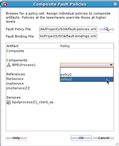

A fault policy bindings file associates the policies defined in a fault policy file with the SOA composite application or the component (service component or reference binding component). The framework attempts to identify a fault policy binding in the following order:
Reference binding component defined in the composite.xml file.
BPEL process or Oracle Mediator service component defined in the composite.xml file.
SOA composite application defined in the composite.xml file.
During the resolution process, if no action is found that matches the condition, the framework assumes that resolution failed and moves to the next resolution level.
For example, assume an invoke activity faults with faultname="abc". There is a policy binding specified in the fault-bindings.xml file:
SOA composite application binds to policy-id-1
BPEL process or Oracle Mediator service component or reference binding component binds to policy-id-2
In the fault-bindings.xml file, the following bindings are also specified:
SOA composite application binds to policy-id-3
Reference binding component or service component binds to policy-id-4
The fault management framework behaves as follows:
First match the resolve binding (in this case, policy-id-4).
If the fault resolution fails, go to the next possible match (policy-id-2).
If the fault resolution fails, go to the next possible match (policy-id-3).
If the fault resolution fails, go to the next possible match (in this case, policy-id-1).
If the fault resolution still fails, the fault is sent to the BPEL fault catch activity.
You can design a fault policy with the Fault Policy wizard and associate the fault policy with the fault policy binding file.

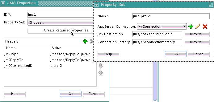

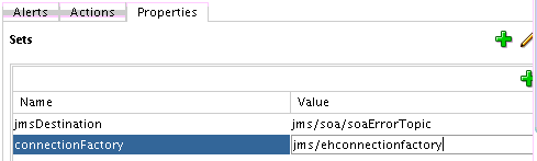

You first define property sets to associate with JMS alerts, which are defined in Step 2: Defining Alerts. You can associate property sets configuration details such as JMS destinations and connection factories with multiple JMS alerts. For example, for a JMS alert, the destination and queue information and connection factory can be referenced by additional JMS alerts configured in the fault policy.
You cannot create property sets for email alerts in this release.
Click the Properties tab. Table 12-1 provides details about available fields.
Table 12-1 Property Set Selections
| For... | Then... |
Email alerts |
Email alerts do not support property sets for this release. |
JMS queue alerts |
Figure 12-12 shows a property set configured with JMS destination and connection factory values.
Figure 12-12 JMS Property Set Configuration
For an example of a fully-defined fault policy file, including a defined JMS propertySet section, see Step 4 of How to Manually Design a Fault Policy for Automated Fault Recovery.

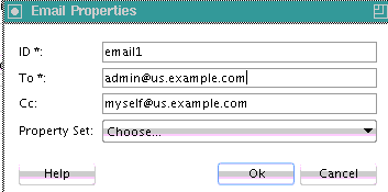

Click the Alerts tab. Two types of notification alerts are supported:
Email: Enables you to configure email recipients to receive alerts when a fault occurs. You must also configure the same email recipients on the Mailer tab of the Workflow Notification Properties page in Oracle Enterprise Manager Fusion Middleware Control. For information, see Section "Configuring Human Workflow Notification Properties" of Administering Oracle SOA Suite and Oracle Business Process Management Suite.
JMS: Enables you to enqueue the fault to a JMS queue or publish it to a JMS topic. JMS header values can also be specified. The JMS notification can be integrated with a third-party resolution system to handle faults. The third-party resolution system dequeue and subscribes to the targeted queue and topic. Further fine-graining is achieved by consuming messages based on the header property values. The payload type of the JMS message is a text message in XML format. You must also configure JMS queues and topics and connection factories in Oracle WebLogic Server Administration Console. For information, see Section "Configuring Basic JMS System Resources" of Administering JMS Resources for Oracle WebLogic Server.

You can specify recipients to receive an email alert when a fault occurs.

You can specify queues to receive a JMS alert when a fault occurs. Two properties are required for configuring a JMS alert.
Figure 12-13 shows email alert configuration in the Email Properties dialog.
Figure 12-14 shows JMS alert configuration in the JMS Properties dialog. For this example, both property sets (defined by clicking Create Required Properties to invoke the Property Set dialog) and headers are defined.

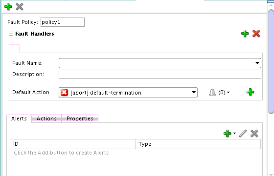

Define the fault name, description, and default action of the fault policy in the upper section of the Fault Policy Editor. Table 12-4 provides details.
Table 12-4 Fault Policy Editor - Upper Section
| Element | Description |
Add Fault Policy icon (upper left corner) |
You can also add additional fault policies for configuration to a single policy document. Click the Add icon in the upper left corner to add an additional fault policy. All polices are then displayed in the column on the far left of the Fault Policy Editor. You can click the policy that you want to define. |
Delete Fault Policy |
Delete a selected fault policy. |
Fault Policy |
Enter a name for the fault policy or accept the default name of |
Add Fault icon (upper right corner) |
Click to add a fault. |

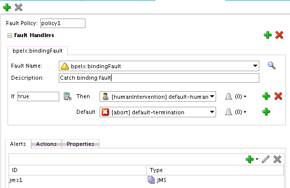

Fault Name |
Select a standard type of fault to catch. This list shows the system faults (binding, Oracle Mediator, or remote) or service (business) fault that you can select. |
Description |
Enter an optional description. The description is persisted into the audit trail during runtime. |
Default Action |

When complete, the Fault Policy Editor looks as shown in Figure 12-16.
Figure 12-16 Fault Policy Editor With Fault Name, Description, and Default Actions Defined

<Alert id="ora-jms">
<JMS propertySet="jms-props">
<Headers>
<property name="correlationId">myvalue</property>
<property name="correlationId1">myvalue1</property>
</Headers>
</JMS>
</Alert>

<Properties>
<propertySet name="jms-props">
<property name="jmsDestination">MyQueue</property>
<property
name="connectionFactory">jms/fabric/ehconnectionfactory</property>
</propertySet>
</Properties>

The following example shows the fault-bindings.xml file that associates the fault policies defined in fault-policies.xml.
<?xml version="1.0" encoding="UTF-8"?>
<faultPolicyBindings version="2.0.1"
xmlns="http://schemas.oracle.com/bpel/faultpolicy"
xmlns:xsi="http://www.w3.org/2001/XMLSchema-instance">
<composite faultPolicy="ConnectionFaults"/>
<component faultPolicy="ServiceFaults">
<name>Component1</name>
<name>Component2</name>
</component>
<!-- Below listed component names use polic CRM_SeriveFaults -->
<component faultPolicy="CRM_ServiceFaults">
<name>HelloWorld</name>
<name>ShippingComponent</name>
<name>AnotherComponent"</name>
</component>
<!-- Below listed reference names and port types use polic CRM_ServiceFaults
<reference faultPolicy="CRM_ServiceFaults">
<name>creditRatingService</name>
<name>anotherReference</name>
<portType
xmlns:credit="http://services.otn.com">credit:CreditRatingService</portType>
<portType
xmlns:db="http://xmlns.oracle.com/pcbpel/adapter/db/insert/">db:insert_
plt</portType>
</reference>
<reference faultPolicy="test1">
<name>CreditRating3</name>
</reference>
</faultPolicyBindings>

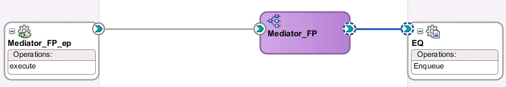

In the fault policy file for the EQ reference binding component for the outbound direction, you specify the actions shown in the following code:
<retryCount>3</retryCount> <retryInterval>3</retryInterval>
If an outbound failure occurs, the expected behavior is for the JCA retries to occur within the fault policy retries. When the first retry of the fault policy is executed, the JCA retry is called. In this example, a JCA retry of 2 with an interval of 2 seconds and exponential back off of 2 is executed for every retry of the fault policy:
Fault policy retry 1:
JCA retry 1 (with 2 seconds interval)
JCA retry 2 (with 4 seconds interval)
Fault policy retry 2:
Fault policy retry 3:

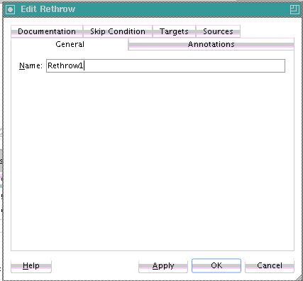

The rethrow activity rethrows faults originally captured by the immediately enclosing fault handler. Only use the rethrow activity within a fault handler (for example, within catch and catchAll activities). The rethrow activity is used in fault handlers to rethrow the captured fault (that is, the fault name and the fault data (if present) of the original fault). The rethrow activity must ignore modifications to fault data. For example:
If the fault handler modifies fault data and then calls a rethrow activity, the original fault data is rethrown, and not the modified fault data.
If a fault is captured using the functionality that enables message type faults with one part defined using an element to be caught by fault handlers looking for the same element type, then the rethrow activity rethrows the original message type data.
This activity is supported in BPEL version 2.0 projects.
The following example shows the .bpel file after design is complete for a rethrow activity. The rethrow activity is inside a fault handler (catch activity).

A BPEL process service component can send a fault to another application to indicate a problem, as opposed to throwing an internal fault. In a synchronous operation, the reply activity can return the fault. In an asynchronous operation, the invoke activity performs this function.
The syntax of a reply activity that returns a fault in a synchronous interaction is shown in the following example:
<reply partnerlinke="partner-link-name"
portType="port-type-name"
operation="operation-name"
variable="variable-name" (optional)
faultName="fault-name">
</reply>
Always returning a fault in response to a synchronous request is not very useful. It is better to make the activity part of a conditional branch, in which the first branch is executed if the data requested is available. If the requested data is not available, then the BPEL process service component returns a fault with this information.

The following example shows the scope activity in the .bpel file after design completion. The Scope_AuthorizeCreditCard scope activity consists of activities that perform the following actions:

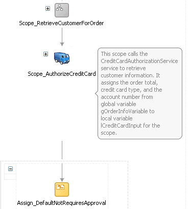

A catch activity for catching faulted orders in which the credit card number is not provided or the credit type is not valid.
A throw activity that throws a fault for orders that are not approved.
An assign activity that takes the credit card type, credit card number, and purchase amount, and assigns this information to the input variable for the CreditCardAuthorizationService service.
An invoke activity that calls a CreditCardAuthorizationService service to retrieve customer information.
A switch activity that checks the results of the credit card validation.
<scope name="Scope_AuthorizeCreditCard">
<variables>
<variable name="lCreditCardInput"
messageType="ns2:CreditAuthorizationRequestMessage"/>
<variable name="lCreditCardOutput"
messageType="ns2:CreditAuthorizationResponseMessage"/>
</variables>
<faultHandlers>
<catch faultName="bpws:selectionFailure">
<sequence>
<assign name="Assign_noCCNumber">
<copy>
<from expression="string('CreditCardCheck - NO
CreditCard')"/>
<to variable="gOrderProcessorFaultVariable"
part="code"/>
</copy>
</assign>
<throw name ="Throw_NoCreditCard"
faultVariable="gOrderProcessorFaultVariable"
faultName="ns9:OrderProcessingFault"/>
</sequence>
</catch>
<catch faultName="ns2:InvalidCredit">
<sequence>
<assign name="Assign_InvalidCreditFault">
<copy>
<from expression="concat(bpws:getVariableData
('gOrderInfoVariable','/ns4:orderInfoVOSDO/
ns4:CardTypeCode'), ' is not a valid
creditcard type')"/>
part="summary"/>
</copy>
<copy>
<from expression="string('CreditCardCheck - NOT VALID')"/>
part="code"/>
</copy>
</assign>
<throw name="Throw_OrderProcessingFault"
faultVariable="gOrderProcessorFaultVariable"/>
</sequence>
</catch>
</faultHandlers>
<sequence>
<assign name="Assign_CreditCheckInput">
<copy>
<from variable="gOrderInfoVariable"
query="/ns4:orderInfoVOSDO/ns4:OrderTotal"/>
<to variable="lCreditCardInput" part="Authorization"
query="/ns8:AuthInformation/ns8:PurchaseAmount"/>
</copy>
<copy>
query="/ns4:orderInfoVOSDO/ns4:CardTypeCode"/>
query="/ns8:AuthInformation/ns8:CCType"/>
</copy>
<copy>
query="/ns4:orderInfoVOSDO/ns4:AccountNumber"/>
query="/ns8:AuthInformation/ns8:CCNumber"/>
</copy>
</assign>
<invoke name="InvokeCheckCreditCard"
inputVariable="lCreditCardInput"
outputVariable="lCreditCardOutput"
partnerLink="CreditCardAuthorizationService"
portType="ns2:CreditAuthorizationPort"
operation="AuthorizeCredit"/>
<switch name="Switch_EvaluateCCResult">
<case condition="bpws:getVariableData('lCreditCardOutput','status','
/ns8:status') != 'APPROVED'">
<bpelx:annotation>
<bpelx:pattern>status <> approved</bpelx:pattern>
</bpelx:annotation>
<throw name="Throw_Fault_CC_Denied"
faultName="client:OrderProcessorFault"/>
</case>
/switch>
</sequence>
</scope>

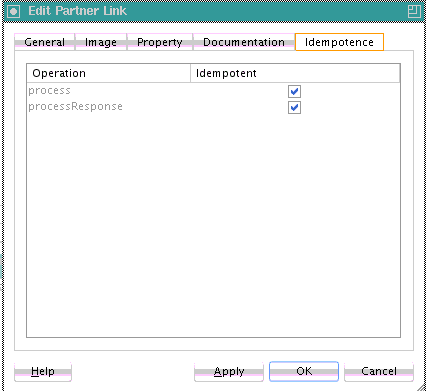

If the idempotent deployment descriptor property is set to false in the composite.xml file and the invocation of a partner link fails, recovery does not start from the invoke activity. Relying on the idempotent property for retrying the invoke activity is not recommended. Instead, recovery is attempted by fault handling you have designed into the BPEL process (such as with a catchAll activity). As a best practice, Oracle recommends that you instead use a fault policy to retry the invoke activity.
Table 12-8 describes the behavior when the idempotent property is set to false and partner link invocation either succeeds or fails.
Table 12-8 Recovery Behavior When the idempotent Property Is Set to False
| If Partner Link Invocation Is... | Then... |
Successful |
The invoke activity is dehydrated immediately after execution and recorded in the dehydration store. |
Unsuccessful, and your BPEL process includes fault handling, such as a catchAll activity |
Recovery is started from the catchAll activity and not from the invoke activity. |
Unsuccessful, and your BPEL process includes a fault policy |
The fault policy is used to attempt recovery of the invoke activity. This is the recommended approach. |
For example, assume your BPEL process includes the following design:
An invoke activity invokes a partner link (for this example, named myPartnerLink).
The idempotent deployment descriptor property is set to false in the composite.xml file.
<property name="bpel.partnerLink.myPartnerLink.idempotent">false</property>
This setting causes the BPEL process to dehydrate immediately after execution of this activity and be recorded in the dehydration store.
You can also set this property to false in the Edit Partner Link dialog. Figure 12-29 provides details.
Figure 12-29 Idempotence Tab of Edit Partner Link Dialog
For more information, see Managing Idempotence at the Partner Link Operation Level.

The following example shows the catch activity in the .bpel file after design completion. The selectionFailure catch activity catches orders in which the credit card number is not provided and the InvalidCredit catch activity catches credit types that are not valid.
<faultHandlers>
<sequence>
<copy>
<from expression="string('CreditCardCheck - NO CreditCard')"/>
part="code"/>
</copy>
</assign>
</sequence>
</catch>
<sequence>
<copy>
('gOrderInfoVariable','/ns4:orderInfoVOSDO/ns4:CardTypeCode'), '
is not a valid creditcard type')"/>
part="summary"/>
</copy>
<copy>
part="code"/>
</copy>
</assign>
</sequence>
</catch>
</faultHandlers>

You can create a replay activity inside a scope activity to re-execute all of the activities inside the scope.
The following example shows the .bpel file after design is complete for a replay activity in a BPEL project that supports BPEL version 2.0. In BPEL 2.0, the replay activity is wrapped in an extensionActivity element.
<scope name="scope2">
<sequence>
<assign>
<copy>
<from>$counter2 + 1</from>
<to>$counter2</to>
</copy>
</assign>
<scope name="scope3">
<sequence>
<assign>
<copy>
<from>$counter + 1</from>
<to>$counter</to>
</copy>
</assign>
<if>
<condition>$counter = 3</condition>
<empty/>
<else>
<extensionActivity>
<bpelx:replay name="ReplayScope" scope="Scope_RetrieveOrder"/>
</extensionActivity>
</else>
</if>
</sequence>
</scope>
</sequence>
</scope>
In BPEL 1.1, the replay activity is coded as a bpelx extension.
<bpelx:replay name="ReplayScope" scope="Scope2"/>

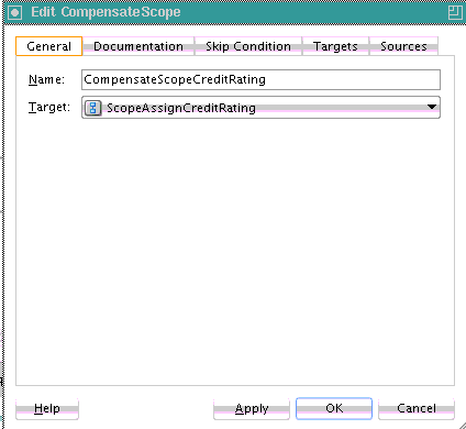

The compensateScope activity is used to start compensation on a specified inner scope that has already completed successfully. Use this activity only from within a fault handler, another compensation handler, or a termination handler.
When you create a compensateScope activity, you select a target that must refer to the immediately-enclosed scope. The scope must include a fault handler or compensation handler.
This activity is supported in BPEL 2.0 projects.
To create a compensateScope activity:
The following example shows the .bpel file after design is complete for a compensateScope activity. The compensateScope activity is defined in a catchall fault handler. The scope in which to invoke the compensation handler is defined.

The following example shows the .bpel file after design is complete for an exit activity.
<sequence>
<!-- receive input from requester -->
<receive name="receiveInput" partnerLink="client" portType="tns:Test"
operation="process" variable="input" createInstance="yes"/>
<assign>
<copy>
<from>$input.payload</from>
<to>$output.payload</to>
</copy>
</assign>
<!-- respond output to requester -->
<reply name="replyOutput" partnerLink="client"
portType="tns:Test" operation="process" variable="output"/>
<exit/>
</sequence>
The terminate activity immediately terminates the behavior of a business process instance within which the terminate activity is performed. All currently running activities must be terminated as soon as possible without any fault handling or compensation behavior. The terminate activity does not send any notifications of the status of a BPEL process service component. If you are going to use the terminate activity, first program notifications to the interested parties.

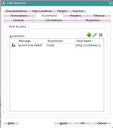

In the , double-click the BPEL process service component.
In the Components window, expand BPEL Constructs.
Drag a Receive activity, Invoke activity, Pick activity, or Scope activity into the designer.
Expand the Receive, Invoke, or onMessage branch of the Pick or Scope activity.
Click the Assertions tab.
If you are creating an assertion for a BPEL 2.0 project, perform the following tasks. Otherwise, go to Step 6.
Select when to execute the condition. Table 12-9 provides details.
Table 12-9 Assertion Condition Tabs
| To Create A... | Select The... |
Preassertion condition |
Pre Asserts tab |
Postassertion condition |
Post Asserts tab |

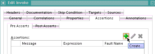

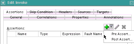

Click the Add icon, as shown in Figure 12-41.
Figure 12-41 Add Icon of Assertions Tab in BPEL 2.0
The Assert dialog is displayed.
If you are creating an assertion for a BPEL 1.1 project, perform the following tasks.
Click the Add icon, as shown in Figure 12-42.
Figure 12-42 Add Icon of Assertions Tab in BPEL 1.1
Select when to execute the condition. Table 12-10 provides details.
Table 12-10 Condition Execution Options
Pre Assert |
If selected, the condition is executed before the invoke or reply activity send out the outbound message. Note: A fault policy does not handle faults thrown from a preassert condition. Only faults thrown from a postassert condition are supported. For more information about fault policies, see Handling Faults with the Fault Management Framework. |
Post Assert |
If selected, the condition is executed after an invoke activity, receive activity, or onMessage branch receives the inbound message. |
Based on your selection, the Pre Assert or Post Assert dialog is displayed.

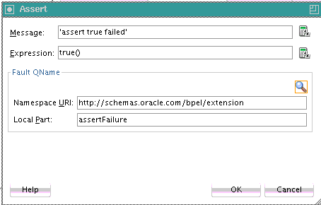

Specify values for the assertion condition, as shown in Figure 12-43. For this example, Post Assert was selected for an assertion condition on a receive activity in a BPEL 2.0 project.
Select the Fault QName to be thrown by clicking the Search icon and selecting an existing fault from the Fault Chooser dialog. You can also provide your own values for the Namespace URI and Local Part fields of the fault. If you do not specify anything for the Fault QName, then a bpelx:assertFailure fault is thrown.
When complete, click OK to return to the Assertions tab of the activity. The completed assertion condition is displayed, as shown in Figure 12-44.
Click Apply, then OK.

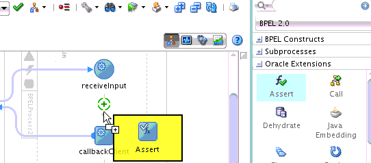

In the Components window, expand Oracle Extensions.
Drag an Assert activity into the designer, as shown in Figure 12-45.
Figure 12-45 Assert Activity in Components Window

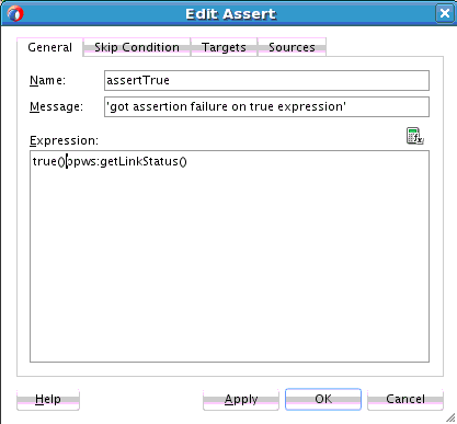

In the BPEL 1.1 example that follows, the bpelx:assert condition in the standalone assert activity, when evaluated to false, returns the following message:
got assertion failure on true expression
If the condition evaluates to true, no fault is thrown from the assert activity and the remaining activities in the BPEL process flow are executed normally.
<bpelx:assert expression="true()bpws:getLinkStatus()" message="'got assertion failure on true expression'"

You can also create assertion conditions in a standalone assert activity in a BPEL process service component. The assertion specifies an XPath expression that, when evaluated to false, causes a BPEL fault to be thrown from the activity.
The bpelx:assert extension implements assertions in the standalone assert activity:
<bpelx:assert name="Assert1" expression="string" message="string"/>
For information about using the standalone assert activity, see How to Create Assertion Conditions.
The assertion condition is specified as a nested extension element. The following example shows the postassertion condition schema definition in BPEL 2.0.

The bpelx:postAssert extension specifies the XPath expression to evaluate upon receipt of a callback message from a partner. If the assertion expression returns a false boolean value, the specified fault is thrown from the activity. If the assertion expression returns a true boolean value, no fault is thrown and the activities following the invoke activity, receive activity, or the onMessage branch of pick and scope activities are executed as in a normal BPEL process flow.
The bpelx:preAssert or bpelx:postAssert extension is similar to the Java assert statement. In Java, if the assert expression does not evaluate to true, an error is reported by the JVM. Similarly, the expression in the bpelx:preAssert or bpelx:postAssert extension must evaluate to true; otherwise, the specified fault is thrown.
For example, with the BPEL 1.1 invoke activity shown in the following example, if the XPath expression specified in the assertion condition returns false, the NegativeCredit fault is thrown.

Starting with 12c, all web service SOAP faults are not automatically retried based on the fault code returned from the external service. SOAP faults are now retried only when the fault code is classified as server-related (also known as receiver-related). Fault codes classified as client-related do not result in retries. This differs from 11g Release 1 (11.1.1.x), in which Oracle SOA Suite retried all SOAP faults regardless of their fault code (all faults returned were converted to a bpelx:remoteFault in BPEL, which was retriable).
In 12c when a fault occurs in a reference binding component, the fault code is returned to a BPEL process. The fault is retried based on the setting in the fault code. This is beneficial because you may want to retry the fault only under specific circumstances (such as a system downtime issue). For all other fault occurrences (such as incorrect input), you may not want a retry to occur. In fact, retries on all SOAP faults can delay the processing of legitimate messages.
As described in the Simple Object Access Protocol (SOAP) 1.1 specification at http://www.w3.org/TR/2000/NOTE-SOAP-20000508/#_Toc478383510, a fault can have a code of server (also known as receiver) or client. The classification of faults determines whether the faults are retriable.
Server
Server errors indicate that the message cannot be processed for reasons not directly related to the message contents, but rather to the processing of the message. For example, processing can include communicating with a server that did not respond. The message may succeed at a later time. This is defined as a retriable fault.
Client
Client errors indicate that the message was incorrectly formed or did not contain the appropriate information to succeed. For example, the message may lack the proper authentication or payment information. This typically indicates that the message must first be changed before being resent. This is defined as a nonretriable fault.
This fault classification information is propagated into a FabricInvocationException error. For fault codes classified as client-related, the retryType flag within this exception is set to NO_RETRY.
If necessary, you can still invoke a retry on every fault. Set the binding.ws property oracle.soa.always.retry.on.fault to true in the composite.xml file. This enables Oracle SOA Suite to always retry on any SOAP faults regardless of the fault code.
<reference name="myreference" . . . <binding.ws port=". . . ." location=". . ." <property name="oracle.soa.always.retry.on.fault">true</property> </binding.ws>
