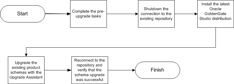

The Oracle GoldenGate Studio upgrade from a previous 12c release to 12c (12.2.1.2.6) is performed in-place; that is, the upgrade operations are performed on the existing 12c domain.
High-level upgrade steps:
Review the flowchart and roadmap for an overview of the upgrade process for Oracle GoldenGate Studio .
The steps you take to upgrade your existing domain varies depending on how your domain is configured and which components are being upgraded. Follow only those steps that are applicable to your deployment.
Figure 3-1 Upgrade Process Flowchart for Oracle GoldenGate Studio
Table 3-1 Tasks for Upgrading Oracle GoldenGate Studio
| Task | Description |
Required If you have not done so already, review the introductory topics in this guide and complete the required pre-upgrade tasks. |
The pre-upgrade tasks include cloning your production environment, verifying system requirements and certifications, purging unused data, and creating non-SYSDBA user. For a complete list of pre-upgrade tasks, see Preparing to Upgrade Oracle GoldenGate Studio. |
Required Shut down the connection to the existing 12c repository. |
Before starting the upgrade process, shut down the connection to the 12c (12.2.1.2.6) repository. WARNING: Failure to shut down your servers during an upgrade may lead to data corruption. |
Required Download and install the Oracle GoldenGate Studio 12c (12.2.1.2.6) distribution in the new Oracle home. |
To install the product distribution, see Installing Oracle GoldenGate Studio. |
Required Upgrade the existing schemas with the Upgrade Assistant. |
The schemas you created during the 12c (12.2.1.x) installation are supported in 12c (12.2.1.2.6). Therefore, you do not need to create the schemas again. You must upgrade all the repository schemas by using Upgrade Assistant. See Using the Oracle Fusion Middleware Upgrade Assistant to Upgrade Product Schemas. |
Required Connect to the 12c (12.2.1.2.6) repository and verify your upgrade. |
The upgrade process is complete. You can now verify the 12c (12.2.1.2.6) instance to compare the previous 12c environment with the 12c (12.2.1.2.6) and verify the data and configuration settings are consistent in the newly upgraded environment. |
