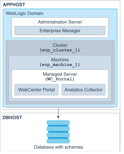

This topology represents a standard WebLogic Server domain that contains an Administration Server and a cluster that contains two Managed Servers.
Figure 1-1 shows the standard installation topology for Business Intelligence.
See Table 1-1 for information on the elements for this topology.
Oracle Essbase component is deprecated in Oracle Business Intelligence 12.2.1.4.0 (on Oracle Fusion Middleware 12.2.1.4.0).Figure 1-1 Business Intelligence Standard Installation Topology
The standard installation topology typically includes common elements.
Table 1-1 describes all elements of the topology illustration:

| Element | Description and Links to Related Documentation |
| APPHOST | A standard term used in Oracle documentation to refer to the machine that hosts the application tier. |
| DBHOST | A standard term used in Oracle documentation to refer to the machine that hosts the database. |
| WebLogic Domain | A logically related group of Java components (in this case, the Administration Server, Managed Servers, and other related software components) and non-Java components.
See What Is an Oracle WebLogic Server Domain? in Understanding Oracle Fusion Middleware. |
| Administration Server | Central control entity of a WebLogic domain. It maintains configuration objects for that domain and distributes configuration changes to Managed Servers.
See What Is the Administration Server? in Understanding Oracle Fusion Middleware. |
| Enterprise Manager | The Oracle Enterprise Manager Fusion Middleware Control is a primary tool used to manage a domain.
See Oracle Enterprise Manager Fusion Middleware Control in Understanding Oracle Fusion Middleware. |
| Cluster | A collection of multiple WebLogic Server instances running simultaneously and working together.
See Overview of Managed Servers and Managed Server Clusters in Understanding Oracle Fusion Middleware. |
| Machine | A logical representation of the computer that hosts one or more WebLogic Server instances (servers). Machines are also the logical glue between the Managed Servers and the Node Manager. In order to start or stop the Managed Servers using the Node Manager, associate the Managed Servers with a machine. |
| Managed Server | A host for your applications, application components, web services, and their associated resources.
| Infrastructure | A collection of services that include the following:
