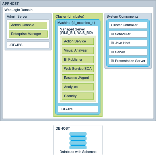

Figure 1-1 shows the standard upgrade topology for Oracle Business Intelligence.
Figure 1-1 Oracle Business Intelligence Standard Upgrade Topology
