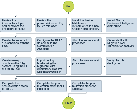

The 11g system is left unchanged during and after the migration process is complete.The following flowchart shows the flow of the migration process.
Figure 3-1 Migration Process Flowchart for Oracle Business Intelligence from 11g to 12c
Table 3-1 provides a high-level summary of the steps that you must perform to migrate from Oracle BI 11g to 12c.
Table 3-1 Tasks for Migrating Oracle Business Intelligence from 11g Release
