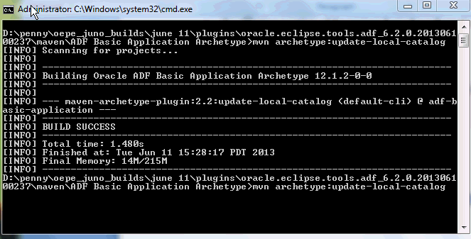

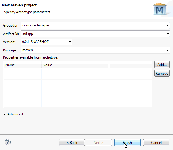

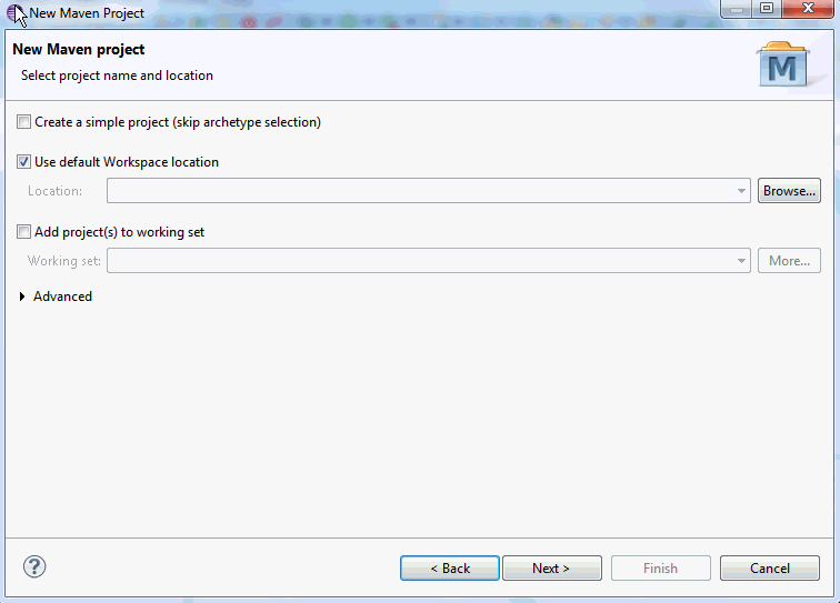

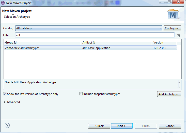

6.5 Installing the Maven Archetypes
To populate your repository with the Maven archetypes, run the clean install, and archetype update local catalog commands, as shown in Figure 6-2 and Figure 6-3.
6.5.1 How to Install the Maven Archetypes
Install the Maven archetypes from the command line.
To install the Maven archetypes:
  1. Open a command prompt and navigate to the archetype directory of your plugins install: {OEPE install}/plugins/oracle.eclipse.tools.adf/maven/ADF Basic Application Archetype
  2. Run the following command:
    mvn clean install
  3. Run a second command:
    mvn archetype:update-local-catalog
    Figure 6-2 Maven Archetype Maven Clean Install Command
    Clean install command
    Figure 6-3 Maven Archetype Update Local Catalog Command

  1. In your OEPE Eclipse application go to File > New > Project. In the New Project dialog expand the Maven directory and select Maven Project and click Next.
  2. In the New Maven Project dialog, select your project name and location, as shown in Figure 6-5.
  3. Click Next. The Select an Archetype dialog appears. Select the ADF archetype called com.oracle.adf.archetypes, as shown in Figure 6-6. Type "adf" as a filter to filter out the many other options.
  4. Select the ADF archetype and click Next.
  5. Enter your values in the dialog fields, as shown in Figure 6-7.
  6. Click Finish. The new Maven application appears in your Project Explorer window.
    Figure 6-5 Creating a New Maven Project - Filename and Location
    new maven project - file name
    Figure 6-6 Creating a New Maven Project - Selecting the ADF Archetype
    new maven project detail
    Figure 6-7 Creating a New Maven Project - Specifying the Archetype Parameters
