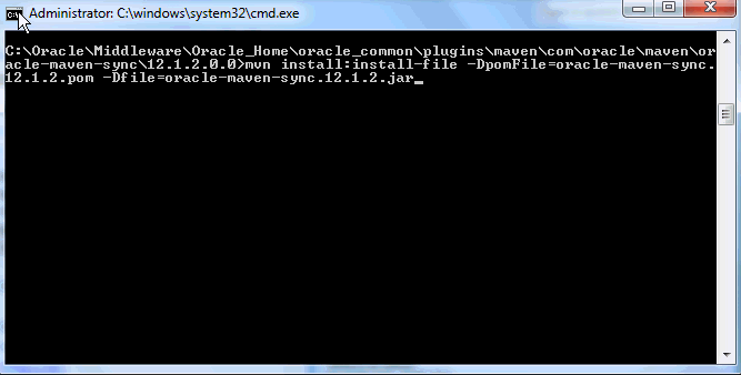

To run the plug-in you first need to install it on your Maven repository. You can install it into your local repository on your computer, or you can deploy it into a remote shared internal repository.
To install the plug-in to a local repository using the command line:
In a command prompt, navigate to the location of your Maven plug-in jar located at a location similar to ORACLE_COMMON/oracle_common/plugins/maven/com/oracle/maven/oracle-maven-sync/12.1.3
Run the following command to install to the default repository:
mvn install:install-file -DpomFile=oracle-maven-sync.12.1.3.pom -Dfile=oracle-maven-sync.12.1.3.jar
Run the following command to install to a specified directory:
mvn install:install-file -DpomFile=oracle-maven-sync.12.1.3.pom -Dfile=oracle-maven-sync.12.1.3.jar -Dmaven.repo.local=<path to local repository>
Figure 6-1 Using the Oracle Maven Synchronization Plug-In Install Command

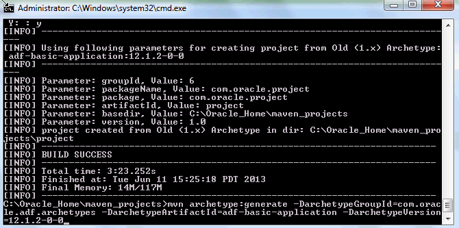

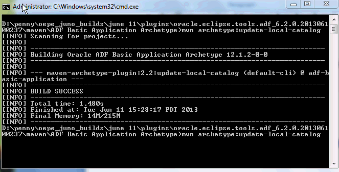

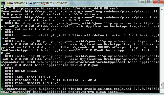

To populate your repository with the Maven archetypes, run the clean install, and archetype update local catalog commands, as shown in Figure 6-2 and Figure 6-3.

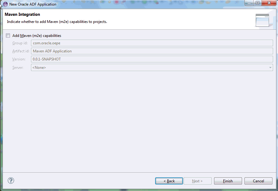

You can create an ADF application with Maven integration in the following ways:

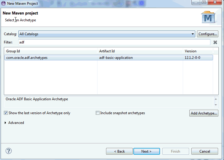

From a command-line using the OEPE provided ADF Application Archetype

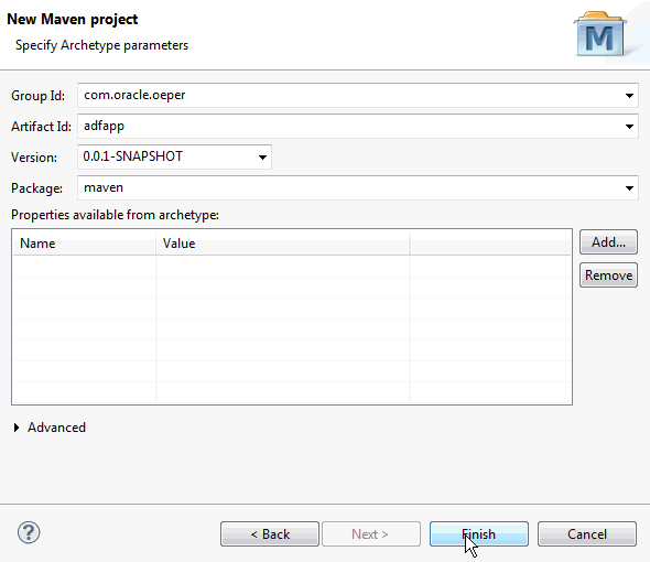

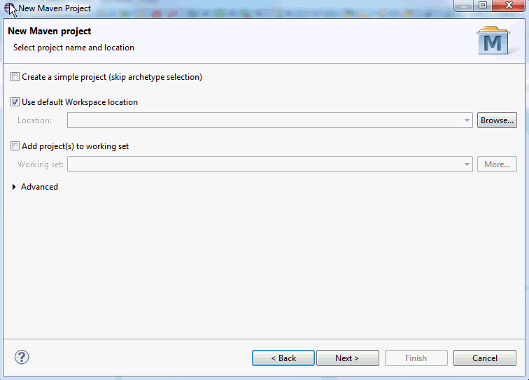

From OEPE using the New Maven Project and using the ADF application Archetype
From OEPE using the New ADF Application Wizard
You can create an ADF application using the command line.
To create an ADF application from the command line:
You can create a Maven application using the Maven Project wizard.
To create a Maven application from the application wizard:

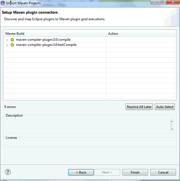

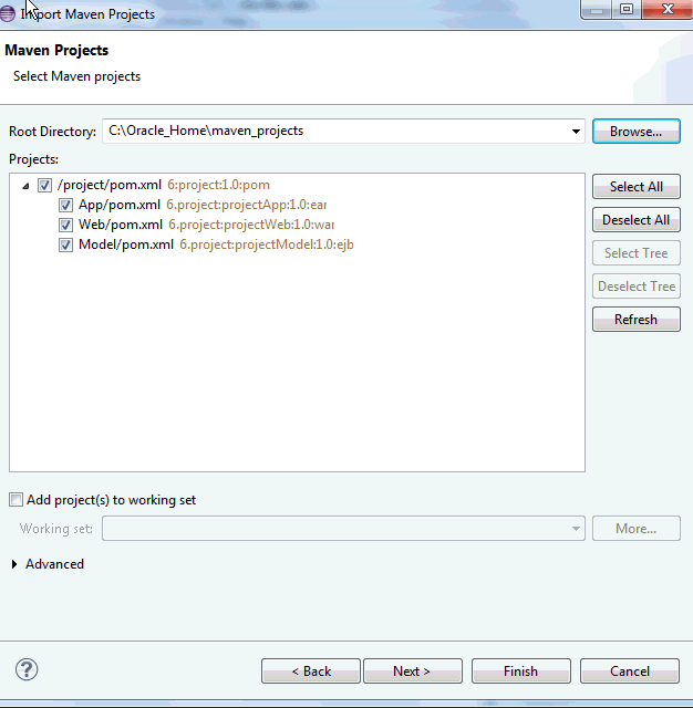

In OEPE you can import your existing Maven projects into your working application. ADF applications can be imported as well as any J2EE Maven application built outside the OEPE framework.
To import an existing Maven project:
