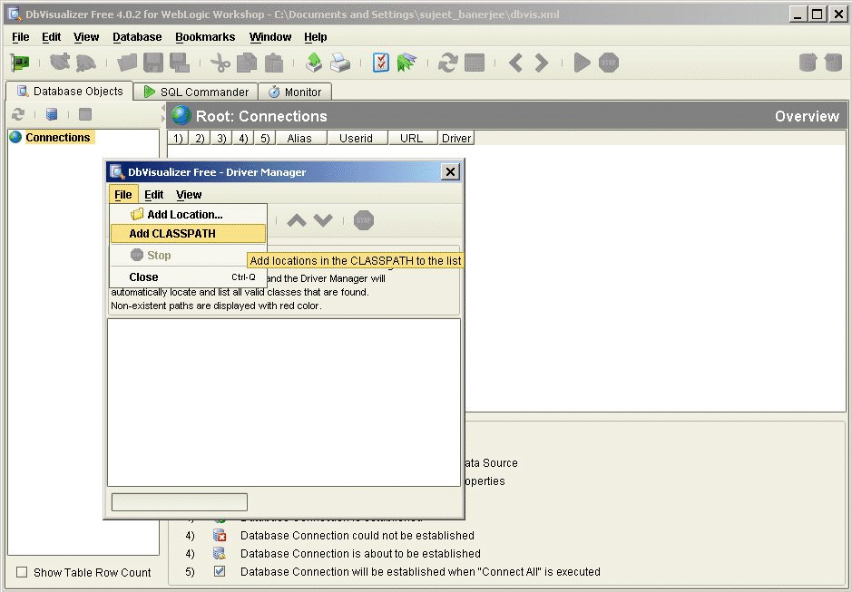

To use DBVisualizer, perform the following steps:
  1. Configure DBVisualizer.
    1. Ensure that ldjdbc.jar exists in your CLASSPATH. Start DBVisualiser from the Database menu select Driver Manager.
    2. DbVisualizer View of Liquid Data
    3. Select Add CLASSPATH from the File menu of the driver manager dialog. You should see the ldjdbc.jar listed.
    4. Select ldjdbc.jar from the list shown then select Find Drivers from the Edit menu of the driver manager. You should see the com.bea.ld.jdbc.LiquidDataJDBCDriver. This means the JDBC driver has been located.
    5. DbVisualizer View of Liquid Data
    6. Close the driver manager.

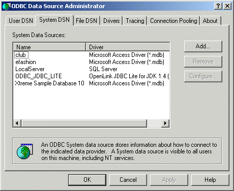

    4. Open Administrative tools Data Sources (ODBC). You should see the following:

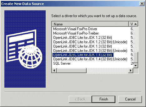

    6. Go to the System DSN tab and click Add.
    7. Select "JDBC Lite for JDK 1.4 (32 bit)" and click Finish.

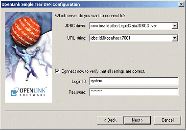

    11. Click Next. Then on the next screen, enter the following in the JDBC driver field:
    12. com.bea.ld.jdbc.LiquidDataJDBCDriver.
      Enter the following in the URL string field:
      jdbc:ld@<machine_name>:<port>:<app_name>

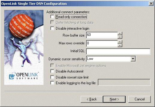

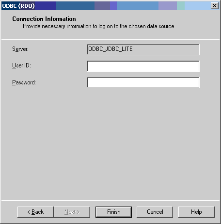

    13. Check the Connect now to verify that all settings are correct checkbox. Provide the login and password to connect to the Liquid Data WebLogic server.
    14. Click Next. The screen shown below will display.

    You can select the DSN you have created earlier (see the procedure in section Using OpenLink ODBC-JDBC Bridge or Using the EasySoft ODBC-JDBC Bridge). In this example, it is ODBC_JDBC_LITE.
    Selecting ODBC_JDBC_LITE, prompts the following dialog:
    Data Source Selection
  3. Enter the domain login and password. Note that because the URL contains the Liquid Data RTLApp application, you should use the domain login and password that the domain of the RTLApp application uses. (These will most likely be "weblogic".)

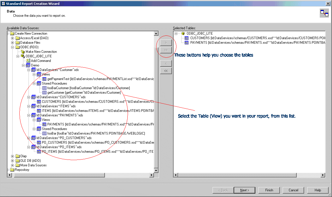

  5. Generate a report using the Add command or by dragging the metadata to the right. In this example we will be using both options. You can choose the tables you want to use in the report as shown in Figure 7-5.
  6. Figure 7-5 Selecting the Table View

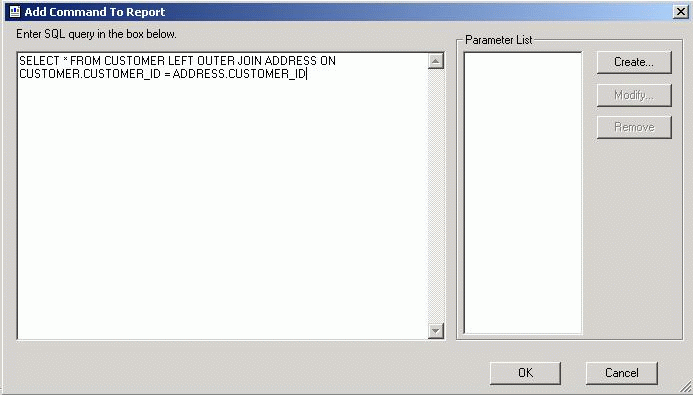

    Alternatively, you can choose the Add Command option to type an SQL query directly, which will show you a window like one in the Figure 7-6.
    Figure 7-6 Add Command
    Add Command
  7. Click the Ok Button to see the Command added to the Right hand side of the window.

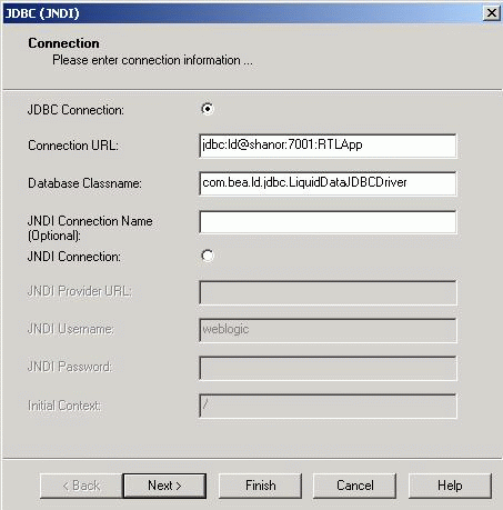

Crystal Reports 10.0 comes with a direct JDBC interface that can be used to interact directly with the Liquid Data JDBC driver. The only difference between the ODBC and JDBC approach is that in JDBC, a new type of connection is used, as shown in Figure 7-12.
Figure 7-12 Connection Dialog Box
Figure 7-13 shows screen that requests the connection parameters for the JDBC Interface of Crystal Reports.
Figure 7-13 Connection Information Dialog Box

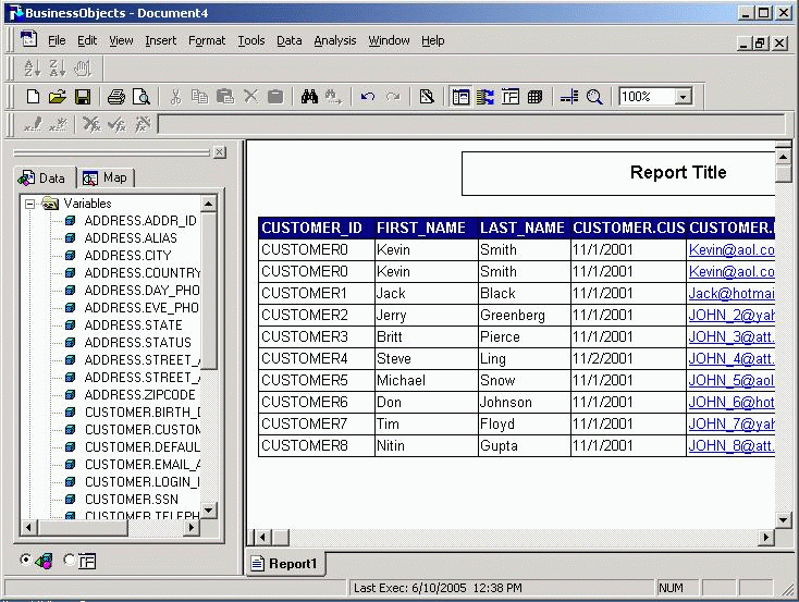

    7. Click Run to execute the query. The result is seen as shown in Figure 7-24.
    8. Figure 7-24 Business Objects Panel.

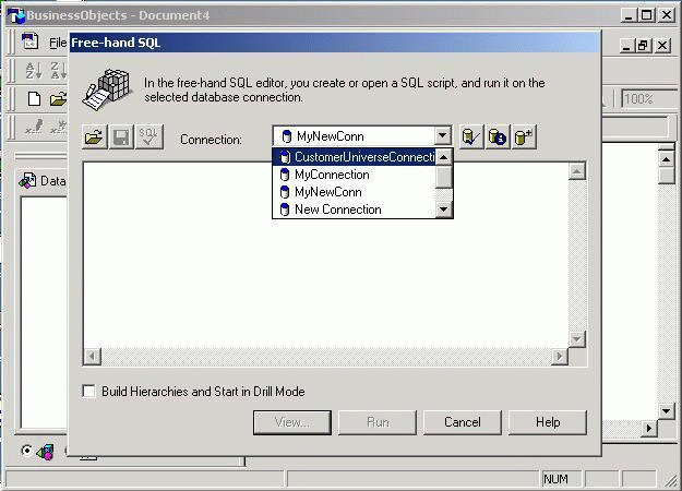

  3. You can execute the pass-through queries as follows:
    1. In the Business Object application, click New to create a new report.
    2. In the New Report Wizard choose Others instead of Universe as shown in Figure 7-25.
    3. Figure 7-25 Data Access Dialog Box.
    4. Choose Free-hand SQL and click Finish.
    5. Select the connection you made using Designer 6.1, as shown in Figure 7-26.
    6. Figure 7-26 Free Hand SQL Menu
      Free Hand SQL Menu
    7. Type in your SQL query and click Run to generate the report, as shown in Figure 7-27.

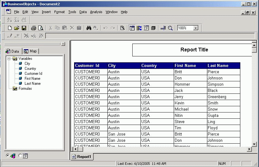

    9. Click Run. You should see the report shown in Figure 7-28.
    10. Figure 7-28 Business Objects Report

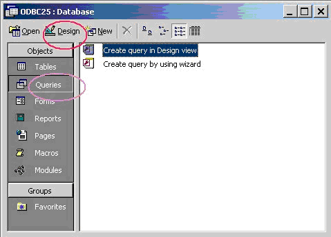

  5. Click Queries, then Design as indicated in Figure 7-30. You should see a screen shown similar to that shown in Figure 7-31.
  6. Figure 7-31 Select Query and Show Table Screens

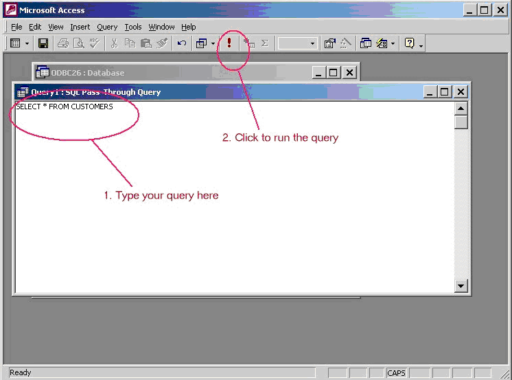

  10. Type in your SQL query and click Run, as shown in the Figure 7-33.
  11. Figure 7-33 Running the SQL Query

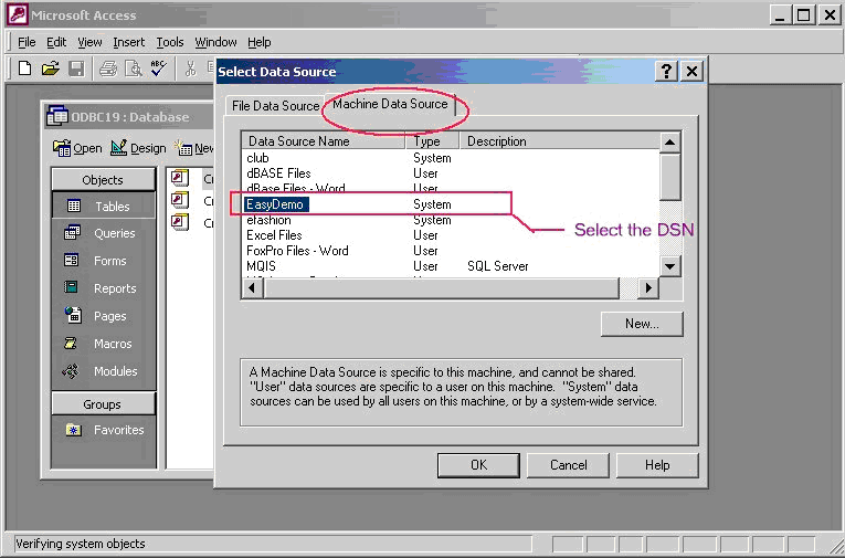

  12. In the dialog that pops up (as shown in Figure 7-34), move to the tab Machine Data Source and select the appropriate DSN for the database connectivity.
  13. Figure 7-34 Selecting the DSN for the Database
