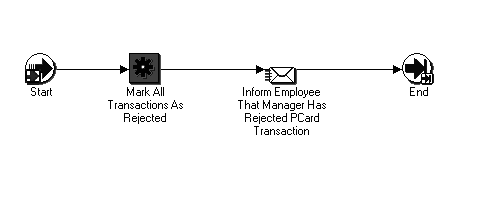

Manager Rejection of PCard Transactions Process
