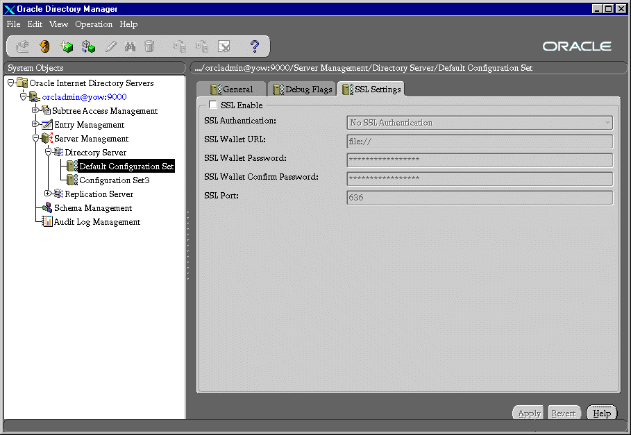

Configuring SSL Parameters by Using Oracle Directory Manager
You can examine and modify the values for the SSL configuration parameters in each configuration set entry that you have created and in each server instance that is currently running.
You cannot directly change the parameters for an active instance. If you want to change the parameters for an active instance, change the parameters in a configuration set entry and save it. After it is saved, you can stop current instances and refer to the newly modified configuration set in the start server message.
To view and modify SSL configuration parameters:
  1. In Oracle Directory Manager's navigator pane, expand Oracle Internet Directory Servers > server you want to explore > Server Management.
  2. Expand either Directory Server or Replication Server, as appropriate. The numbered configuration sets are listed beneath your selection.
  3. Select the configuration set that you want to examine. The group of tab pages for that configuration set entry appear in the right pane.
  4. Select the SSL Settings tab:
    You can change the parameters in this tab page and save them. The fields in this tab page are described in Table 5-2.
    See Also:
    "Managing Server Configuration Set Entries by Using Oracle Directory Manager" for information on changing parameters in a configuration set entry
