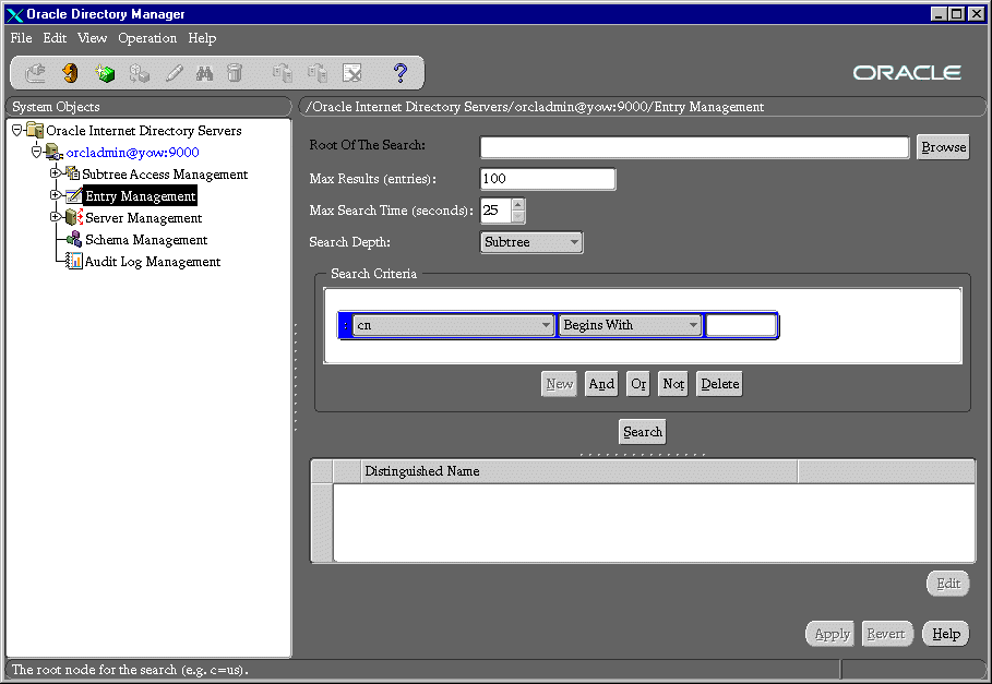

Searching for Entries
You can display all entries by using the navigator pane, or search for one or more specific entries by using Oracle Directory Manager's search feature.
To display an entry by using the navigator pane, expand Entry Management to display its subtree:
The root of the tree is listed first, then the second level, and so forth, moving from left to right. The subtree lists the RDN of each entry in hierarchical order. To see the lower level entries within any subtree, click the plus sign (+) to the left of the parent entry.
To search for a directory entry:
  1. In the navigator pane, select Entry Management. The Search fields appear in the right pane:
  2. In the Root of the Search text box, enter the DN of the root of your search.
    For example, suppose you want to search for an employee who works in the Manufacturing division in the IMC organization in the Americas. The DN of the root of your search would be:
    ou=Manufacturing,ou=Americas,o=IMC,c=US
    You would therefore type that DN in the Root of the Search text box.

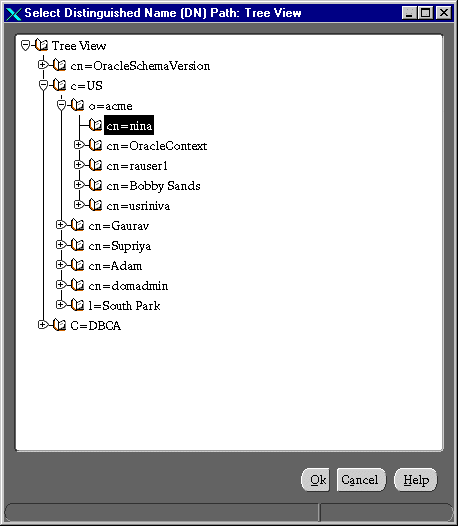

    You can also select the root of your search by browsing the directory tree. To do this:
    1. Click the Browse button to the right of the Root of the Search text box. The Select Distinguished Name (DN) Path: Tree View dialog box appears:
    2. Click the + next to Tree View to display its entries.
    3. Continue navigating to the entry that represents the level you want for the root of your search.
    4. Select that entry and click OK. The DN for the root of your search appears in the Root of the Search text box in the right pane.
  3. In the Max Results (entries) text box in the search window of Oracle Directory Manager, type the maximum number of entries you want your search to retrieve. The default is 100.
  4. In the Max Search Time (seconds) box, type the maximum number of seconds for the duration of your search. The value you enter here must be at least that of the default, namely, 25.
  5. In the Search Depth list, select the level to which you want to search. The options are:
    • Base: To retrieve a particular directory entry. Along with this search depth, you use the Search criteria bar to select the attribute objectClass and the filter Present.
    • One Level: To limit your search to all entries beginning one level down from the root of your search
    • Subtree: To search entries within the entire subtree, including the root of your search
  6. In the Search Criteria field, use the lists and text boxes on the search criteria bar to focus your search.
    1. In the menu at the left end of the search criteria bar, select an attribute of the entry for which you want to search.
    2. In the text box at the right end of the search criteria bar, type the value for the attribute you just selected. For example, if the attribute you selected was cn, you could type the particular common name you want to find.
    3. In the menu in the middle of the search criteria bar, select a filter. Options are:
      Filter  Description
      Begins With
      To search by using only the first few characters of the attribute's value. For example, cn Begins With Fr retrieves all entries in which the first few letters of the cn attribute are Fr. These would include Frank, Fran, Frances, Franklin, etc.
      Ends With
      To search for an entry by using only the last few characters of the specified attribute's value.
      Contains
      To search for an entry in which the attribute you specified includes, but is not necessarily limited to, the value you enter. For example, cn Contains Wins retrieves all entries in which the cn attribute contains the letters wins. These would include Winslow, Czerwinski, Winship, etc.
      Exact Match
      To search for an entry whose specified attribute is the same as the value you enter. For example, cn Exactly Matches Franklin Baldwins retrieves all entries in which the cn attribute has the value Franklin Baldwins.
      Greater or Equal
      To search for an entry in which the specified attribute is numerically or alphabetically greater than or equal to the value you enter. For example, cn Greater or Equal Frank retrieves all entries with cn attributes that range from the first Frank to the end of the alphabet.
      Less or Equal
      To search for entries in which the specified attribute is numerically or alphabetically less than or equal to the value you enter. For example, cn Less or Equal Frank retrieves all cn attributes from the first Frank to the beginning of the alphabet.
      Present
      To determine if an entry with the specified attribute is present at that level of the tree. You do not need to enter a value to use this relationship. The phrase cn Present retrieves all entries with the cn attribute at that level of the tree.
  7. Beneath the Search Criteria field are five buttons described in Table 7-1. Use these buttons to further refine your search by enhancing the search criteria bar.
    Table 7-1 Search Criteria Buttons
    Button  Description
    New
    Creates a new search criteria bar in the Search Criteria field. This button is enabled only when the Search Criteria field is empty.
    And
    Creates another search criteria bar in the Search Criteria field. Matches all entries with one specified attribute with those that also have another specified attribute. For example, cn=Baldwins And title=Laborer retrieves all Baldwins who are also laborers.
    Or
    Creates another search criteria bar in the Search Criteria field. Matches all entries with either one specified attribute or another. For example, title=Laborer Or title=Foreman retrieves all employees who are either laborers or foremen.
    Not
    Negates the criterion in the selected search criteria bar and retrieves all entries that do not have the specified criterion. For example, cn=Frank And Not title=Laborer retrieves all persons named Frank who are not laborers.
    Delete
    Deletes a selected search criteria bar
  8. Click Search. The results of your search appear in the Distinguished Name window of the right pane.

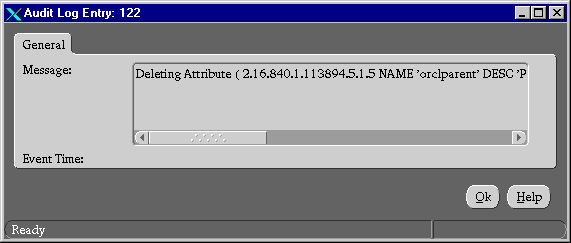

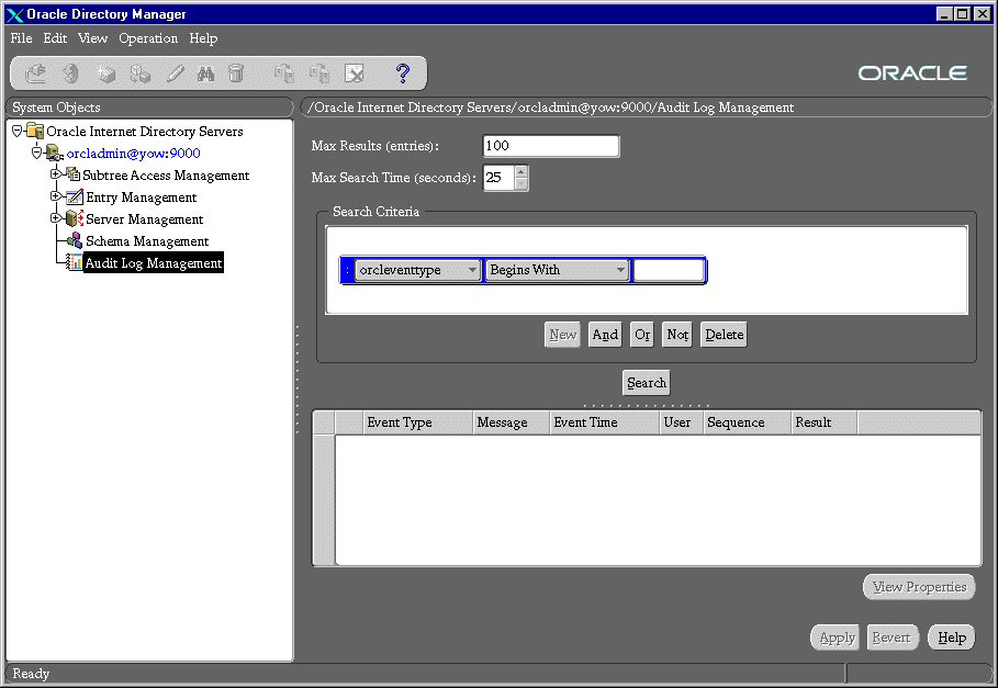

Searching for Audit Log Entries
You can search for audit log entries by using either Oracle Directory Manager or the ldapsearch command line tool.
To use Oracle Directory Manager to view audit log entries, in the navigator pane, select Audit Log Management. The corresponding right pane appears.
Use this pane to search for particular types of entries in the audit log.
The results of the search appear in the lower box. You can scroll both horizontally and vertically to see all the information.
To view the properties of a particular audit log entry, select it in the lower box and click View Properties. The Audit Log Entry dialog box displays the properties for the audit log entry you selected:

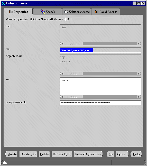

Viewing Directory Entry Attributes
Once you have displayed the results of your search, click the entry whose attributes you want to view. An Entry dialog box displays the attributes for that entry:
Some attributes may also be DNs. For example, one attribute for a given employee might be that employee's manager who, in turn, has a DN. In this case, when you display the Entry dialog box for the employee, you would see a Browse button next to the Manager text box. To find information about that manager, click Browse. The Directory: Entry Management dialog box appears. Follow the steps mentioned in "Searching for Entries".

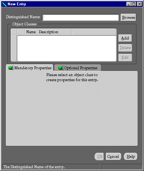

To add a new entry:
  1. Either click the Create button on the tool bar, or select Create Entry from the Operation menu. The New Entry dialog box appears:
  2. In the Distinguished Name field, type the full DN. You may also click Browse to locate the DN of the parent for the entry you want to add, then type the RDN for your new entry to the left of that parent DN.

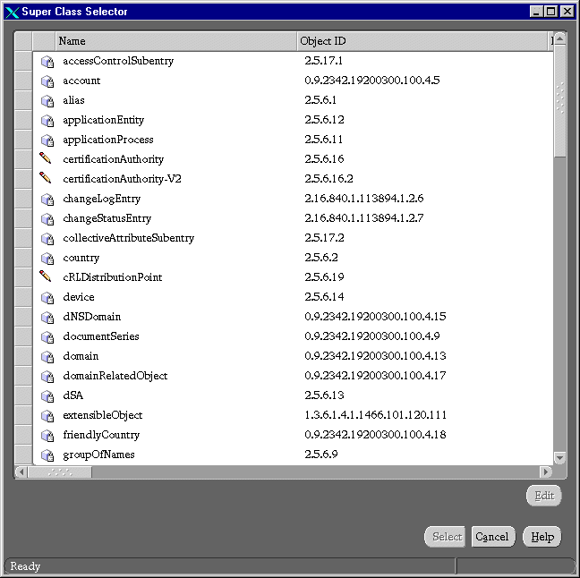

  3. To specify the object classes you want to use for the new entry, click the Add button to the right of the Object Classes window. The Super Class Selector dialog box appears:
  4. In the Super Class Selector dialog box, select an object class, then click Select. As you select from the object class list, mandatory and optional attributes populate the windows in the tab pages in the lower half of the New Entry dialog box. You must enter values into the mandatory attributes fields. You are not required to enter values into the optional attributes fields.
  5. When you have selected the object classes and provided values for the appropriate attributes, click OK.

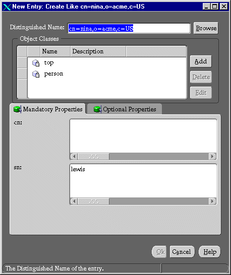

Adding an Entry by Copying an Existing Entry
You can use Oracle Directory Manager to create a new entry by copying from an existing entry and changing its DN. You should also change the attributes, such as name and address, so that they correspond to the new DN. To add an entry, you must have write access to its parent.
Tip:
You can find a template for the new DN by looking up other similar entries in the search pane.
To add an entry by copying an existing entry:
  1. When you click Entry Management in the navigator pane, the Search pane appears. Use it to search for an entry that you want to use as a template.
    See Also:
  2. Double-click an entry from those retrieved. The Entry dialog box for that entry appears:
    This entry will serve as your template in the Create Like pane.
  3. Click the Create Like button in the Entry dialog box.
    A New Entry: Create Like window appears:
  4. Change critical fields to tailor this particular entry to the one that you want to create. You must always change the DN and the common name in this operation, or the pane will not save your new entry data. For example, if you create an entry for Henri Latrobe using the entry for Henri Latour as the template, then you have to change cn=Henri Latour in the DN to cn=Henri Latrobe. You also have to change the Henri Latour value in the common name attribute to Henri Latrobe, and any other attributes that must be unique, such as employee number and telephone number.
  5. Click OK to save your changes.

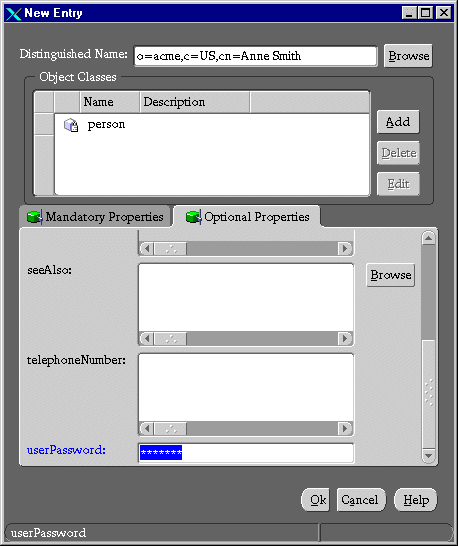

Example: Adding a User Entry by Using Oracle Directory Manager
In this example, we create a user named Anne Smith and assign her a password.
  1. Login as the administrator.
  2. Expand Oracle Internet Directory Services > server instance, and select Entry Management.
  3. On the toolbar, click the Create button. The New Entry dialog box appears.
  4. In the Distinguished Name field, type the full DN. You may also click the Browse button to locate the DN of the parent for this entry, then type the RDN, namely, cn=Anne Smith, to the left of that parent DN.
  5. Click the Add button to the right of the Object Classes window. The Super Class Selector dialog box appears.
  6. In the Super Class Selector dialog box, select the person object class, then click Select. This returns you to the New Entry dialog box.
  7. In the New Entry dialog box, click the Optional Properties tab, and scroll to the userPassword window.
  8. Type the password for Anne Smith. The Optional Properties tab in the New Entry dialog box now looks something like the following:

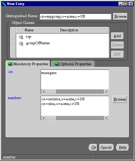

Adding Group Entries
A group entry is one that contains a list of entries, for example, an e-mail list. You associate it with either the groupOfNames or groupOfUniqueNames object class, which has the object class orclPrivilegeGroup as a subclass.
You determine membership in the group the group by adding DNs to the multi-valued attribute member if the entry belongs to the groupOfNames object class, or uniqueMember if the entry belongs to the groupOfUniqueNames object class.
To add a group entry:
  1. Either click the Create button on the tool bar, or select Create Entry from the Operation menu. The New Entry dialog box appears.
  2. In the Distinguished Name field, type the full DN. You may also use the Browse button to locate the DN of the parent for the entry you want to add, then type the RDN for your new entry to the left of that parent DN.
  3. To specify the object classes you want to use for the new entry, click the Add button to the right of the Object Classes window. The Super Class Selector dialog box appears.
  4. In the Super Class Selector dialog box, select the top object class, then click the Select button. The top object class appears in the Object Classes window of the New Entry dialog box.
  5. In the same way, click the Add button to the right of the Object Classes window and, from the Super Class Selector dialog box, select the groupOfNames or groupOfUniqueNames object class. Click the Select button. The object class you selected appears in the Object Classes window of the New Entry dialog box.
  6. Enter the mandatory and optional attributes for your group entry.
    Note the Browse button next to the member window. Clicking Browse displays the Directory: Entry Management dialog box. Use this dialog box to search for a particular entry you want to add to the list. In the Distinguished Name window of the Directory: Entry Management dialog box, select the entry, then click the OK button. This returns you to the New Entry dialog box. The entry you just selected is added to the list in the members window.
  7. After you have completed the attribute fields, click OK.
