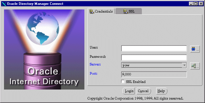

When you start Oracle Directory Manager for the first time, an alert tells you that you must connect to a server. Click OK.

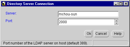

The default port is 389. You can change the port if you wish. However, if you have an Oracle Directory Server running on a non-default port, be sure that any clients that will use it are informed of the correct port to use. Click OK. The Oracle Directory Manager Connect dialog box appears:
Table 4-1 Credential Information
Field | Description |
User |
The first time you log in, do so either as the super user or anonymously. If you intend to configure SSL features during this session, login as the super user.
If you are logging in as the super user, in the User box, type If you are logging in anonymously, leave the User box empty. If you have already set up the user's entry by using LDAP command line tools, you can enter that user's entry in one of two ways: |
Password |
If you are logging in as the super user and you specified a password for the super user during installation, in the Password box, type the password you specified. Otherwise, type the default password, namely, After you are logged into Oracle Directory Manager and have connected to a directory server, you should change this password to protect the directory. For instructions on how to do this, see "Managing Super, Guest, and Proxy Users". |
Server |
Select the host containing the directory server to which you want to connect by selecting it from the Server list. If you are already connected to a directory server, and you want to connect to a directory server on a different host, click the button to the right of the Server field. A dialog box presents you with a list of available servers. Select the one you want and click OK. If you want to add a directory server, click Add. The Directory Server Connection dialog box appears. Type the name of the directory server you want to add, then click OK. |
Port |
The default port (389) appears in this field. If there is more than one directory server instance on the same host, each directory server instance has a different port. |

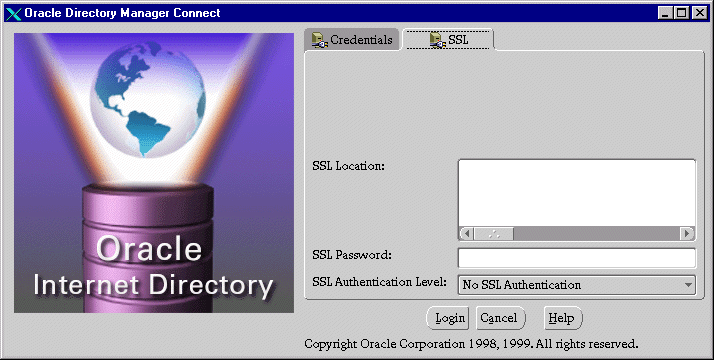

SSL Enabled |
You can connect to a directory server either with or without SSL. If you connect by using Secure Sockets Layer (SSL), then Oracle Directory Manager becomes an SSL client. All commands you issue through Oracle Directory Manager are then sent over SSL. You can connect in this way if both of the following two conditions are met:
Selecting this check box causes all messages you issue by using Oracle Directory Manager to be sent over SSL. |

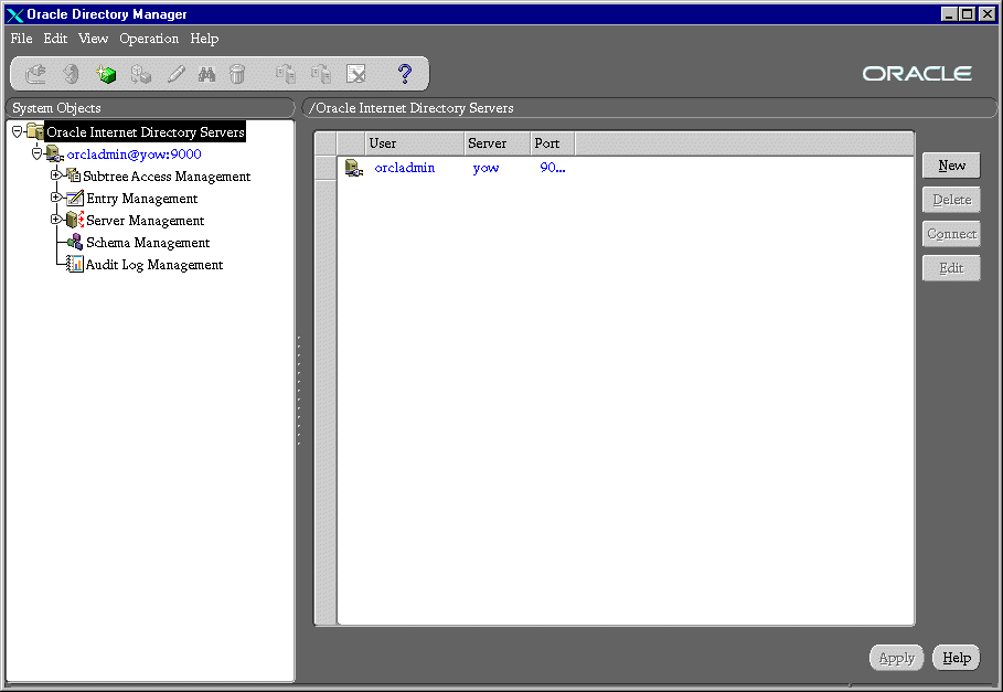

Like the directory itself, the navigator pane (left side of the double window interface) has a tree-like structure. When Oracle Directory Manager first opens, the navigator pane shows only one tree item, "Oracle Internet Directory Servers." By clicking the plus sign(+) next to the tree item, subcomponents of that tree item appear. Tree items that have plus signs in front of them may have their own sub-tree items. The plus sign becomes a minus sign (-) when the entry is expanded. You can expand and contract the tree by clicking the plus signs and minus signs.
For example, if you click the plus sign next to Oracle Internet Directory Servers in the opening window navigator pane, the tree expands to show the connection information for the server to which you are connected:
By clicking the plus sign (+) next to the server information, you make a number of other choices appear in the navigator pane.
