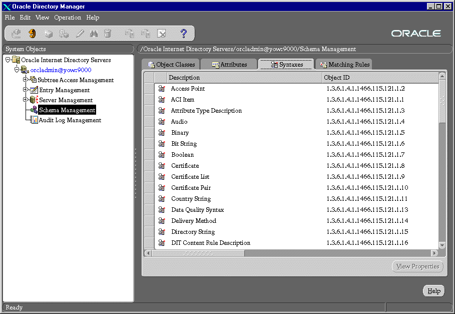

  1. In the navigator pane, expand Schema Management. The tabs in the Schema Management pane display the components of the schema:
    • Object classes
    • Attributes
    • Syntaxes
    • Matching Rules
  2. Click the Object Classes tab in the right pane. A pane like the following appears.

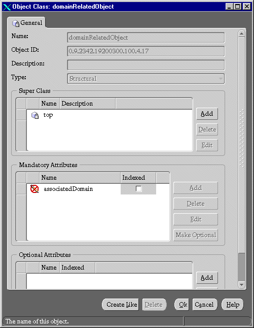

Viewing Properties of an Individual Object Class
To examine an individual object class and its attributes, select the Object Classes tab and double-click the object class in the list displayed in the panel. The properties of the selected object class appear in the Object Class dialog box:
Object classes from which attributes may be inherited are listed in the Super Class pane. The mandatory attributes are listed in the Mandatory Attributes window and optional attributes are listed in the Optional Attributes window. Each window indicates whether the attributes are indexed so that they can be used in a search expression.

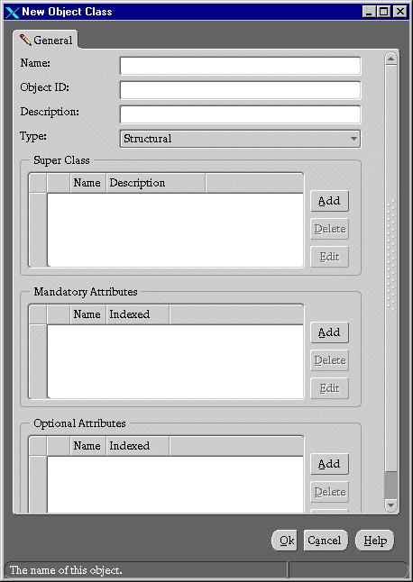

Adding Object Classes
To add object classes by using Oracle Directory Manager:
  1. In the navigator pane, select Schema Management, then choose one of the following methods:
    • In the right pane, select the Object Classes tab and click the Create button in the toolbar.
    • Click the Create button at the bottom of the right pane.
    • From Operations menu, select Create Object Class.
    The New Object Class dialog box appears:
    Alternatively, select an object class that is similar to one you would like to create, and then click the Create Like button. A window similar to the one shown above appears, but it includes the attributes of the selected object class. You can create the new object class using the selected one as a template.
  2. Enter the information in the fields that are described in Table 6-2.
    Table 6-2 Fields for Adding a New Object Class
    Field  Description
    Name
    Name of the object class you are creating
    Object ID
    A standardized numerical sequence based on IETF standards. It must be unique. Normally this is derived from the identifier assigned by registration agencies, such as ANSI or ISO. If you are creating a new object class, assign an identifier that is sure to be unique, following the system agreed upon within your organization.
    Description
    This optional field is for your information only
    Type
    The type of object class: Abstract, Structural, Auxiliary, None.
    See Also: "Object Class Types"
    Super Class
    The class(es) from which you are deriving this new object class. The new object class will inherit all the attributes of the superclass(es) you select. All structural object classes must have top as one of its superclasses.
    See Also: "Subclasses, Superclasses, and Inheritance"
    Attributes for which values must be entered
    Optional Attributes
    Attributes for which values may be entered
    You can add objects by clicking the buttons to the right of each window.
  3. Click OK.

Modifying Object Classes
To modify an existing object class:
  2. Select the Object Classes tab page.
  3. In the Object Classes tab page, double-click the object class you want to modify. The Object Class dialog box appears:
  4. Enter the information in the fields described in Table 6-2.
    You can add attributes by clicking the buttons to the right of each window.
  5. Click Apply.

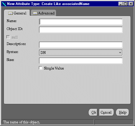

This section explains how to add, modify, and delete user-defined attributes. You need to understand attributes from a conceptual standpoint before attempting operations involving attributes.
In most cases, the attributes available in the base schema will suit the needs of your organization. However, if you decide to use an attribute not available in the base schema, you can add a new attribute, or modify an existing one.

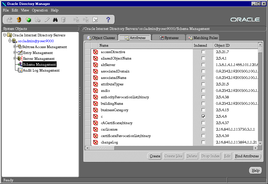

Managing Attributes by Using Oracle Directory Manager
Oracle Directory Manager allows you to manage attributes by performing tasks described in the following sections:
Searching for Attributes
To search for attributes by using Oracle Directory Manager:
  1. In the navigator pane, select Schema Management. The Schema Management tab pages appear in the right pane.
  2. Select the Attributes tab page:

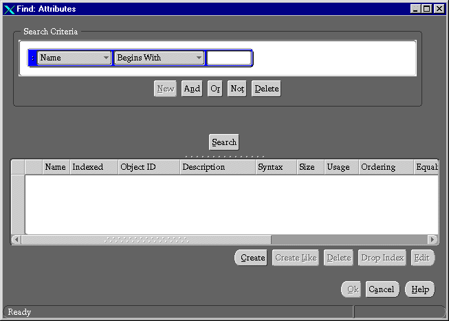

  3. Click the Find Attributes button in the lower right corner. The Find Attributes dialog box appears:
  4. In the menu at the left end of the search criteria bar, select the property of the attributes for which you want to search. Options are:
    Field  Description
    Name
    Name of the attribute for which you are searching
    Indexed
    List of indexed attributes
    Object ID
    Object Identifier for the attribute for which you are searching. For example, the phrase Object ID Begins With 2.5.2 gives you a list of attributes whose object identifiers begin with 2.5.2.

  5. In the text box at the right end of the search criteria bar, type part or all of the value of the attribute for which you want to search. For example, to search for all attributes whose names begin with the letters orcl, you would type those letters in the text box at the right end of the search criteria bar and create the phrase Name Begins With orcl.
  6. In the menu in the middle of the search criteria bar, select the filter you want to use for your search. Options are:
    Option  Description
    Begins With
    To search by using only the first few characters of the property's value. For example, the phrase Syntax Begins With 1.3 gives you a list of all attributes in which the first few numbers of the syntax identifier are 1.3.
    Ends With
    To search by using only the last few characters of the property's value. For example, the phrase Name Ends With License gives you a list of all attributes with that ending, such as carLicense.
    Contains
    To search for attributes that include the property with the value you enter. For example, the phrase Ordering Contains time gives you a list of all attributes with the word time in the Ordering column
    Exact Match
    To search for a value that is exactly the same as that found in the attribute property you specified. For example, the phrase Equality Exact Match caseIgnoreMatch gives you a list of all attributes that have the caseIgnoreMatch matching rule.
    Greater or Equal
    To search for an attribute that has a property that is numerically or alphabetically greater than or equal to the value you enter. For example, the phrase Name Greater or Equal orcl gives you a list of attributes from those beginning with orcl to those beginning with letters at the end of the alphabet.
    Less or Equal
    To search for an attribute that has a property that is numerically or alphabetically less than or equal to the value you enter. For example, the phrase Name Less or Equal orcl gives you a list of attributes from those beginning with orcl to those beginning with letters at the start of the alphabet.
    Not Null
    To search for all attributes in which the attribute property you selected is present. For example, the phrase Description Not Null gives you a list of all attributes which have text in the description field.
  7. Beneath the Search Criteria field are five buttons described in the table below. Use these buttons to further refine your search.
    Button  Description
    New
    Creates a new search criteria bar in the Search Criteria field. This button is enabled only when the Search Criteria field is empty.
    And
    Creates another search criteria bar in the Search Criteria field. Matches all attributes with one specified property with those that also have another specified property.
    Or
    Creates another search criteria bar in the Search Criteria field. Matches all attributes with either one specified property or another.
    Not
    Negates the criteria in the selected search criteria bar and matches all attributes that do not have the property specified.
    Delete
    Deletes a selected search criteria bar
  8. Click Search. The results of your search appear in the window at the lower portion of the Find: Attributes dialog box.

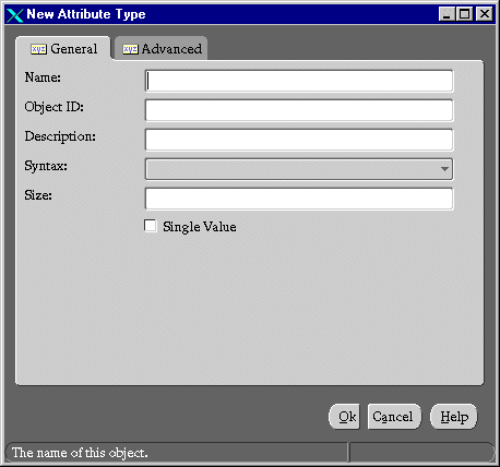

Adding an Attribute
You can use Oracle Directory Manager to add attributes as described in the following sections:
Adding a New Attribute
To add a new attribute by using Oracle Directory Manager:
  1. In the navigator pane, select the Schema Management tab.
  2. Choose one of the following methods:
    • In the right pane, select the Attributes tab, then click the Create button in the toolbar.
    • Select Create Attribute from the Operation menu.
    The New Attribute Type dialog box appears:
    This dialog box contains two tab pages--General and Advanced--with fields in which you enter values either by typing or selecting from menus.
  3. In the General tab, enter values in each of the fields as described in Table 6-3.
    Table 6-3 Fields for Adding Attributes in General Tab
    Field  Description
    Name
    Name for this attribute
    Object ID
    For an explanation of the standard identifiers, see the current LDAP standards available through the IETF website.
    Description
    This optional field is for your information only.
    Syntax
    The standardized rules for data entry applicable to this attribute type.
    Size
    Maximum size allowed for this object
    Single Value
    Selecting this check box indicates that this attribute type contains a maximum of one value.

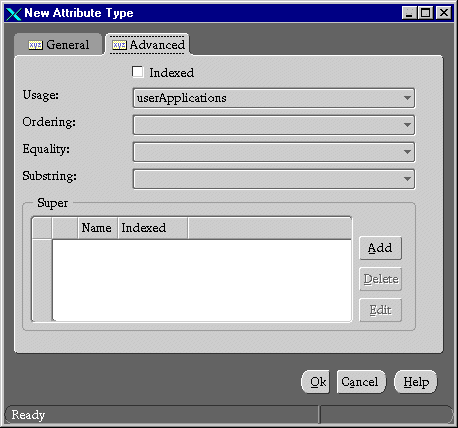

  4. Select the Advanced tab:
    In the Advanced tab page, enter values in each of the fields as described in Table 6-4.
    Table 6-4 Fields for Adding Attributes in Advanced Tab
    Field  Description
    Indexed
    Selecting the Indexed check box adds this attribute to the index, thereby making it available for use in a search. Only those attributes that have an equality matching rule can be indexed.
    Usage
    Standards specifying how the attribute can be used. Options are:
    • userApplications
      Attributes whose values must be entered by the user, for example, telephoneNumber
    • directoryOperation
      Attributes whose values are entered by the directory server, for example, creatorName or timeStamp
    • distributedOperation
    • dSAOperation
      Attributes used for the internal operation of the server, for example, orclUpdateSchedule
    Ordering
    Standards specifying how precedence is established for values
    Equality
    Standards specifying how equality is determined in compare and search operations
    Substring
    Used for regular expression matching
    Super
    Super attribute for this attribute. To add the super attribute, click the Add button next to this field. The Super Attribute Selector appears. Select the super attribute and click Select. Repeat as needed. To delete a super attribute from the Super field, select it, then click Delete.
  5. Click OK.

Adding an Attribute by Copying an Existing Attribute
To add an attribute by copying an existing attribute:
  1. In the navigator pane, select Schema Management. The right pane displays the tab pages you use to manage the schema.
  2. In the right pane, select the Attributes tab.
  3. In the Attributes tab page, select the attribute you want to copy.
  4. Click the Create Like button at the bottom of the right pane. The Attribute dialog box for that attribute appears:
  5. Select the General tab and enter values in each of the fields as described in Table 6-3. You must always change the DN to that of the new attribute.
  6. Select the Advanced tab and enter values in each of the fields as described in Table 6-4 .
  7. Click OK to save your changes.

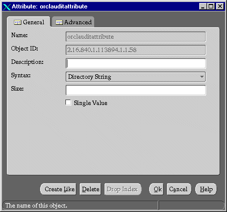

Modifying an Attribute
To modify an attribute by using Oracle Directory Manager:
  2. In the right pane, select the Attributes tab and double-click an editable attribute in the list. The Attribute dialog box displays properties of the selected attribute:
  3. Select the General tab and enter values in each of the fields as described in Table 6-3.
  4. Select the Advanced tab and enter values in each of the fields as described in Table 6-4 .
  5. Click OK.

Finding a Syntax Object ID
You can find a given syntax Object ID by using either Oracle Directory Manager or the ldapsearch command line tool.
Viewing Syntaxes by Using Oracle Directory Manager
To view syntaxes by using Oracle Directory Manager:
  2. In the right pane, select the Syntaxes tab:
Viewing Syntaxes by Using by Using ldapsearch
Use ldapsearch on the subentry cn=subSchemaSubentry.
