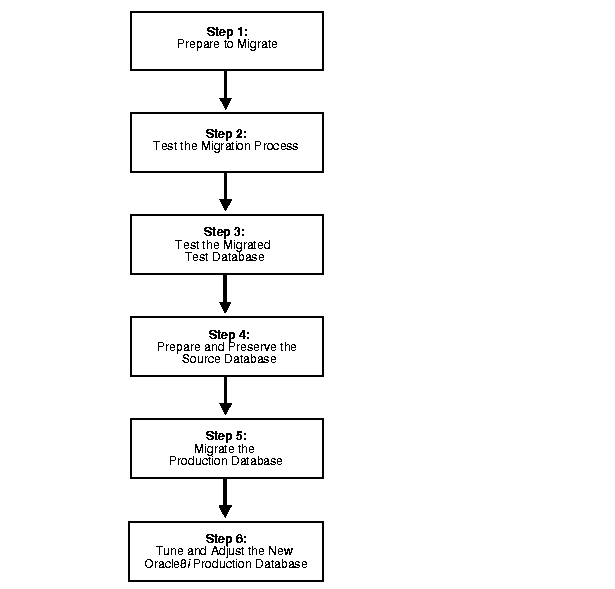

Figure 2-1 Major Migration Steps
Careful planning and use of Oracle8i tools can ease the process of migrating a database to Oracle8i. You can use one of the following migration methods to migrate your database:
The following sections contain a brief outline of the major steps shown in Figure 2-1. The purpose of these descriptions is to familiarize you with the major steps in the migration process. For detailed instructions, refer to the appropriate chapters and sections later in this book.
Step 1: Prepare to Migrate
Step 2: Test the Migration Process
Step 3: Test the Migrated Test Database
Chapter 3, "Preparing to Migrate", provides detailed information about Steps 1 through 3.
Step 4: Prepare and Preserve the Source Database
Step 5: Migrate the Production Database
Chapter 4 describes Steps 4 and 5 using the Migration utility; Chapter 5 describes Steps 4 and 5 using the Oracle Data Migration Assistant; and Chapter 6 describes Steps 4 and 5 using the Export/Import utilities. Chapter 8 describes the backup procedure after the migration and other post-migration tasks.

Step 6: Tune and Adjust the New Production Database
