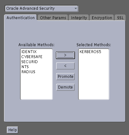

Perform the following steps to configure Kerberos authentication service parameters on the client and on the server:
The Oracle Advanced Security tabbed pages appear.

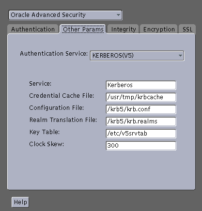

This field specifies the name of the service Oracle uses to obtain a Kerberos service ticket. Substitute a value for the kservice part of the service name.
The sqlnet.ora file updates with the following entries:
SQLNET.AUTHENTICATION_SERVICES=(KERBEROS5) SQLNET.AUTHENTICATION_KERBEROS5_SERVICE=kservice
