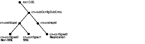

You may want to establish a separate instance of a directory server with different values. If you do not want those values to be exercised by all users, set up a new configuration set entry and run a separate server instance pointing to that configset for groups with special needs.
For example, Figure 5-1 shows:
configset0 with SSL set to off
configset1 with SSLenable set to on
configset0

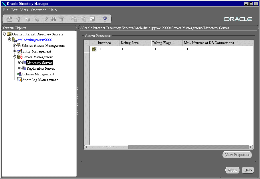

To view configuration set entries:
The parameters of the active instance appear in the right pane. You can see all of them by scrolling horizontally.
You can see all the parameters for the instance by selecting the tabs across the top of the dialog box. However, you cannot change them in this dialog box. To change them, you must change the configuration set entry on which they are based.

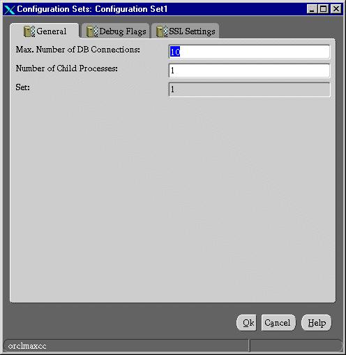

The first time you add a configuration set entry, you can use the default configuration set as a template, then copy from the ones you create to make subsequent configuration sets.
To add configuration set entries:

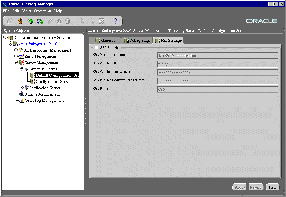

Table 5-1 Adding a Configuration Set Entry: General Tab
Ordinarily, you can leave these radio buttons unselected. However, if you need to generate a log for a specific problem, you can use this tab page to specify the debug logging level.
Fill in the fields with the information described in the following table:
| Field | Description |
SSL Enable |
Select to enable SSL authentication. If you do not select this check box, SSL is not enabled, and you do not need to set any other parameters on this page. |
SSL Authentication |
Choose one of the following:
SSL Wallet URL |
Enter the location of the SSL wallet. If you elect to change the location of the Oracle wallet, you must change this parameter. You must set the wallet location on both the client and the server. For example, on Solaris, you could set this parameter as follows: orclsslwalleturl=file:/Home/my_dir/my_wallet On Windows NT, you could set this parameter as follows: file:C:\my_dir\my_wallet For information on setting the location of the Oracle Wallet and the Oracle Wallet password, see Appendix D. |
SSL Wallet Password |
Enter the password for the wallet. This password was set during creation of the wallet. See "Creating a New Wallet". If you change the password, you must change this parameter. |
SSL Wallet Confirm Password |
Retype the new password in this field when you change the password. |
SSL Port |
The default SSL port is 636. You can change the SSL port. |
Remember, the changes will not affect the active instance until you restart it. See "Restarting Directory Server Instances".

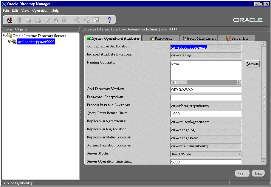

Operational attributes--as opposed to application attributes--pertain to the operation of the directory itself. Some operational information is specified by the directory to control the server--for example, the time stamp for an entry. Other operational information, such as access information, is defined by administrators and is used by the directory program in its processing.

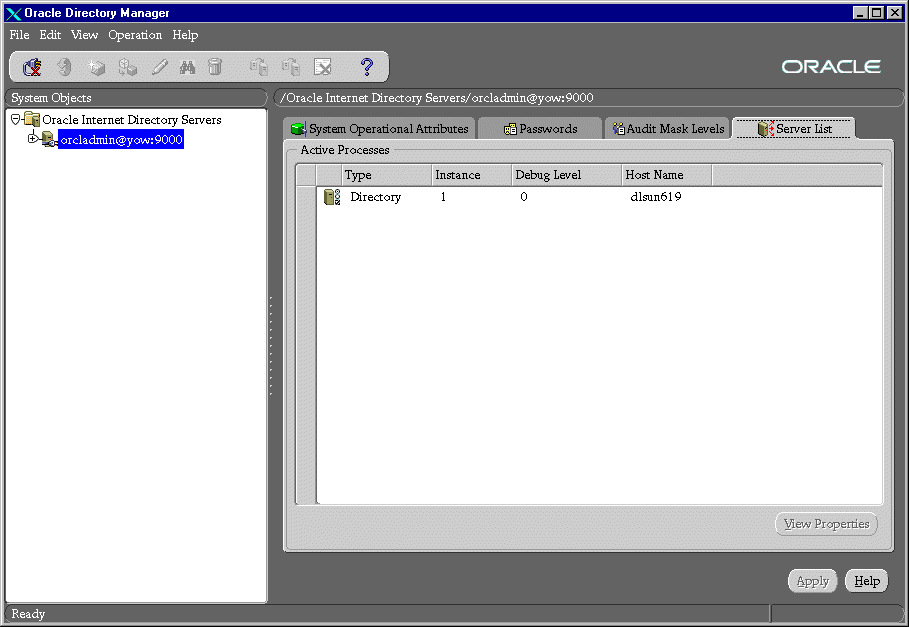

You can view and set some of the operational attributes for each Oracle Directory Server to which you are connected by using Oracle Directory Manager. To do this, in the navigator pane expand Oracle Internet Directory Servers, then select a server. System operational attributes appear in the right pane:
Table 5-3 describes the field for each operational attribute.
The modifiable system operational attributes are:

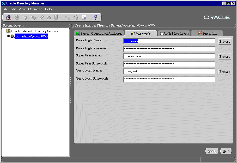

You can administer user names and passwords for the super, guest, and proxy users by using either Oracle Directory Manager or ldapmodify.
This section covers topics in the following subsections:
To change a user name or password for a super, guest, or proxy user by using Oracle Directory Manager:
Table 5-1 lists and describes the fields in the Passwords tab page.
Super User Name |
The default is |
Super User Password |
The default is |
Guest Login Name |
Guests have privileges determined by the Access Control Policy Points (ACPs) in the directory. The default is |
Guest Login Password |
The default is |
Proxy Login Name |
Proxy users have privileges determined by the ACPs in the directory. The default is |
Proxy Login Password |
The default is |

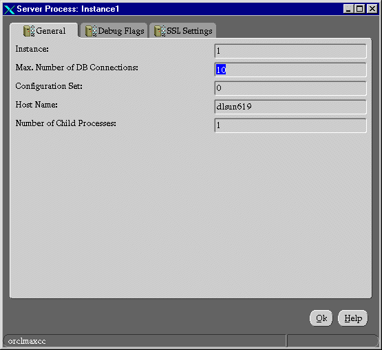

You can use Oracle Directory Manager to view information about any active server instance. To do this:

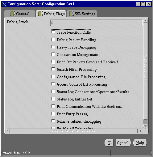

This section tells you how to set debug logging levels by using the OID Control Utility. You can also set debug logging levels by using Oracle Directory Manager as described in "Managing Server Configuration Set Entries by Using Oracle Directory Manager".
To set debug logging levels by using the OID Control Utility, restart the Oracle Directory Server using the -debug option for an LDAP server, and the -d flag for the replication server. Use the debug level number based on Table 5-5.
Since debug levels are additive, you need to sum together the numbers representing the functions that you want to activate, and use that sum in the command line option.
For example, if you want to trace function calls (1) and active connection management (8), you would enter 9 as the debug level (8 + 1 = 9) as follows:
oidctl server=oidldapd instance=1 flags='-debug 9' restart oidctl server=oidrepld instance=1 flags='-h my_host -p 389 -d 9' restart
The above example restarts the LDAP server as well as the replication server with the debugging flags. Table 5-5 provides the complete list of debug logging levels.

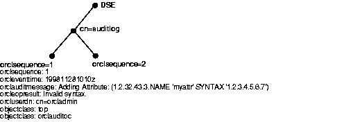

Each audit log entry contains the orclAuditoc object class. Like all other structural object classes, orclAuditoc inherits from top. Its attributes include the following:
Note that the audit log entries do not become part of a regular search result set even though the search filter may satisfy the query criteria. For example, a search with the condition objectclass=top will not yield results from the auditlog entries. Only a search with cn=auditlog as the base of the search will find audit log entries.
By default, the attributes |
The audit log container is part of the DSE. It holds its entries as children, organized according to the orclsequence attribute. See Figure 5-2.

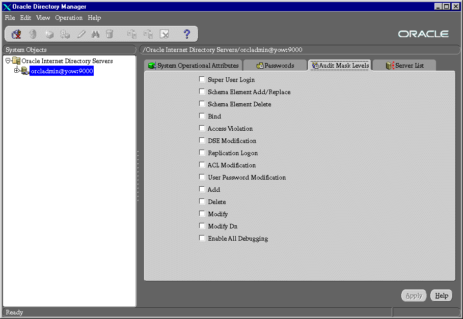

Events described in the previous section can be turned on or off. DSE attribute orclauditlevel indicates the current audit level set on the server. A value of 0 for the attribute means no auditing, which is the default.
You can set the audit level by using either Oracle Directory Manager or ldapmodify. Both methods are described in this section.
To set the audit level by using Oracle Directory Manager:
To audit more than one event, add the values of their the audit masks. For example, suppose you want to audit the following three events:
Schema element delete |
0x0004 |
4 |
DSE modification |
0x0020 |
32 |
Add |
0x0200 |
512 |
548 |
The total value of the audit masks is 548. The ldapmodify command would therefore look something like the following:
ldapmodify -p port -h host << EOF dn: changetype:modify replace: orclauditlevel orclauditlevel: 548 EOF
Restart the server after any changes are made to orclauditlevel for the changes to take effect.
