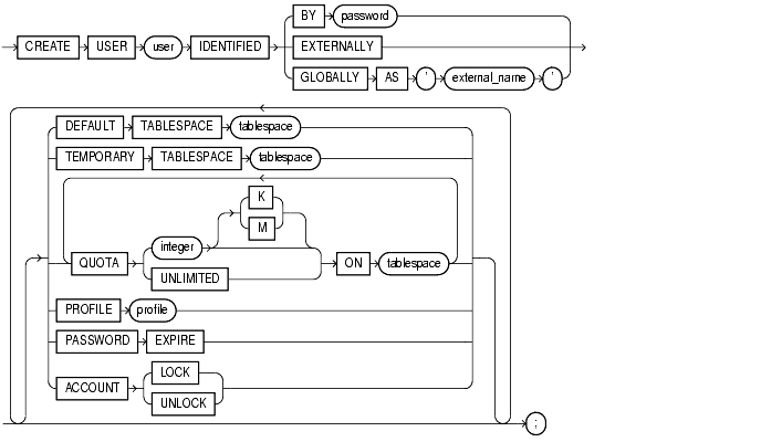

Syntax

user
is the name of the user to be created. This name can contain only characters from your database character set and must follow the rules described in the section "Schema Object Naming Rules". Oracle recommends that the user name contain at least one single-byte character regardless of whether the database character set also contains multi-byte characters.
IDENTIFIED
indicates how Oracle authenticates the user.
See Also: Oracle8i Application Developer's Guide - Fundamentals and your operating system specific documentation for more information.
BY password
creates a local user and indicates that the user must specify password to log on. Passwords can contain only single-byte characters from your database character set regardless of whether this character set also contains multibyte characters.
Passwords must follow the rules described in the section "Schema Object Naming Rules", unless you are using Oracle's password complexity verification routine. That routine requires a more complex combination of characters than the normal naming rules permit. You implement this routine with the UTLPWDMG.SQL script, which is further described in Oracle8i Administrator's Guide.
See Also: Oracle8i Administrator's Guide to for a detailed description and explanation of how to use password management and protection.
EXTERNALLY
creates an external user and indicates that a user must be authenticated by an external service (such as an operating system or a third-party service). Doing so causes Oracle to rely on the login authentication of the operating system to ensure that a specific operating system user has access to a specific database user.
WARNING: Oracle strongly recommends that you do not use IDENTIFIED EXTERNALLY with operating systems that have inherently weak login security. For more information, see Oracle8i Administrator's Guide.
GLOBALLY AS 'external_name'
creates a global user and indicates that a user must be authenticated by the enterprise directory service. The 'external_name' string can take one of two forms:
  • The X.509 name at the enterprise directory service that identifies this user. It should be of the form 'CN=username,other_attributes', where other_attributes is the rest of the user's distinguished name (DN) in the directory.
  • A null string (' ') indicating that the enterprise directory service will map authenticated global users to the appropriate database schema with the appropriate roles.
See Also: Oracle Advanced Security Administrator's Guide for more information on global users.
Note: You can control the ability of an application server to connect as the specified user and to activate that user's roles using the ALTER USER statement.
See Also: "ALTER USER"
DEFAULT TABLESPACE
identifies the default tablespace for objects that the user creates. If you omit this clause, objects default to the SYSTEM tablespace.
See Also: "CREATE TABLESPACE" for more information on tablespaces.
TEMPORARY TABLESPACE
identifies the tablespace for the user's temporary segments. If you omit this clause, temporary segments default to the SYSTEM tablespace.
QUOTA
allows the user to allocate space in the tablespace and optionally establishes a quota of integer bytes. Use K or M to specify the quota in kilobytes or megabytes. This quota is the maximum space in the tablespace the user can allocate.
A CREATE USER statement can have multiple QUOTA clauses for multiple tablespaces.
UNLIMITED allows the user to allocate space in the tablespace without bound.
PROFILE
reassigns the profile named to the user. The profile limits the amount of database resources the user can use. If you omit this clause, Oracle assigns the DEFAULT profile to the user.
See Also: "GRANT system_privileges_and_roles" and "CREATE PROFILE".
PASSWORD EXPIRE
causes the user's password to expire. This setting forces the user (or the DBA) to change the password before the user can log in to the database.
ACCOUNT LOCK
locks the user's account and disables access.
ACCOUNT UNLOCK
unlocks the user's account and enables access to the account.
