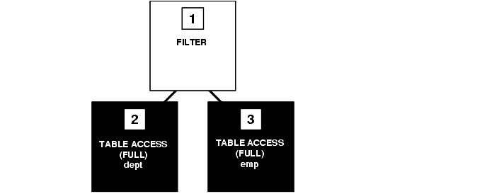

This example shows the execution plans for two SQL statements that perform the same function. Both statements return all the departments in the dept table that have no employees in the emp table. Each statement searches the emp table with a subquery. Assume there is an index, deptno_index, on the deptno column of the emp table.
The first statement and its execution plan:
SELECT dname, deptno
   FROM dept
   WHERE deptno NOT IN
      (SELECT deptno FROM emp);
Figure 9-1 Execution Plan with Two Full Table Scans
Step 3 of the output indicates that Oracle executes this statement by performing a full table scan of the emp table despite the index on the deptno column. This full table scan can be a time-consuming operation. Oracle does not use the index, because the subquery that searches the emp table does not have a WHERE clause that makes the index available.

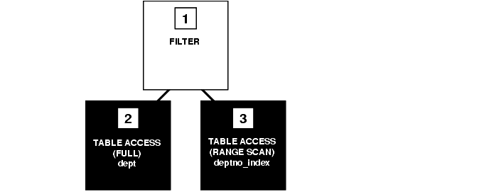

However, this SQL statement selects the same rows by accessing the index:
FROM dept
WHERE NOT EXISTS
(SELECT deptno
FROM emp
WHERE dept.deptno = emp.deptno);
Figure 9-2 Execution Plan with a Full Table Scan and an Index Scan
The WHERE clause of the subquery refers to the deptno column of the emp table, so the index deptno_index is used. The use of the index is reflected in step 3 of the execution plan. The index range scan of deptno_index takes less time than the full scan of the emp table in the first statement. Furthermore, the first query performs one full scan of the emp table for every deptno in the dept table. For these reasons, the second SQL statement is faster than the first.
If you have statements in your applications that use the NOT IN operator, as the first query in this example does, then you should consider rewriting them so that they use the NOT EXISTS operator. This would allow such statements to use an index, if one exists.
