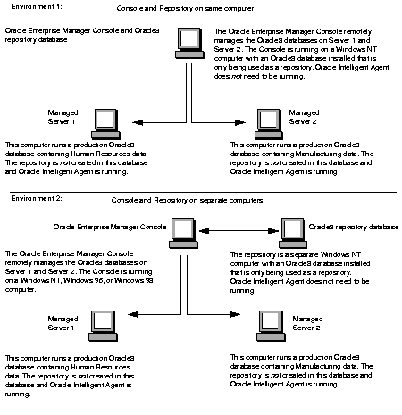

Before describing how to configure Oracle Enterprise Manager, the key components are briefly described.
Oracle Enterprise Manager Console
Oracle Enterprise Manager works with Oracle Intelligent Agent (installed in the Oracle8 database to be managed) to perform remote database management from a single console computer. Oracle Enterprise Manager is installed on a console computer, a Windows NT or Windows 95 client.
Oracle Intelligent Agent and Managed Oracle8 Databases
Oracle Intelligent Agent runs on the Oracle8 database to be managed. This Oracle8 database is the one you use for your production work. Oracle Intelligent Agent manages and completes tasks on the Oracle8 database that are requested from the Oracle Enterprise Manager Console computer. Oracle Intelligent Agent:
Oracle8 Repository Database
The Oracle Enterprise Manager Console uses an Oracle8 database as a repository for storing key configuration information. The Oracle8 repository database can be installed on:
The sole responsibility of the repository database is to act as the Oracle Enterprise Manager's storage resource. The Oracle8 repository database is:
Do not create a repository and a production database in the same Oracle8 database. If you do, you will not be able to perform many database administration tasks, such as starting or shutting down the database.
Set up your Oracle Enterprise Manager Console, managed Oracle8 database(s), and Oracle8 repository environment in either of two ways:

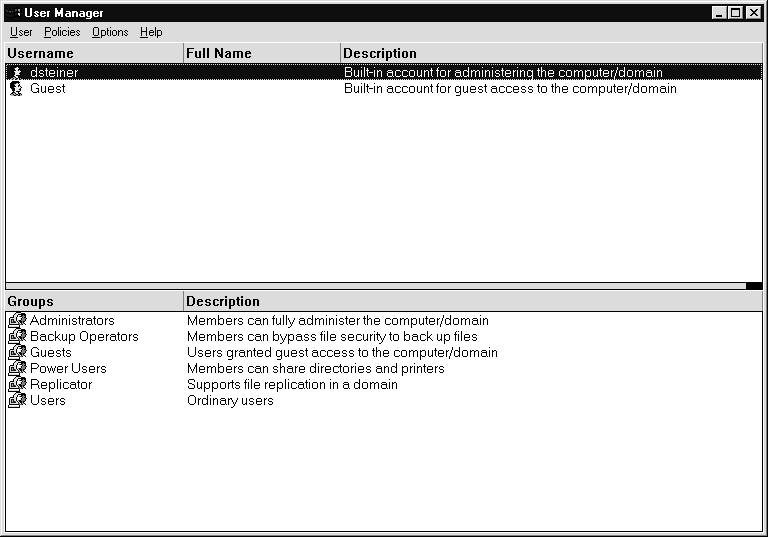

  2. Choose Start > Programs > Administrative Tools > User Manager.
    The User Manager window appears:

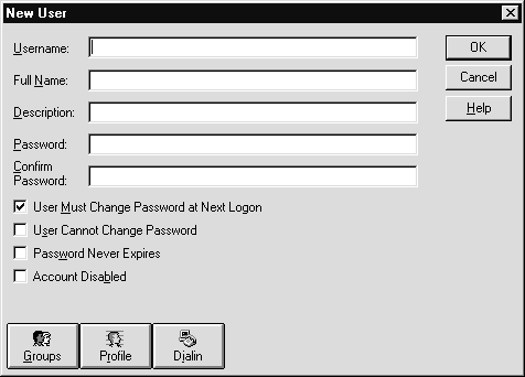

  3. Choose New User from the User menu.
    The New User dialog box appears:
  4. Enter the appropriate information in the dialog box:
    1. Enter a user name in the Username field.
    2. Enter the same password in both the Password and Confirm Password fields.
      The user name and password that you enter here do not need to match those that you created in "Step 2: Create a Repository User Account".
    3. Make sure the User Must Change Password at Next Logon check box is not checked and Password Never Expires check box is checked.

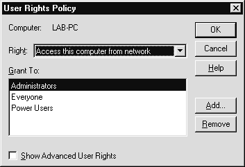

  6. Select the newly created user and choose User Rights from the Policies menu.
    The User Rights Policy dialog box appears:
  7. Click the Show Advanced User Rights check box and select Log on as a batch job from the Right drop-down list box.
  8. Select Users from the Grant To list box.

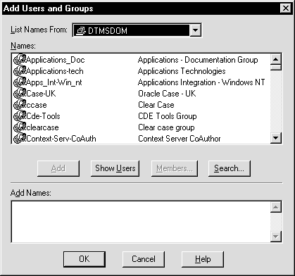

    If Users does not exist, create it:
    1. Click Add.
      The Add Users and Groups dialog box appears:
    2. Select the name of the local host computer from the List Names From drop-down list box.
    3. Select Users from the Names list box and click Add.
    4. Click OK.
      Users appears in the Grant To list box.
  9. Click OK in the User Rights Policy dialog box.
    The User Manager window reappears.

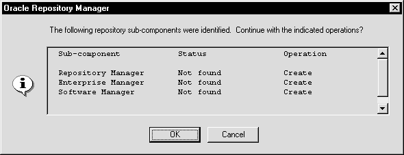

    The Oracle Repository Manager window appears, prompting you to build the repository:
  4. Click OK.
    The repository is built. A dialog box asking if you want a quick tour of Oracle Enterprise Manger appears.

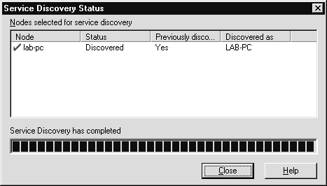

  6. Follow the wizard instructions to discover services.
    Services are discovered when you see the dialog box below with a status of Discovered:
    If the services are not discovered, click Help for troubleshooting hints. The wizard can be restarted by selecting Service Discovery under Navigator in the main menu.
  7. Click Close.

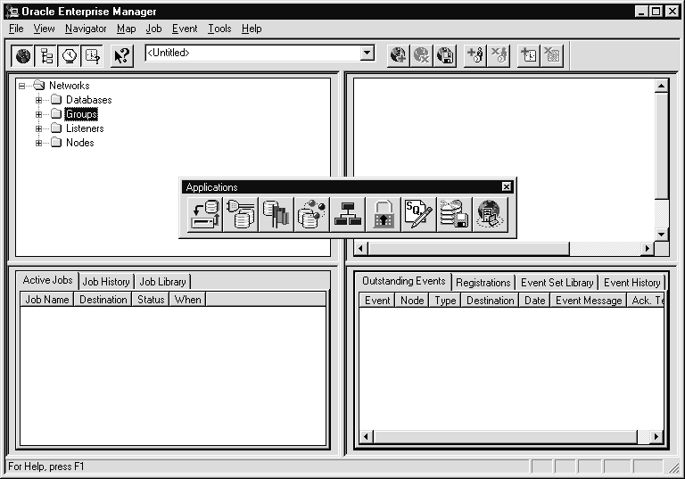

    The Oracle Enterprise Manager Console appears:
Configuration is complete. Oracle Enterprise Manager is now available for use.
