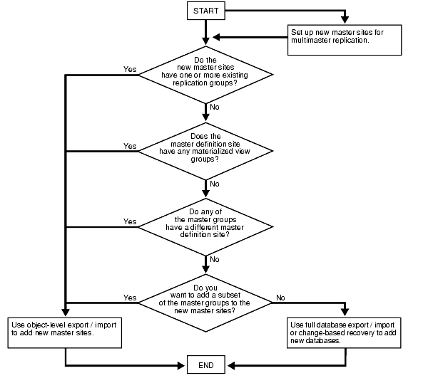

This section contains procedures for adding new master sites to an existing master group that is not quiesced. These new sites might or might not already be replication sites (master sites or materialized view sites) in other replication groups.
You can use one of the following methods when you are adding a new master site without quiescing the master group:
Use full database export/import or change-based recovery to add a new master site that does not currently have any replication groups. See "Using Full Database Export/Import or Change-Based Recovery" for instructions.
Use object-level export/import to add a new master site that already has other replication groups or to add a new master site that does not currently have any replication groups. See "Using Object-Level Export/Import" for instructions.
Use full database export/import and change-based recovery to add all of the replication groups at the master definition site to the new master sites. When you use this method, the following conditions apply:
The new master sites cannot have any existing replication groups.
The master definition site cannot have any materialized view groups.
The master definition site must be the same for all of the master groups. If one or more of these master groups have a different master definition site, then do not use full database export/import or change-based recovery. Use object-level export/import instead.
The new master site must include all of the replication groups in the master definition site when the extension process is complete. That is, you cannot add a subset of the master groups at the master definition site to the new master site. All of the groups must be added.
If your environment does not meet all of these conditions, then you must use object-level export/import to add the new master sites. Figure 7-1 summarizes these conditions.
To use change-based recovery, the existing master site and the new master site must be running under the same operating system, although the release of the operating system can differ. This condition does not apply to full database export/import.
You can use either Data Pump export/import or original export/import to perform exports and imports in an Advanced Replication environment. General references to export/import in this document refer to both Data Pump and original export/import.
Figure 7-1 Determining Which Method to Use When Adding Master Sites

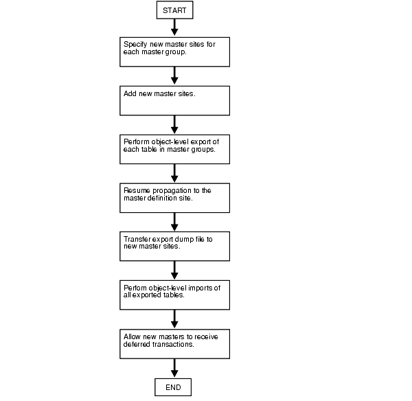

Use object-level export/import to add a master group to master sites that already have other replication groups or to add a master group to master sites that do not currently have any replication groups. This method can add one or more master groups to new master sites at a time, and you can choose a subset of the master groups at the master definition site to add to the new master sites during the operation.
If you use object-level export/import and there are integrity constraints that span more than one master group, then you must temporarily disable these integrity constraints on the table being added to a new master site, if the other tables to which these constraints refer already exist at the new master site. Initially, there are two rows in the DEFSCHEDULE
data dictionary view that refer to the new master sites. When propagation is caught up, there is one row in this view, and when propagation from all the master sites to the new master site is caught up, you can reenable the integrity constraints you disabled.

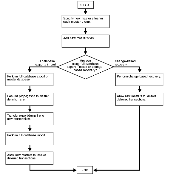

Figure 7-2 shows the major steps for using full database export/import or change-based recovery to add new master sites to a master group without quiescing. The following example script adds the new master sites orc4.world
and orc5.world
to the hr_repg
master group. In this example, orc4.world
is added using full database export/import and orc5.world
is added using change-based recovery.
Figure 7-2 Using Full Database Export/Import or Change-Based Recovery

Complete the following steps to use full database export/import or change-based recovery to add sites to a master group.
If you are viewing this document online, then you can copy the text from the "BEGINNING OF SCRIPT" line after this note to the "END OF SCRIPT" line into a text editor and then edit the text to create a script for your environment./************************* BEGINNING OF SCRIPT ******************************

On a command line, perform the export. This example connects as the SYSTEM
user. The following is an example Data Pump export command:
expdp system/manager FULL=y DIRECTORY=DPUMP_DIR DUMPFILE=fulldb_orc1.dmp FLASHBACK_SCN=124723
Consider the following when you run the Export utility:
Only users with the DBA
role or the EXP_FULL_DATABASE
role can export in full database mode.
Make sure the UNDO_RETENTION
initialization parameter is set correctly before performing the export.
If you use the original Export utility, then do not use the CONSISTENT
export parameter. This parameter does not apply to Data Pump.
See Also:
Oracle Database Utilities for information about performing a Data Pump export
Oracle Database Administrator's Guide for information about managing undo space and setting this parameter
*/ PAUSE Press <RETURN> to continue when the export is complete. /*
Resume propagation to the master definition site.
Running the following procedure indicates that export is effectively finished and propagation can be enabled for both extended and unaffected master groups at the master sites.
*/ BEGIN DBMS_REPCAT.RESUME_PROPAGATION_TO_MDEF ( extension_id => :extension_id); END; / /*
You can find the extension_id
by querying the DBA_REPSITES_NEW
data dictionary view.
Transfer the export dump file to the new master sites.
Using the DBMS_FILE_TRANSFER
package, FTP, or some other method, transfer the export dump file to the other new master sites that are being added with full database export/import. You will need this export dump file at each new site to perform the import described in the next step.
*/ PAUSE Press <RETURN> to continue after transferring the dump file. /*
Set the JOB_QUEUE_PROCESSES
initialization parameter to zero for each new master site.
*/ PAUSE Press <RETURN> to continue after JOB_QUEUE_PROCESSES is set to zero at each new master site. /*
Step 8 Perform import or change-based recovery at each new master site.
If you are using full database export/import, then complete the full database import of the database you exported in Step 7 at each new master site that is being added with full database export/import.
Perform the import. This example connects as the SYSTEM
user to perform the import at orc4.world
. The following is an example import command:
impdp system/manager FULL=y DIRECTORY=DPUMP_DIR DUMPFILE=fulldb_orc1.dmp
role or the IMP_FULL_DATABASE
role can import in full database mode.
See Also:
Oracle Database Utilities for information about performing a Data Pump import*/ PAUSE Press <RETURN> to continue when the import is complete. /*
If you are using change-based recovery, then perform change-based recovery using the system change number (SCN) returned by the masterdef_flashback_scn
parameter in Step 5. You can query the DBA_REPEXTENSIONS
data dictionary view for the masterdef_flashback_scn
value.
You can perform a change-based recovery in one of the following ways:
Using the SQL*Plus RECOVER
command. See the Oracle Database Backup and Recovery Advanced User's Guide for instructions.
Using the Recovery Manager (RMAN) DUPLICATE
Connect to the site where you will perform the change-based recovery:
*/ CONNECT repadmin/repadmin@orc5.world PAUSE Press <RETURN> to continue when the change-based recovery is complete. You can use a separate terminal window to perform the change-based recovery. /*
Step 9 Configure the new sites for multimaster replication by completing the following steps:
Ensure that the database structures, such as the datafiles, exist for the replicated schemas at each new master site. In this example, the replicated schema is hr
Set the global name for each new master site. The global name for each new master site must match the global names specified in the SPECIFY_NEW_MASTERS
procedure that you ran in Step 4. You can query the DBLINK
column in the DBA_REPSITES_NEW
data dictionary view to see the global name for each new master site.
You can set the global name using the ALTER
DATABASE
statement, as in the following example:
ALTER DATABASE RENAME GLOBAL_NAME TO orc4.world;
Create the appropriate scheduled links between the new master sites and the existing master sites, including the master definition site.
See Also:
"Creating Scheduled Links Between the Master Sites" for information*/ PAUSE Press <RETURN> when you have completed the these steps. /*
Step 10 Allow new masters to receive deferred transactions.
The following procedure enables the propagation of deferred transactions from other prepared new master sites and existing master sites to the invocation master site. This procedure also enables the propagation of deferred transactions from the invocation master site to the other new master sites and existing master sites.
Caution:
Do not invoke this procedure until instantiation (export/import or change-based recovery) of the new master site is complete.Do not allow any data manipulation language (DML) statements directly on the objects in the extended master group in the new master site until execution of this procedure returns successfully, because these DML statements might not be replicated.
*/ CONNECT repadmin/repadmin@orc4.world BEGIN DBMS_REPCAT.PREPARE_INSTANTIATED_MASTER ( extension_id => :extension_id); END; / CONNECT repadmin/repadmin@orc5.world BEGIN DBMS_REPCAT.PREPARE_INSTANTIATED_MASTER ( extension_id => :extension_id); END; / SET ECHO OFF SPOOL OFF /*
You can find theextension_id
data dictionary view.************************** END OF SCRIPT **********************************/
Figure 7-3 shows the major steps for using object-level export/import to add new master sites to a master group without quiescing. The following example procedure adds the new master sites orc4.world
and orc5.world
to the hr_repg
master group. An object-level export/import involves exporting and importing the tables in a master group. When you export and import the tables, other dependent database objects, such as indexes, are exported and imported as well.
If you have an integrity constraint that spans two master groups, then you have a child table in one master group (the child master group) and a parent table in a different master group (the parent master group). In this case, Oracle recommends that you add new master sites to both master groups at the same time. However, if you cannot do this, then you must quiesce the child master group before adding new master sites to it. Here, the child table includes a foreign key, which makes it dependent on the values in the parent table. If you do not quiesce the child master group, then conflicts might result when you add master sites to it. You can still add master sites to the parent master group without quiescing it.
Figure 7-3 Using Object-Level Export/Import
Meet the following requirements to complete these actions:
Executed As: Replication Administrator, unless specified otherwise
Executed At:
Step 7 at the Master Definition Site and at Each New Master Site
Step 10 requires a file transfer between sites.
Replication Status: Running Normally (Not Quiesced)
Complete the following steps to use object-level export/import to add sites to a master group.
Step 1 If the users for the replicated schemas do not exist at the new master sites, then create them now.
. This schema probably already exist at the new master sites because it is a sample schema that is installed when you install Oracle.
See Also:
Oracle Database Sample Schemas for general information about the sample schemas and for information about installing them*/ SET ECHO ON SPOOL add_masters_object.out PAUSE Press <RETURN> to continue when the users are created at the new master sites. /*
Step 2 If any of the tables in the master group have circular dependencies, then precreate these tables at the new master sites.
Failure to precreate these tables will result in errors later in the procedure. If there are no circular dependencies, then this step is not required, and you can proceed to Step 3.
Some of the tables in the hr
schema contain circular dependencies. Therefore, in this example, the tables in the hr
schema must be precreated at each new master site. Again, the hr
schema tables are typically created during Oracle installation and so might already exist at the new master sites.
If you need to precreate tables, then disable referential integrity constraints for these tables at the new master sites before the import. Referential integrity constraints can cause errors when you import data into existing tables. This example disables the referential integrity constraints for the precreated tables in the hr
schema at the new master sites.
Further, the precreated tables at the new master sites should not contain any data. This example truncates the tables in the hr
schema at the new master sites to ensure that they do not contain any data.
See Also:
The note under "Adding New Master Sites" for more information about circular dependencies
Oracle Database Utilities for information about importing data into existing tables
*/ PAUSE Press <RETURN> to continue when the tables are precreated at the new master sites, if table precreation is required. After the tables are precreated, the following statements disable the referential integrity constraints related to the hr schema and truncate the tables in the hr schema at the new site. CONNECT oe/oe@orc4.world ALTER TABLE oe.warehouses DISABLE CONSTRAINT warehouses_location_fk; ALTER TABLE oe.customers DISABLE CONSTRAINT customers_account_manager_fk; ALTER TABLE oe.orders DISABLE CONSTRAINT orders_sales_rep_fk; CONNECT hr/hr@orc4.world ALTER TABLE hr.countries DISABLE CONSTRAINT countr_reg_fk; ALTER TABLE hr.departments DISABLE CONSTRAINT dept_mgr_fk DISABLE CONSTRAINT dept_loc_fk; ALTER TABLE hr.employees DISABLE CONSTRAINT emp_dept_fk DISABLE CONSTRAINT emp_job_fk DISABLE CONSTRAINT emp_manager_fk; ALTER TABLE hr.job_history DISABLE CONSTRAINT jhist_job_fk DISABLE CONSTRAINT jhist_emp_fk DISABLE CONSTRAINT jhist_dept_fk; ALTER TABLE hr.locations DISABLE CONSTRAINT loc_c_id_fk; TRUNCATE TABLE hr.countries; TRUNCATE TABLE hr.departments; TRUNCATE TABLE hr.employees; TRUNCATE TABLE hr.jobs; TRUNCATE TABLE hr.job_history; TRUNCATE TABLE hr.locations; TRUNCATE TABLE hr.regions; CONNECT oe/oe@orc5.world ALTER TABLE oe.warehouses DISABLE CONSTRAINT warehouses_location_fk; ALTER TABLE oe.customers DISABLE CONSTRAINT customers_account_manager_fk; ALTER TABLE oe.orders DISABLE CONSTRAINT orders_sales_rep_fk; CONNECT hr/hr@orc5.world ALTER TABLE hr.countries DISABLE CONSTRAINT countr_reg_fk; ALTER TABLE hr.departments DISABLE CONSTRAINT dept_mgr_fk DISABLE CONSTRAINT dept_loc_fk; ALTER TABLE hr.employees DISABLE CONSTRAINT emp_dept_fk DISABLE CONSTRAINT emp_job_fk DISABLE CONSTRAINT emp_manager_fk; ALTER TABLE hr.job_history DISABLE CONSTRAINT jhist_job_fk DISABLE CONSTRAINT jhist_emp_fk DISABLE CONSTRAINT jhist_dept_fk; ALTER TABLE hr.locations DISABLE CONSTRAINT loc_c_id_fk; TRUNCATE TABLE hr.countries; TRUNCATE TABLE hr.departments; TRUNCATE TABLE hr.employees; TRUNCATE TABLE hr.jobs; TRUNCATE TABLE hr.job_history; TRUNCATE TABLE hr.locations; TRUNCATE TABLE hr.regions; /*
Step 3 Set up each new master site as a replication site.
Remember that you need to configure the following:
The replication administrator at each new master site
A scheduled link from each existing master site to each new master site
A scheduled link from each new master site to each existing master site
A schedule purge job at each new master site
*/ PAUSE Press <RETURN> to continue the new master sites have been setup and the required scheduled links have been created. /*
See Also:
Oracle Database Advanced Replication for information about scheduled links
Step 4 Connect to the master definition site as the replication administrator.
CONNECT repadmin/repadmin@orc1.world /*
Step 5 Specify new master sites for each master group.
BEGIN DBMS_REPCAT.SPECIFY_NEW_MASTERS ( gname => 'hr_repg', master_list => 'orc4.world,orc5.world'); END; / /*
You can begin to track the extension process by querying the following data dictionary views in another SQL*Plus session:
DBA_REPSITES_NEW
DBA_REPEXTENSIONS
Step 6 Add the new master sites.
Before running the following procedure, ensure that there are an adequate number of background jobs running at each new master site. Also, make sure there is enough space in your rollback segments or undo tablespace for the export before you run this procedure.
See Also:
Oracle Database Advanced Replication for information about setting the JOB_QUEUE_PROCESSES
initialization parameter properly for a replication environment
*/ VARIABLE masterdef_flashback_scn NUMBER; VARIABLE extension_id VARCHAR2(32); BEGIN DBMS_REPCAT.ADD_NEW_MASTERS ( export_required => true, available_master_list => 'orc4.world,orc5.world', masterdef_flashback_scn => :masterdef_flashback_scn, extension_id => :extension_id, break_trans_to_masterdef => false, break_trans_to_new_masters => false, percentage_for_catchup_mdef => 80, cycle_seconds_mdef => 60, percentage_for_catchup_new => 80, cycle_seconds_new => 60); END; / /*
The sites specified for the available_master_list
parameter must be same as the sites specified in the SPECIFY_NEW_MASTERS
procedure in Step 5.
The values for masterdef_flashback_scn
and extension_id
are saved into variables to be used later in the process. To see these values, you can also query the DBA_REPSITES_NEW
and DBA_REPEXTENSIONS
data dictionary views.
If you need to undo the changes made to a particular master site by the SPECIFY_NEW_MASTERS
and ADD_NEW_MASTERS
procedures, then use the UNDO_ADD_NEW_MASTERS_REQUEST
procedure.
After successfully executing this procedure, monitor its progress by querying the DBA_REPCATLOG
data dictionary view in another SQL*Plus session. Do not proceed to Step 8 until there is no remaining information in this view about adding the new master sites. Assuming there is no extraneous information in DBA_REPCATLOG
from other operations, you can enter the following statement:
SELECT COUNT(*) FROM DBA_REPCATLOG;
All of the processing is complete when this statement returns zero (0).
*/ PAUSE Press <RETURN> to continue when DBA_REPCATLOG is empty. /*
Step 7 Create a directory object at each database.
Each database involved in this operation must have a directory object to hold the Data Pump dump file, and the user who will perform the export or import must have READ
and WRITE
privileges on this directory object. In this example, a Data Pump export is performed at the master definition site, and a Data Pump import is performed at each new master site.
While connected in SQL*Plus to the a database as an administrative user who can create directory objects using the SQL statement CREATE
DIRECTORY
, create a directory object to hold the Data Pump dump file and log files. For example:
*/ CONNECT SYSTEM/MANAGER@orc1.world CREATE DIRECTORY DPUMP_DIR AS '/usr/dpump_dir'; CONNECT SYSTEM/MANAGER@orc4.world CREATE DIRECTORY DPUMP_DIR AS '/usr/dpump_dir'; CONNECT SYSTEM/MANAGER@orc5.world CREATE DIRECTORY DPUMP_DIR AS '/usr/dpump_dir'; /*
In this example, SYSTEM
user performs all exports and imports. If a user other than the user who created the directory object will perform the export or import, then grant this user READ
and WRITE
privileges on the directory object.
Make sure you complete these actions at each database involved in the operation.
Step 8 Perform object-level export of tables at master definition database.
At the master definition database, perform an object-level export for each master table in the master groups that will be created at the new master sites. An object-level export includes exports performed in table mode, user mode, or tablespace mode.
Use the system change number (SCN) returned by the masterdef_flashback_scn
parameter in Step 6 for the FLASHBACK_SCN
export parameter. You can query the DBA_REPEXTENSIONS
data dictionary view for the FLASHBACK_SCN
value:
SELECT FLASHBACK_SCN FROM DBA_REPEXTENSIONS;
In this example, assume that the SCN value is 3456871
expdp system/manager TABLES=HR.COUNTRIES,HR.DEPARTMENTS,HR.EMPLOYEES, HR.JOB_HISTORY,HR.JOBS,HR.LOCATIONS,HR.REGIONS DIRECTORY=DPUMP_DIR DUMPFILE=hr_tables.dmp CONTENT=data_only FLASHBACK_SCN=3456871
The CONTENT
parameter is used in this example because the tables already exist at the import sites. You might not need to specify this parameter.
Consider the following when you run perform the export:
See Also:
Oracle Database Administrator's Guide for information about managing undo space and setting the UNDO_RETENTION
Step 9 Resume propagation to the master definition site.
*/ CONNECT repadmin/repadmin@orc1.world BEGIN DBMS_REPCAT.RESUME_PROPAGATION_TO_MDEF ( extension_id => :extension_id); END; / /*
Step 10 Transfer the export dump files to the new master sites.
package, FTP, or some other method, transfer the export dump files to the other new master sites that are being added with object-level export/import. You will need these export dump files at each new site to perform the import described in the next step.
*/ PAUSE Press <RETURN> to continue when the export dump files have been transfered to the new master sites that are being added with object-level export/import. /*
Step 11 Perform object-level imports at each new master site of each object you exported in Step 8.
On a command line, perform the import. This example connects as the SYSTEM
user. The following is an example import command:
impdp system/manager TABLES=HR.COUNTRIES,HR.DEPARTMENTS,HR.EMPLOYEES, HR.JOB_HISTORY,HR.JOBS,HR.LOCATIONS,HR.REGIONS DIRECTORY=DPUMP_DIR DUMPFILE=hr_tables.dmp CONTENT=data_only TABLE_EXISTS_ACTION=append
Other objects, such as the indexes based on the tables, are imported automatically. The CONTENT
and TABLE_EXISTS_ACTION
parameters are used in this example because the tables already exist at the import sites. You might not need to specify these parameters.
See Also:
Oracle Database Utilities for information about performing a Data Pump importPerform the object-level imports at each site:
*/ PAUSE Press <RETURN> to continue when the imports are complete at each site. You can use a separate terminal window to perform the object-level imports. /*
Step 12 Allow new masters to receive deferred transactions.
Caution:
Do not invoke this procedure until object-level export/import for the new master site is complete.Do not allow any data manipulation language (DML) statements directly on the objects in the extended master group in the new master site until execution of this procedure returns successfully, because these DML statements might not be replicated.

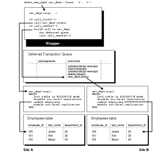

Procedural replication can offer performance advantages for large batch-oriented operations operating on large numbers of rows that can be run serially within a replication environment.
A good example of an appropriate application is a purge operation, also referred to as an archive operation, that you run infrequently (for example, once in each quarter) during off hours to remove old data, or data that was "logically" deleted from the online database. An example using procedural replication to purge deleted rows is described in the "Avoiding Delete Conflicts" section in Chapter 5, "Conflict Resolution Concepts and Architecture", of Oracle Database Advanced Replication.
All parameters for a replicated procedure must be IN
parameters; OUT
and IN/OUT
modes are not supported. The following datatypes are supported for these parameters:
VARCHAR2
NVARCHAR2
NUMBER
DATE
RAW
ROWID
CHAR
NCHAR
Binary LOB (BLOB
Character LOB (CLOB
National character LOB (NCLOB
User-defined datatypes
Oracle cannot detect update conflicts produced by replicated procedures. Replicated procedures must detect and resolve conflicts themselves. Because of the difficulties involved in writing your own conflict resolution routines, it is best to simply avoid the possibility of conflicts altogether.
Adhering to the following guidelines helps you ensure that your tables remain consistent at all sites when you plan to use procedural replication:
You must disable row-level replication within the body of the deferred procedure. See "Updating the Comments Fields in Data Dictionary Views".
Only one replicated procedure should be run at a time, as described in "Serializing Transactions".
Deferred transactions should be propagated serially. For more information about guidelines for scheduled links, see Oracle Database Advanced Replication.

When you generate replication support for your replicated package, Oracle creates a wrapper package in the schema of the replication propagator.
Unregistering the current propagator drops all existing generated wrappers in the propagator's schema. Replication support for wrapped stored procedures must be regenerated after you register a new propagator.The wrapper package has the same name as the original package, but its name is prefixed with the string you supply when you generate replication support for the procedure. If you do not supply a prefix, then Oracle uses the default prefix, defer_
. The wrapper procedure has the same parameters as the original, along with two additional parameters: call_local
and call_remote
. These two CHAR
parameters determine where the procedure is executed. When call_local
is 'Y'
, the procedure is executed locally. When call_remote
is 'Y'
, the procedure will ultimately be executed at all other master sites in the replication environment.
The remote procedures are called directly if you are propagating changes synchronously, or calls to these procedures are added to the deferred transaction queue if you are propagating changes asynchronously. By default, call_local
is 'N'
, and call_remote
is 'Y'
Oracle generates replication support for a package in two phases. The first phase creates the package specification at all sites. Phase two generates the package body at all sites. These two phases are necessary to support synchronous replication.
For example, suppose you create the package emp_mgmt
containing the procedure new_dept
, which takes one argument, email
. To replicate this package to all master sites in your system, you can use the Replication Management tool to add the package to a master group and then generate replication support for the object. After completing these steps, an application can call procedure in the replicated package as follows:
BEGIN defer_emp_mgmt.new_dept( email => 'jones', call_local => 'Y', call_remote => 'Y'); END; /

Figure 7-4 Asynchronous Procedural Replication
