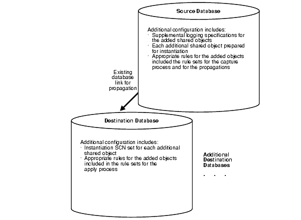

Figure 8-1 shows the additional configuration steps that must be completed to add shared database objects to a single-source Streams environment.
Figure 8-1 Example of Adding Shared Objects to a Single-Source Environment
To avoid losing LCRs, you should complete the configuration in the following order:

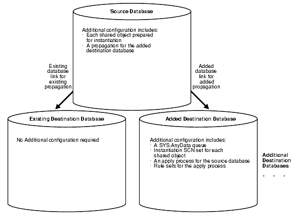

Figure 8-2 shows the additional configuration steps that must be completed to add a destination database to a single-source Streams environment.
Figure 8-2 Example of Adding a Destination to a Single-Source Environment

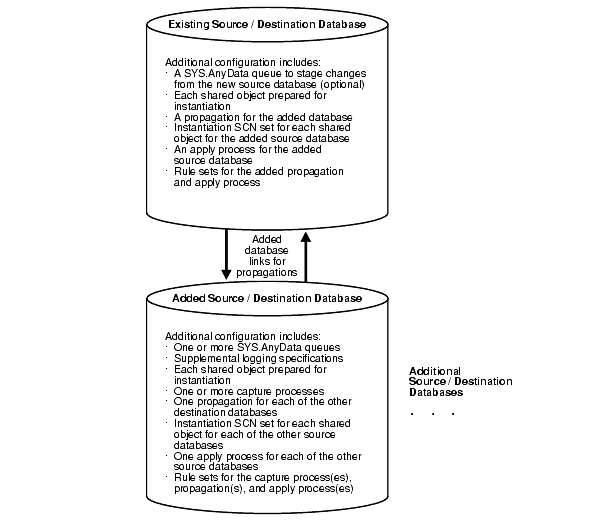

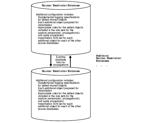

Figure 8-3 shows the additional configuration steps that must be completed to add shared database objects to a multiple-source Streams environment.
Figure 8-3 Example of Adding Shared Objects to a Multiple-Source Environment

Figure 8-4 Example of Adding a Database to a Multiple-Source Environment
Complete the following steps to add a new source/destination database to an existing multiple-source Streams environment:
Make sure no changes are made to the objects being shared at the database you are adding to the Streams environment until the instantiation at the database is complete.Complete the necessary tasks to prepare each database in your environment for Streams:
Configure a Streams administrator.
Set initialization parameters relevant to Streams.
For each database that will run a capture process, prepare the database to run a capture process.
Configure network connectivity and database links.
Some of these tasks might not be required at certain databases.
