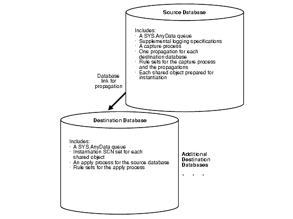

Figure 7-1 shows an example Streams single-source replication environment.
Figure 7-1 Example Streams Single-Source Environment
You can create a Streams environment that is more complicated than the one shown in Figure 7-1. For example, a single-source Streams environment can use downstream capture and directed networks.
In general, if you are configuring a new Streams single-source environment in which changes for shared objects are captured at one database and then propagated and applied at remote databases, then you should configure the environment in the following order:

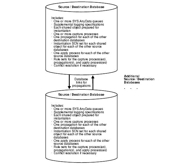

Figure 7-2 shows an example multiple-source Streams environment.
Figure 7-2 Example Streams Multiple-Source Environment
You can create a Streams environment that is more complicated than the one shown in Figure 7-2. For example, a multiple-source Streams environment can use downstream capture and directed networks.
