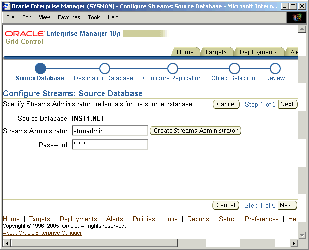

Figure 6-1 shows the opening page of the Steams Global, Schema, Table, and Subset Replication wizard.
Figure 6-1 Streams Global, Schema, Table, and Subset Replication Wizard

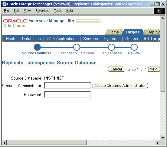

Figure 6-2 shows the opening page of the Streams Tablespace Replication wizard.
Figure 6-2 Streams Tablespace Replication Wizard

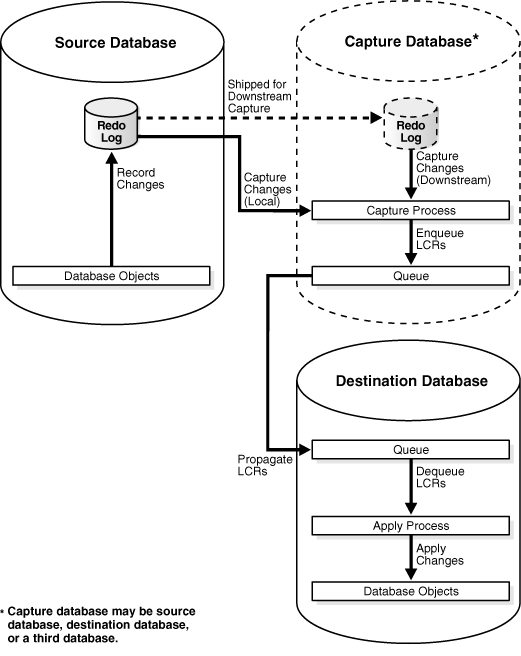

Local capture means that a capture process runs on the source database. Downstream capture means that a capture process runs on a database other than the source database. These procedures can either configure local capture or downstream capture for the database specified in the source_database parameter.
The database that captures changes made to the source database is called the capture database. These procedures can configure one of the following databases as the capture database:
Source database (local capture)
Destination database (downstream capture)
A third database (downstream capture)
Figure 6-3 shows the role of the capture database.
The database on which the procedure is run is configured as the capture database for changes made to the source database. Therefore, to configure local capture at the source database, run the procedure at the source database. To configure downstream capture at the destination database or a third database, run the procedure at the destination database or third database.
If the source database or a third database is the capture database, then these procedures configure a propagation to propagate changes from the capture database to the destination database. If the destination database is the capture database, then this propagation between databases is not needed.
Also, the capture_name and capture_queue_name parameters must be set to NULL when both of the following conditions are met:
The destination database is the capture database.
The bi_directional parameter is set to true.
When both of these conditions are met, these procedure configure two capture processes at the destination database, and these capture processes must have different names. When the capture_name and capture_queue_name parameters are set to NULL, the system generates a different name for the capture processes. These procedures raise an error if both conditions are met and either the capture_name parameter or the capture_queue_name parameter is set to a non-NULL value.
When these procedures configure downstream capture, they always configure archived-log downstream capture. These procedures do not configure real-time downstream capture. However, the scripts generated by these procedures can be modified to configure real-time downstream capture.
If these procedures configure bi-directional replication, then the capture process for the destination database always is a local capture process. That is, these procedures always configure the capture process for changes made to the destination database to run on the destination database.

If you decided to use a local capture process at the source database, then log file copying is not required. However, if you decided to use downstream capture for the source database, then configure log file copying from the source database to the capture database before you run the procedure.
Complete the following steps to prepare the source database to copy its redo log files to the capture database, and to prepare the capture database to accept these redo log files:
Configure Oracle Net so that the source database can communicate with the capture database.
Set the following initialization parameters to configure redo transport services to transmit redo data from the source database to the capture database:
At the source database, configure at least one LOG_ARCHIVE_DEST_n initialization parameter to transmit redo data to the capture database. To do this, set the following attributes of this parameter:
SERVICE - Specify the network service name of the capture database.
ARCH or LGWR ASYNC - Specify a redo transport mode.
If you specify ARCH (the default), then the archiver process (ARCn) will archive the redo log files to the downstream database. You can specify ARCH for an archived-log downstream capture process only.
If you specify LGWR ASYNC, then the log writer process (LGWR) will archive the redo log files to the downstream database. The advantage of specifying LGWR ASYNC is that it results in little or no effect on the performance of the source database. If the source database is running Oracle Database 10g Release 1 or later, then LGWR ASYNC is recommended to avoid affecting source database performance if the downstream database or network is performing poorly. You can specify LGWR ASYNC for an archived-log downstream capture process or a real-time downstream capture process.
NOREGISTER - Specify this attribute so that the capture database location is not recorded in the capture database control file.
VALID_FOR - Specify either (ONLINE_LOGFILE,PRIMARY_ROLE) or (ONLINE_LOGFILE,ALL_ROLES).
TEMPLATE - Specify a directory and format template for archived redo logs at the capture database. The TEMPLATE attribute overrides the LOG_ARCHIVE_FORMAT initialization parameter settings at the capture database. The TEMPLATE attribute is valid only with remote destinations. Make sure the format uses all of the following variables at each source database: %t, %s, and %r.
DB_UNIQUE_NAME - The unique name of the downstream database. Use the name specified for the DB_UNIQUE_NAME initialization parameter at the downstream database.
The following is an example of an LOG_ARCHIVE_DEST_n setting that specifies a capture database:
LOG_ARCHIVE_DEST_2='SERVICE=STM2.NET LGWR ASYNC NOREGISTER VALID_FOR=(ONLINE_LOGFILES,PRIMARY_ROLE) TEMPLATE=/usr/oracle/log_for_stm1/stm1_arch_%t_%s_%r.log DB_UNIQUE_NAME=stm2'
Tip:
Log files from a remote source database should be kept separate from local database log files. In addition, if the capture database contains log files from multiple source databases, then the log files from each source database should be kept separate from each other.At the source database, set the LOG_ARCHIVE_DEST_STATE_n initialization parameter that corresponds with the LOG_ARCHIVE_DEST_n parameter for the capture database to ENABLE.
For example, if the LOG_ARCHIVE_DEST_2 initialization parameter is set for the capture database, then set one LOG_ARCHIVE_DEST_STATE_2 parameter in the following way:
LOG_ARCHIVE_DEST_STATE_2=ENABLE
LOG_ARCHIVE_CONFIG - At both the source database and the downstream database, set the DB_CONFIG attribute in this initialization parameter to include the DB_UNIQUE_NAME of the source database and the downstream database.
For example, if the DB_UNIQUE_NAME of the source database is stm1, and the DB_UNIQUE_NAME of the downstream database is stm2, then specify the following parameter:
LOG_ARCHIVE_CONFIG='DG_CONFIG=(stm1,stm2)'
By default, the LOG_ARCHIVE_CONFIG parameter enables a database to both send and receive redo.
See Also:
Oracle Database Reference and Oracle Data Guard Concepts and Administration for more information about these initialization parametersIf you reset any initialization parameters while the instance is running at a database in Step 2, then you might want to reset them in the initialization parameter file as well, so that the new values are retained when the database is restarted.
If you did not reset the initialization parameters while the instance was running, but instead reset them in the initialization parameter file in Step 2, then restart the database. The source database must be open when it sends redo log files to the capture database because the global name of the source database is sent to the capture database only if the source database is open.

The resulting bi-directional replication environment has the following characteristics:
Supplemental logging is configured for the shared database objects at both databases.
The stm1.net database has a queue and queue table with system-generated names. This queue is for the apply process.
The stm2.net database has three queues and queue tables with system-generated names. One queue is for the downstream capture process, one queue is for the local capture process, and one queue is for the apply process.
At the stm2.net database, a downstream capture process with a system-generated name captures DML and DDL changes made to the source database. Specifically, this downstream capture process captures DML changes made to the tables in the tbs1 and tbs2 tablespaces and DDL changes to these tablespaces and the database objects in them.
At the stm2.net database, a local capture process with a system-generated name captures DML and DDL changes made to the destination database. Specifically, this local capture process captures DML changes to the tables in the tbs1 and tbs2 tablespaces and DDL changes to these tablespaces and the database objects in them.
A propagation running on the stm2.net database with a system-generated name propagates the changes captured by the downstream capture process from the queue for the downstream capture process to the queue for the apply process within the stm2.net database.
A propagation running on the stm2.net database with a system-generated name propagates the changes captured by the local capture process from the queue for the local capture process to the queue in the stm1.net database.
At the stm1.net database, an apply process with a system-generated name dequeues the changes from the queue and applies them to the shared database objects.
At the stm2.net database, an apply process with a system-generated name dequeues the changes from its queue and applies them to the shared database objects.
Tags are used to avoid change cycling. Specifically, each apply process uses an apply tag so that redo records for changes applied by the apply process include the tag. Each apply process uses an apply tag that is unique in the replication environment. Each propagation discards changes that have the tag of the apply process running on the same database.
