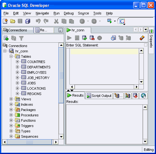

In this section, you will further familiarize yourself with the hr sample schema and its attributes, or database objects. You will learn how you can view these objects by browsing with the Oracle SQL Developer.
Start by examining some of the types of objects that each schema has.

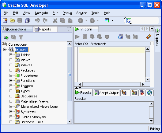

In the SQL Developer navigation hierarchy, under the Connections tab, click the 'plus' sign next to hr_conn.

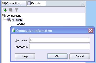

In the Connection Information dialog, authenticate the connection to the hr schema by providing the password. Click OK.
In Connections navigation hierarchy, click the 'plus' sign next to hr_conn to expand the view on the hr schema database objects.
The schema contains many objects, including tables, views, indexes, packages, procedures, functions, triggers, types, sequences, and so on. Briefly, here is a definition of each type of database object that you are likely to use:

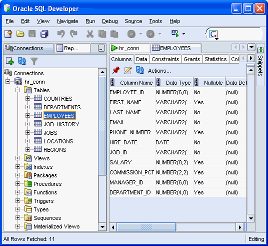

In this section, you will learn how to find out about the properties of database tables, and how to view the data these tables contain.
An Oracle Database table is its basic data container. All data that a user can access is inside one of the tables of the database schema. Each table is two-dimensional object that has rows, which are individual records, and columns, which represent the various fields of each record.
In Connections navigation hierarchy, click the 'plus' sign next to Tables to expand the list of tables in the hr schema.
The expanded list of tables includes the tables countries, departments, employees, job_history, jobs, locations, and regions.
On the right-hand side of the Oracle SQL Developer window, under the Columns tab, a listing of all columns of this table appears: EMPLOYEE_ID, FIRST_NAME, LAST_NAME, EMAIL, PHONE_NUMBER, HIRE_DATE, JOB_ID, SALARY, COMMISSION_PCT, MANAGER_ID, and DEPARTMENT_ID. Each column of a table has an associated data type that defines it as character data, an integer, a floating-point number, a date, or time information. To see all properties of the column, move the horizontal scroll bar to the right.

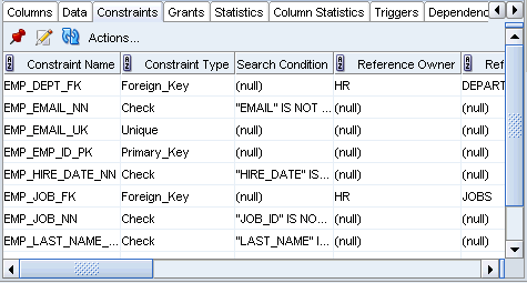

Click the Constraints tab.
You will see all the constraints that are used on this table including the type of constraint, the constraint's referenced table, whether the constraint is enabled, and other properties.
Similarly, you can explore the various table properties by clicking on the appropriate tabs:

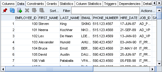

On the right-hand side of the Oracle SQL Developer window, click the Data tab.
You will see a listing of all records of this table. Each column of a table has an associated data type that defines it as character data, an integer, a floating-point number, a date, or time information. To see all properties of the column, move the horizontal scroll bar to the right.

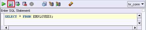

In the SQL Worksheet pane, enter:
SELECT * FROM employees;
Above the SQL Worksheet pane, click the Run Script icon. Alternatively, you can use the F5 shortcut key.
Click the Script Output tab, below the SQL Worksheet pane, to see the results of the query.

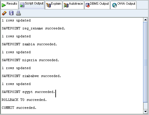

You can use the SAVEPOINT statement to identify a point in a transaction to which you can later roll back. Because you can use as many savepoints as your application requires, you can implement greater transaction control in your application.
In Example 2-54, you will use the ROLLBACK statement after adding a new row to the regions table.
Example 2-54 Using the SAVEPOINT Statement
UPDATE regions SET region_name = 'Middle East' WHERE region_name = 'Middle East and Africa'; SAVEPOINT reg_rename; UPDATE countries SET region_id = 5 WHERE country_id = 'ZM'; SAVEPOINT zambia; UPDATE countries SET region_id = 5 WHERE country_id = 'NG'; SAVEPOINT nigeria; UPDATE countries SET region_id = 5 WHERE country_id = 'ZW'; SAVEPOINT zimbabwe; UPDATE countries SET region_id = 5 WHERE country_id = 'EG'; SAVEPOINT egypt; ROLLBACK TO SAVEPOINT nigeria; COMMIT;
The results for each UPDATE and SAVEPOINT statement follow.
1 row updated. Savepoint created.
Manually check the contents of the regions table. You may need to click the Refresh icon. You will see that it now has the updated region_name value.
Next, manually check the contents of the countries table. You may need to click the Refresh icon. You will see that it now has the updated region_name values for 'Zambia' and 'Nigeria', but not for 'Zimbabwe' and 'Egypt'.
You can see that the change in data was reversed by the ROLLBACK to the savepoint nigeria.
