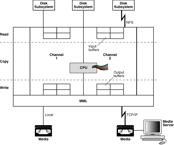

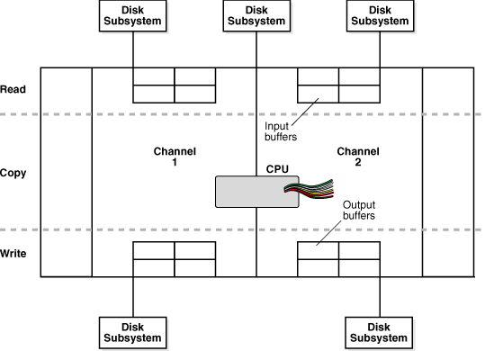

Figure 21-1 depicts two channels backing up data stored on three disks. Each channel reads the data into the input buffers, processes the data while copying it from the input to the output buffers, and the writes the data from the output buffers to disk.
Figure 21-1 Phases of a Multichannel Backup to Disk
Figure 21-2 also depicts two channels backing up data stored on three disks, but one of the disks is mounted remotely over the network. Each channel reads the data into the input buffers, processes the data while copying it from the input to the output buffers, and the writes the data from the output buffers to tape. Channel 1 writes the data to a locally-attached tape drive, whereas channel 2 sends the data over the network to a remote media server.
Figure 21-2 Phases of a Multichannel Backup to Tape

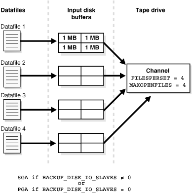

In the example shown in Figure 21-3, one channel is backing up four datafiles. MAXOPENFILES is set to 4 and FILESPERSET is set to 4. Thus, the level of multiplexing is 4. So, the total size of the buffers for each datafile is 4 MB. The combined size of all the buffers is 16 MB.

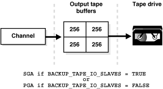

If you back up to or restore from an SBT device, then by default the database allocates four buffers for each channel for the tape writers (or reads if restoring data). The size of the tape I/O buffers is platform-dependent. You can change this value with the PARMS and BLKSIZE parameters of the ALLOCATE CHANNEL or CONFIGURE CHANNEL command.
RMAN allocates the tape buffers in the SGA or the PGA, depending on whether I/O slaves are used. If you set the initialization parameter BACKUP_TAPE_IO_SLAVES=true, then RMAN allocates tape buffers from the SGA. Tape devices can only be accessed by one process at a time, so RMAN starts as many slaves as necessary for the number of tape devices. If the LARGE_POOL_SIZE initialization parameter is also set, then RMAN allocates buffers from the large pool. If you set BACKUP_TAPE_IO_SLAVES=false, then RMAN allocates the buffers from the PGA.
If you use I/O slaves, then set the LARGE_POOL_SIZE initialization parameter to dedicate SGA memory to holding these large memory allocations. This parameter prevents RMAN I/O buffers from competing with the library cache for SGA memory. If I/O slaves for tape I/O were requested but there is not enough space in the SGA for them, slaves are not used, and a message appears in the alert log.
Note that BACKUP_TAPE_IO_SLAVES specifies whether RMAN uses slave processes, not the number of slave processes. Tape devices can only be accessed by one process at a time, and RMAN uses the number of slaves necessary for the number of tape devices.

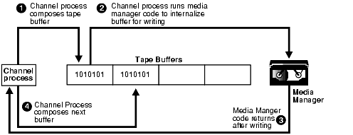

When an SBT channel reads or writes data to tape, the I/O is always synchronous. For tape I/O, each channel allocated (whether manually or automatically) corresponds to a server process, called here a channel process.
The following figure shows synchronous I/O in a backup to tape.
The following steps occur:
The channel process composes a tape buffer.
The channel process executes media manager code that processes the tape buffer and internalizes it for further processing and storage by the media manager.
The media manager code returns a message to the server process stating that it has completed writing.
The channel process can initiate a new task.

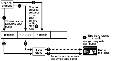

The following figure shows asynchronous I/O in a tape backup. Asynchronous I/O to tape is simulated by using tape slaves. In this case, each allocated channel corresponds to a server process, which in the explanation which follows is identified as a channel process. For each channel process, one tape slave is started (or more than one, in the case of multiple copies).
A channel process writes blocks to a tape buffer.
The channel process sends a message to the tape slave process to process the tape buffer. The tape slave process executes media manager code that processes the tape buffer and internalizes it so that the media manager can process it.
While the tape slave process is writing, the channel process is free to read data from the datafiles and prepare more output buffers.
After the tape slave channel returns from the media manager code, it requests a new tape buffer, which usually is ready. Thus waiting time for the channel process is reduced, and the backup is completed faster.

You can improve backup performance by adjusting the level of multiplexing, which is number of input files simultaneously read and then written into the same RMAN backup piece. The level of multiplexing is the minimum of the MAXOPENFILES setting on the channel and the number of input files placed in each backup set. The following table makes recommendations for adjusting the level of multiplexing.
Table 21-3 Adjusting the Level of Multiplexing
| ASM | Striped Disk | Recommendation |
No |
Yes |
Increase the level of multiplexing. Determine which is the minimum, In this way, you increase the rate at which RMAN fills tape buffers, which makes it more likely that buffers are sent to the media manager fast enough to maintain streaming. |
No |
No |
Increase the |
Yes |
n/a |
Set the |
See Also:
"Multiplexed Backup Sets" to learn how the MAXOPENFILES and FILESPERSET settings affect the level of multiplexing

If RMAN is backing up to tape, then try the following adjustments:
Adjust the size of the tape I/O buffers.
Use the PARMS and BLKSIZE parameters of the ALLOCATE CHANNEL or CONFIGURE CHANNEL command to set the size. The size of the tape I/O buffers is platform-dependent. The BLKSIZE setting overrides the default.
Adjust settings in the media management software.
A number of media manager settings, including the tape block size, may affect backup performance.
