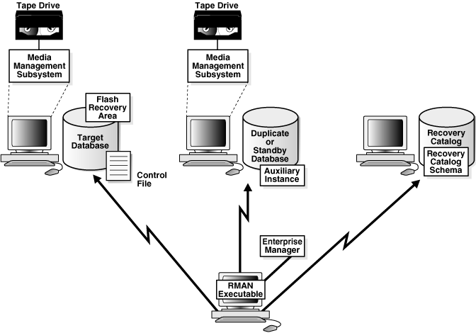

The Recovery Manager environment consists of the various applications and databases that play a role in a backup and recovery strategy.
Table 3-1 lists some of the components in a typical RMAN environment.
Table 3-1 Components of the RMAN Environment

The only required components in an RMAN environment are a target database and RMAN client, but most real-world configurations are more complicated. For example, you could use an RMAN client connecting to multiple media managers and multiple target databases and auxiliary databases, all accessed through Enterprise Manager.
Figure 3-1 illustrates components in a possible RMAN environment. The graphic shows that the primary database, standby database, and recovery catalog databases all reside on different computers. The primary and standby database hosts use a locally attached tape drive. The RMAN client and Enterprise Manager console run on a separate computer.

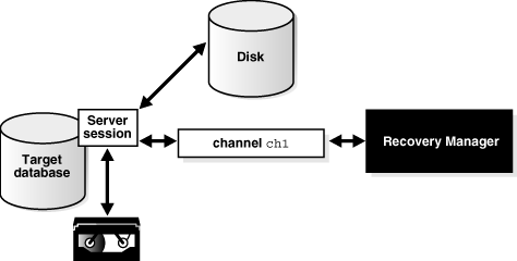

The RMAN client directs database server sessions to perform all backup and recovery tasks. What constitutes a session depends on the operating system. For example, on Linux, a server session corresponds to a server process, whereas on Windows it corresponds to a thread within the database service.
The RMAN client itself does not perform backup, restore, or recovery operations. When you connect the RMAN client to a target database, RMAN allocates server sessions on the target instance and directs them to perform the operations.
An RMAN channel represents one stream of data to a device, and corresponds to one database server session. The channel reads data into PGA memory, processes it, and writes it to the output device. See "Basic Concepts of RMAN Performance Tuning" for a low-level description of how channels work.
Most RMAN commands are executed by channels, which must be either configured to persist across RMAN sessions, or manually allocated in each RMAN session. As illustrated in Figure 3-2, a channel establishes a connection from the RMAN client to a target or auxiliary database instance by starting a server session on the instance.
The RMAN-supported device types are disk and SBT (system backup to tape). An SBT device is controlled by a third-party media manager. Typically, SBT devices are tape libraries and tape drives.
