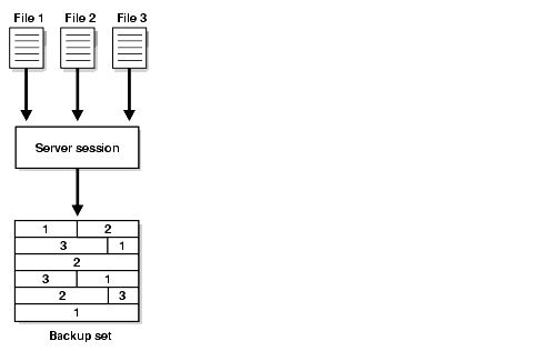

When creating backup sets, RMAN can simultaneously read multiple files from disk and then write their blocks into the same backup set. For example, RMAN can read from two datafiles simultaneously, and then combine the blocks from these datafiles into a single backup piece. The combination of blocks from multiple files is called backup multiplexing. Image copies, by contrast, are never multiplexed.
If RMAN creates a multisection backup of a datafile, then the datafile will not be multiplexed with any other datafile or file section.As Figure 7-1 illustrates, RMAN can back up three datafiles into a backup set that contains only one backup piece. This backup piece contains the intermingled data blocks of the three input datafiles.
RMAN multiplexing is determined by several factors. For example, the FILESPERSET parameter of the BACKUP command determines how many datafiles to put in each backup set. The MAXOPENFILES parameter of ALLOCATE CHANNEL or CONFIGURE CHANNEL defines how many datafiles RMAN can read from simultaneously. The basic multiplexing algorithm is as follows:
Number of files in each backup set
This number is the minimum of the FILESPERSET setting and the number of files read by each channel. The FILESPERSET default is 64.
This is the number of input files simultaneously read and then written into the same backup piece. The level of multiplexing is the minimum of MAXOPENFILES and the number of files in each backup set. The MAXOPENFILES default is 8.
Suppose that you back up 12 datafiles with one channel. The number of files in each backup set is 4. The level of multiplexing is the lesser of this number and 8. Thus, the channel simultaneously writes blocks from 4 datafiles into each backup piece.
Now suppose that you back up 50 datafiles with one channel. The number of files in each backup set is 50. The level of multiplexing is the lesser of this number and 8. Thus, the channel simultaneously writes blocks from 8 datafiles into each backup piece.

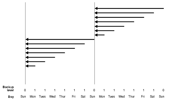

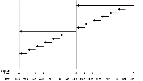

A differential incremental backup, which backs up all blocks changed after the most recent incremental backup at level 1 or 0
A cumulative incremental backup, which backs up all blocks changed after the most recent incremental backup at level 0
Incremental backups are differential by default.
Cumulative backups are preferable to differential backups when recovery time is more important than disk space, because fewer incremental backups need to be applied during recovery.The size of the backup file depends solely upon the number of blocks modified, the incremental backup level, and the type of incremental (differential or cumulative).
In a differential level 1 backup, RMAN backs up all blocks that have changed since the most recent incremental backup at level 1 (cumulative or differential) or level 0. For example, in a differential level 1 backup, RMAN determines which level 1 backup occurred most recently and backs up all blocks modified after that backup. If no level 1 is available, then RMAN copies all blocks changed since the base level 0 backup.
If no level 0 backup is available in either the current or parent incarnation, then the behavior varies with the compatibility mode setting. If compatibility is >=10.0.0, RMAN copies all blocks that have been changed since the file was created. Otherwise, RMAN behaves as it did in previous releases, by generating a level 0 backup.
Figure 7-2 Differential Incremental Backups
In the example shown in Figure 7-2, the following occurs each week:
Sunday
An incremental level 0 backup backs up all blocks that have ever been in use in this database.
Monday - Saturday
On each day from Monday through Saturday, a differential incremental level 1 backup backs up all blocks that have changed since the most recent incremental backup at level 1 or 0. The Monday backup copies blocks changed since Sunday level 0 backup, the Tuesday backup copies blocks changed since the Monday level 1 backup, and so forth.
In a cumulative level 1 backup, RMAN backs up all blocks used since the most recent level 0 incremental backup in either the current or parent incarnation. Cumulative incremental backups reduce the work needed for a restore by ensuring that you only need one incremental backup from any particular level. Cumulative backups require more space and time than differential backups because they duplicate the work done by previous backups at the same level.
Figure 7-3 Cumulative Incremental Backups
In the example shown in Figure 7-3, the following occurs each week:
Sunday
Monday - Saturday
A cumulative incremental level 1 backup copies all blocks changed since the most recent level 0 backup. Because the most recent level 0 backup was created on Sunday, the level 1 backup on each day Monday through Saturday backs up all blocks changed since the Sunday backup.
The block change tracking feature for incremental backups improves incremental backup performance by recording changed blocks in each datafile in a block change tracking file. This file is a small binary file stored in the database area. RMAN tracks changed blocks as redo is generated.
If you enable block change tracking, then RMAN uses the change tracking file to identify changed blocks for an incremental backup, thus avoiding the need to scan every block in the datafile. RMAN only uses block change tracking when the incremental level is greater than 0 because a level 0 incremental backup includes all blocks.

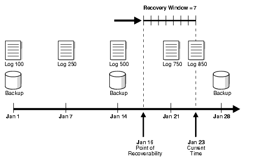

A recovery window is a period of time that begins with the current time and extends backward in time to the point of recoverability. The point of recoverability is the earliest time for a hypothetical point-in-time recovery, that is, the earliest point to which you can recover following a media failure. For example, if you implement a recovery window of one week, then RMAN retains full backups and required incremental backups and archived logs so that the database can be recovered up to 7 days in the past. You implement this retention policy as follows:
CONFIGURE RETENTION POLICY TO RECOVERY WINDOW OF 7 DAYS;
This command ensures that for each datafile one backup that is older than the point of recoverability must be retained. For example, if the recovery window is 7, then there must always exist one backup of each datafile that satisfies the following condition:
SYSDATE - BACKUP CHECKPOINT TIME >= 7
All backups older than the most recent backup that satisfied this condition are obsolete.
Assume the following retention policy illustrated in Figure 7-4. The retention policy has the following aspects:
The recovery window is 7 days.
Database backups are scheduled every two weeks on these days:
January 1
January 15
January 29
February 12
The database runs in ARCHIVELOG mode, and archived logs are saved on disk only as long as needed for the retention policy.
As illustrated in Figure 7-4, the current time is January 23 and the point of recoverability is January 16. Hence, the January 14 backup is needed for recovery, and so are the archived logs from log sequence 500 through 850. The logs before 500 and the January 1 backup are obsolete because they are not needed for recovery to a point within the window.

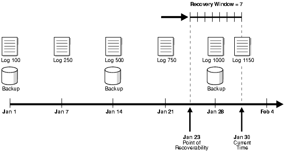

Assume the same scenario a week later, as depicted in Figure 7-5.
In this scenario, the current time is January 30 and the point of recoverability is January 23. Note how the January 14 backup is not obsolete even though a more recent backup (January 28) exists in the recovery window. This situation occurs because restoring the January 28 backup does not enable you to recover to the earliest time in the window, January 23. To ensure recoverability to any point in the window, you must save the January 14 backup and all archived logs from sequence 500 to 1150.
