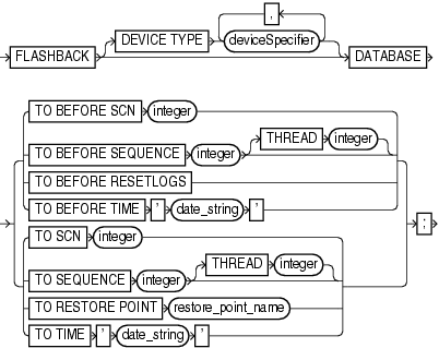

Use the FLASHBACK DATABASE command to rewind the database to a target time, SCN, or log sequence number.

| Syntax Element | Description |
DEVICE TYPE deviceSpecifier |
Allocates automatic channels for the specified device type only. For example, if you configure automatic disk and tape channels, and issue FLASHBACK ... DEVICE TYPE DISK, then RMAN allocates only disk channels. RMAN may need to restore redo logs from backup during the flashback database process. Changes between the last flashback log and the target time must be re-created based on the archived redo log. If no automatic channels are allocated for tape and a needed redo log is on tape, then the FLASHBACK DATABASE operation fails.
See Also: |
TO BEFORE SCN integer |
Returns the database to its state just before the specified SCN. Any changes at an SCN lower than that specified are applied, but if there is a change associated with the specified SCN it is not applied. By default, the provided SCN resolves to the current or ancestor incarnation. You can override the default by using the RESET DATABASE INCARNATION command.
Query |
TO BEFORE SEQUENCE integer [THREAD integer] |
Specifies a redo log sequence number and thread as an upper limit. RMAN applies changes up to (but not including) the last change in the log with the specified sequence and thread number. |
TO BEFORE RESETLOGS |
Returns the database to its state including all changes up to the SCN of the most recent OPEN RESETLOGS.
Note: |
TO BEFORE TIME'date_string' |
Returns the database to its state including all changes up to but not including changes at the specified time.
Query |
TO SCN integer |
Returns the database to the point up to (and including) the specified SCN. By default, the provided SCN resolves to the current or ancestor incarnation. You can override the default by using the RMAN RESET DATABASE command to set the recovery target incarnation.
Query |
TO SEQUENCE integer THREAD integer |
Specifies a redo log sequence number and thread as an upper limit. RMAN applies changes up to (and including) the last change in the log with the specified sequence and thread number. |
TO RESTORE POINTrestore_point_name |
Returns the database to the SCN associated with the specified restore point. This can be an ordinary restore point or a guaranteed restore point. |
TO TIME 'date_string' |
Returns the database to its state at the specified time. You can use any SQL DATE expressions to convert the time to the current format, for example, FLASHBACK DATABASE TO TIME 'SYSDATE-7'.
