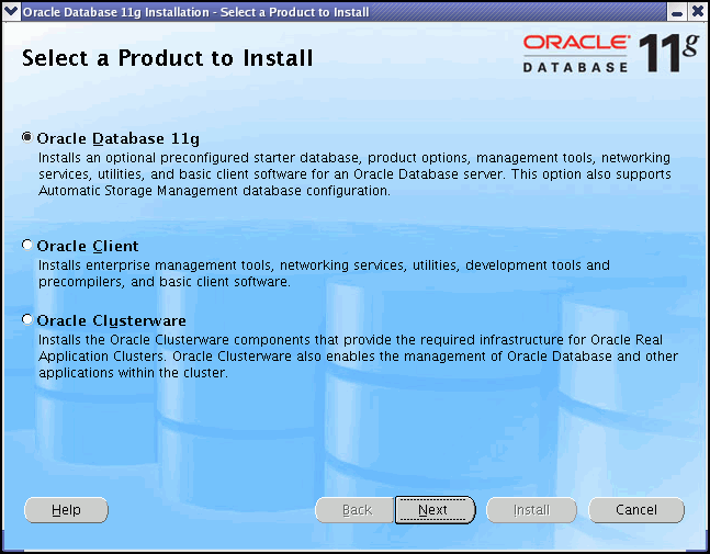

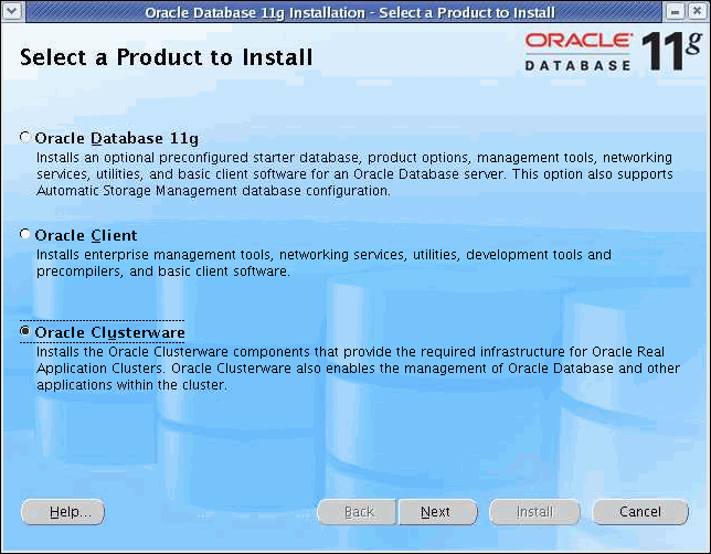

The Select a Product to Install window appears.
Select Oracle Clusterware from the list, then click Next.

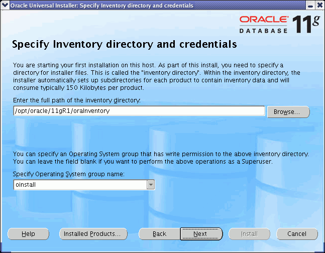

If you have not installed any Oracle software previously on this server, the Specify Inventory directory and credentials window appears.
Change the path for the inventory location, if required. Select oinstall for the operating system group name. Click Next.
The path displayed for the inventory directory should be the oraInventory subdirectory of your Oracle base directory. For example, if you set the ORACLE_BASE environment variable to /opt/oracle/11gR1 before starting OUI, then the path displayed is /opt/oracle/11gR1/oraInventory.

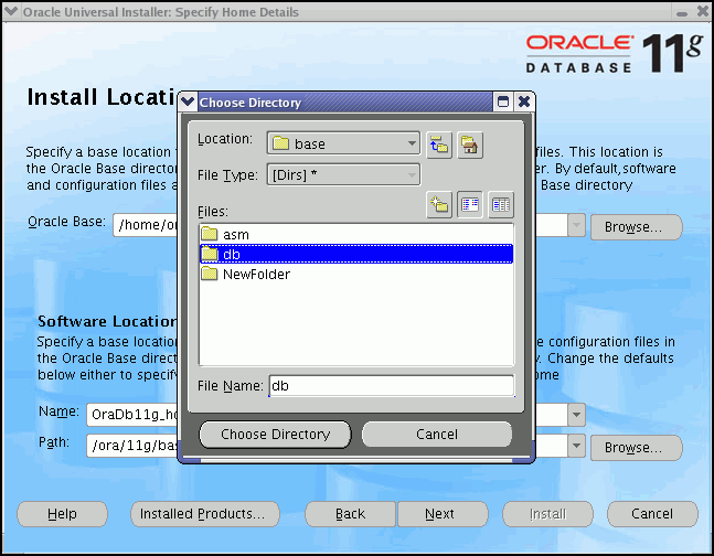

The Specify Home Details window appears.
Accept the default value for the Name field, which is the name of the Oracle home directory for this product. For the Path field, click Browse. In the Choose Directory window Go up the path until you reach the root directory (/), click /u01/app/crs, then click Choose Directory.

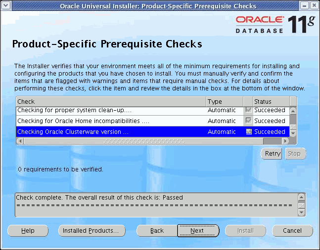

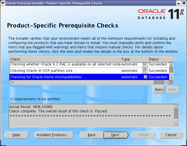

After you have selected the path, click Next. The next window, Product-Specific Prerequisite Checks, appears after a short period of time.
When you see the message "Check complete. The overall result of this check is: Passed", as shown in the following screenshot, click Next.

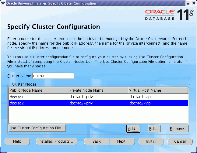

The Specify Cluster Configuration window appears.
Change the default cluster name to a name that is unique throughout your entire enterprise network. For example, you might choose a name that is based on the node names' common prefix. This guide will use the cluster name docrac.
The local node, docrac1, appears in the Cluster Nodes section. If the private node name includes the domain name, click Edit and remove the domain name from the private node name. For example, if the private node name is docrac1-priv.us.oracle.com, edit the entry so that it is displayed as docrac1-priv.
When you have finished removing the domain name in the "Modify a node in the existing cluster" window, click OK.
When you are returned to the Specify Cluster Configuration window, click Add.
In the "Add a new node to the existing cluster" dialog window, enter the second node's public name (docrac2.us.oracle.com), private name (docrac2-priv), and virtual IP name (docrac2-vip.us.oracle.com), and then click OK.
The Specify Cluster Configuration window now displays both nodes in the Cluster Nodes.

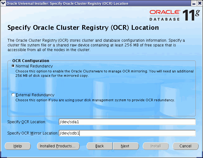

The Specify Oracle Cluster Registry (OCR) Location window appears.
Select Normal Redundancy for the OCR Configuration. You will be prompted for two file locations. In the Specify OCR Location field, enter the name of the device configured for the first OCR file, for example, /dev/sda1.
In the Specify OCR Mirror Location field, enter the name of the device configured for the OCR mirror file, for example /dev/sdb1. When finished, click Next.
During installation, the OCR data will be written to the specified locations.

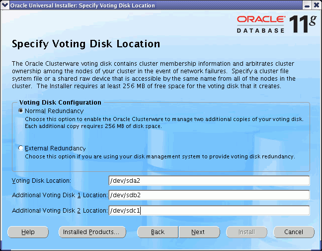

The Specify Voting Disk Location window appears.
Select Normal Redundancy for the voting disk location. You will be prompted for three file locations. For the Voting Disk Location, enter the name of the device configured for the first voting disk file, for example, /dev/sda2. Repeat this process for the other two Voting Disk Location fields.
When finished, click Next. The OUI Summary window appears.

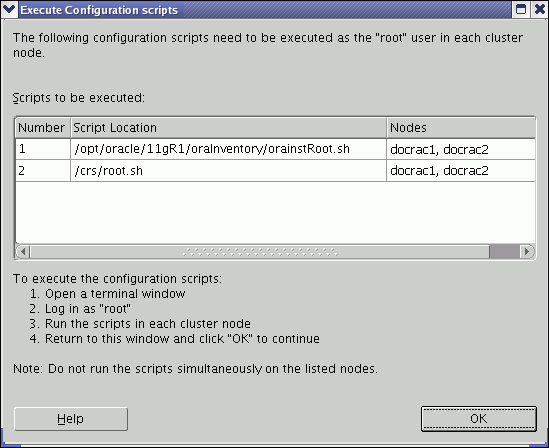

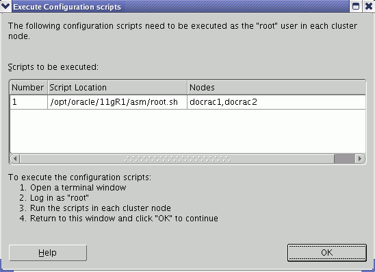

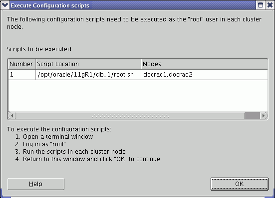

During the installation process, the Execute Configuration Scripts window appears. Do not click OK until you have run the scripts.
The Execute Configuration Scripts window shows configuration scripts, and the path where the configuration scripts are located. Run the scripts on all nodes as directed, in the order shown. For example, on Red Hat Linux you perform the following steps (note that for clarity, the examples show the current user, node and directory in the prompt):
As the oracle user on docrac1, open a terminal window, and enter the following commands:
[oracle@docrac1 oracle]$ cd /opt/oracle/11gR1/oraInventory [oracle@docrac1 oraInventory]$ su
Enter the password for the root user, and then enter the following command to run the first script on docrac1:
[root@docrac1 oraInventory]# ./orainstRoot.sh
After the orainstRoot.sh script finishes on docrac1, open another terminal window, and as the oracle user, enter the following commands:
[oracle@docrac1 oracle]$ ssh docrac2 [oracle@docrac2 oracle]$ cd /opt/oracle/11gR1/oraInventory [oracle@docrac2 oraInventory]$ su
Enter the password for the root user, and then enter the following command to run the first script on docrac2:
[root@docrac2 oraInventory]# ./orainstRoot.sh

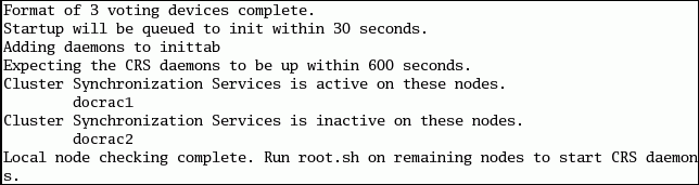

After the orainstRoot.sh script finishes on docrac2, go to the terminal window you opened in Step 15a. As the root user on docrac1, enter the following commands to run the second script, root.sh:
[root@docrac1 oraInventory]# cd /u01/app/crs [root@docrac1 crs]# ./root.sh
Do not attempt to run theroot.sh script on other nodes, or it might fail. Wait until the script finishes running on the local node.At the completion of this script, the following message is displayed:
After the root.sh script finishes on docrac1, go to the terminal window you opened in Step 15c. As the root user on docrac2, enter the following commands:
[root@docrac2 oraInventory]# cd /u01/app/crs [root@docrac2 crs]# ./root.sh
After the root.sh script completes, return to the OUI window where the Installer prompted you to run the orainstRoot.sh and root.sh scripts. Click OK.

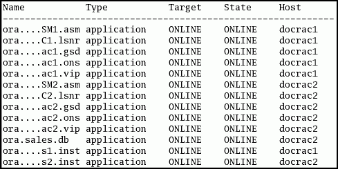

After you have installed Oracle Clusterware, verify that the node applications are running. Depending on which operating system you use, you may need to perform some postinstallation tasks to configure the Oracle Clusterware components properly.
To complete the Oracle Clusterware configuration on Red Hat Linux:

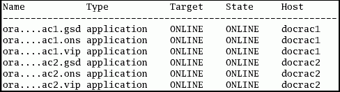

As the oracle user on docrac1, check the status of the Oracle Clusterware targets by entering the following command:
/u01/app/crs/bin/crs_stat -t
This command provides output showing if all the important cluster services, such as gsd, ons, and vip, are running on the nodes of your cluster.

When you start Oracle Universal Installer, the Select a Product to Install window appears.
Select Oracle Database 11g from the list, then click Next.

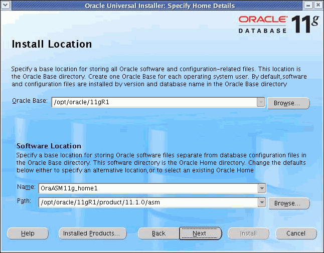

In the Specify Home Details window, specify a name for the ASM home directory, for example, OraASM11g_home. Select a directory that is a subdirectory of your Oracle Base directory, for example, /opt/oracle/11gR1/asm. Click Browse to change the directory in which ASM will be installed.
After you have specified the ASM home directory, click Next.

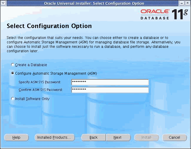

The Select Configuration Option window appears.
Select the Configure Automatic Storage Management (ASM) option to install and configure ASM. The ASM instance is managed by a privileged role called SYSASM, which grants full access to ASM disk groups.
Enter a password for the SYSASM user account. The passwords should be at least 8 characters in length and include at least one alphabetic and one numeric character.
Confirm the password by typing it in again in the Confirm ASM SYS Password field.

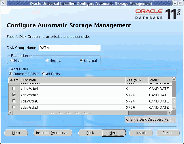

The Configure Automatic Storage Management window appears.

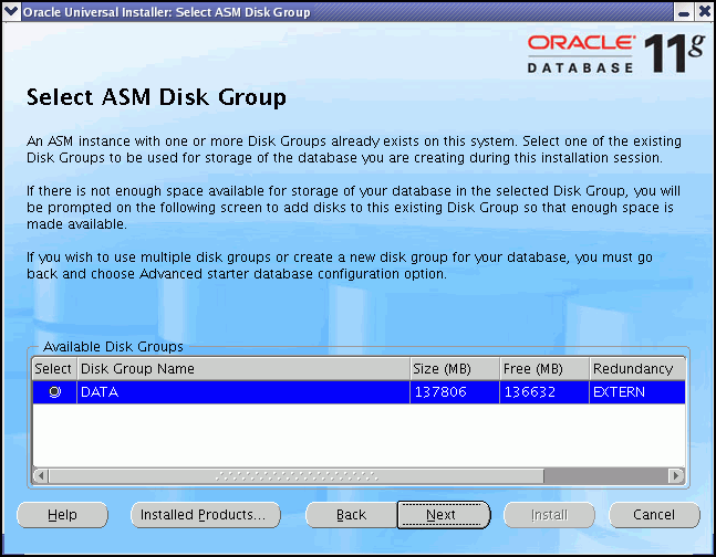

In the Configure Automatic Storage Management window, the Disk Group Name defaults to DATA. You can enter a new name for the disk group, or use the default name.
Check with your system administrator to determine if the disks used by ASM are mirrored at the storage level. If so, select External for the redundancy. If the disks are not mirrored at the storage level, then choose Normal for the redundancy.

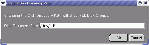

At the bottom right of the Add Disks section, click Change Disk Discovery Path to select any devices that will be used by ASM but are not listed.
In the Change Disk Discovery Path window, enter a string to use to search for devices that ASM will use, such as /dev/sd*, and then click OK.
You are returned to the Configure Automatic Storage Management window.
Select the disks to be used by ASM, for example, /dev/sdd and /dev/sde.

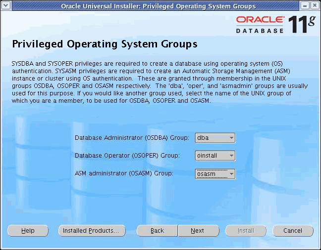

After you have finished selecting the disks to be used by ASM, click Next. The Privileged Operating Systems Groups window appears.
Select the name of the operating system group you created in the previous chapter for the OSDBA group, the OSASM group, and the database operator group. If you choose to create only the dba group, then you can use that group for all three privileged groups. If you created a separate asm group, then use that value for the OSASM group.
After you have supplied values for the privileged groups, click Next. The Oracle Configuration Manager Registration window appears.

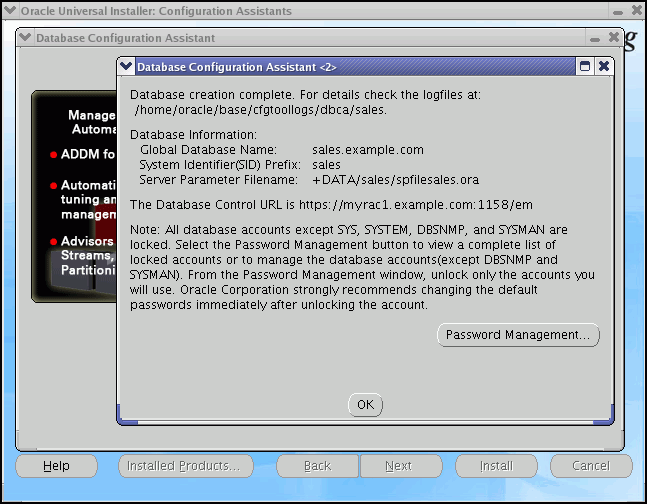

After ASM has been installed, OUI runs the Configuration Assistants. When the assistants have finished successfully, click Next to continue.
The Execute Configuration Scripts window appears.
Run the scripts as instructed in the Execute Configuration scripts window. For the installation demonstrated in this guide, only one script, root.sh, must be run, and it must be run on both nodes.
The following steps demonstrate how to complete this task on a Linux system (note that for clarity, the examples show the user, node name, and directory in the prompt):
Open a terminal window. As the oracle user on docrac1, change directories to the ASM home directory, and then switch to the root user:
[oracle@docrac1 oracle]$ cd /opt/oracle/11gR1/asm [oracle@docrac1 oracle]$ su
Enter the password for the root user, and then run the script specified in the Execute Configuration scripts window:
[root@docrac1 oracle]# ./root.sh
As the root.sh script runs, it prompts you for the path to the local bin directory. The information displayed in the brackets is the information it has obtained from your system configuration. Press the Enter key each time you are prompted for input to accept the default choices.
After the script has completed, the prompt appears. Open another terminal window, and enter the following commands:
[oracle@docrac1 oracle]$ ssh docrac2 Enter the passphrase for key '/home/oracle/.ssh/id_rsa': [oracle@docrac2 oracle]$ cd /opt/oracle/11gR1/asm [oracle@docrac2 asm]$ su Password:
[root@docrac2 asm]# ./root.sh
Accept all default choices by pressing the Enter key.
After you finish executing the script on all nodes, return to the Execute Configuration Scripts window and click OK to continue.
OUI displays the End of Installation window.
Review the information in the End of Installation window. The Web addresses displayed are not used in this guide, but may be needed for your business applications.
Click Exit, and then click Yes to verify that you want to exit the installation.

The Install Location window appears.
Specify a name for the Oracle home, for example, OraDb11g_home.
Select an Oracle home directory that is a subdirectory of your Oracle base directory, for example, /opt/oracle/11gR1/db_1.
You can click Browse to change the directory in which the Oracle Database software will be installed. After you have selected the directory, click Choose Directory to close the Choose Directory window.
If the directory does not exist, you can type in the directory path in the File Name field, and then click Choose Directory. If a window appears asking if you want to create the directory, click Yes.
After you have verified the information on the Install Location window, click Next.

The Product-Specific Prerequisite Checks window appears.
In the Product-Specific Prerequisite Checks window, you might see a warning that says the host IP addresses are generated by the dynamic host configuration protocol (DHCP), which is not a recommended best practice. You can ignore this warning.When you see the confirmation message that your system has passed the prerequisite checks, click Next.
In the Select Configuration Option window, accept the default option of Create a Database and click Next.

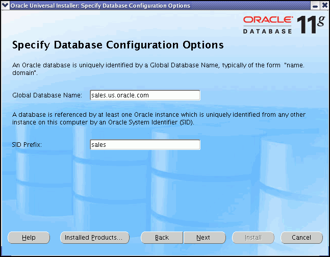

The Specify Database Configuration Options window appears.
In the Global Database Name field, enter a fully qualified name for your database, such as sales.mycompany.com. Ensure that the SID field contains the first part of the database name, for example, sales.
After you have entered the database name and SID, click Next. The Specify Database Config Details window appears.
The value for the system identifier (SID) will be used as a prefix for the instance names. Thus if the SID is set tosales, the instance names will be sales1, sales2, and so on.Check the settings on each of the tabs. If you are not sure what values to use, then accept the default values. On the Sample Schemas tab, if you want sample data and schemas to be created in your database, then select the Create database with sample schemas option. When finished, click Next to continue.

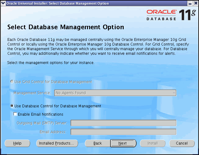

The Select Database Management Option window appears.
By default, the Use Database Control for Database Management option is selected instead of the Use Grid Control for Database Management option. The examples in this guide use Database Control, which is the default value.
Do not select the option Enable Email Notifications if your cluster is not connected to a mail server.
After you have made your selections, click Next.

If you selected ASM as your storage solution, the Select ASM Disk Group window appears.
If you want to use ASM as the backup area, you must create an additional ASM disk group when configuring ASM.The Select ASM Disk Group window shows you where the database files will be created. Select the disk group that was created during the ASM installation, and then click Next.

When finished entering passwords, click Next. OUI displays the Privileged Operating System Groups window.

As part of the software installation process, the sales database is created. At the end of the database creation, you will see the Oracle Database Configuration Assistant (DBCA) window with the URL for the Database Control console displayed.
Make note of the URL, and then click OK. Wait for DBCA to start the cluster database and its instances.
After the installation, you are prompted to perform the postinstallation task of running the root.sh script on both nodes.
On each node, run the scripts listed in the Execute Configuration scripts window before you click OK. Perform the following steps to run the root.sh script:
Open a terminal window. As the oracle user on docrac1, change directories to your Oracle home directory, and then switch to the root user by entering the following commands:
[oracle@docrac1 oracle]$ cd /opt/oracle/11gR1/db_1 [oracle@docrac1 db_1]$ su
[root@docrac1 db_1]# ./root.sh
After the script has completed, the prompt appears. Enter the following commands:
[oracle@docrac1 oracle]$ ssh docrac2 [oracle@docrac2 oracle]$ cd /opt/oracle/11gR1/db_1 [oracle@docrac2 db_1]$ su
[root@docrac2 db_1]# ./root.sh
After you finish executing the script on all nodes, return to the Execute Configuration scripts window and click OK.

Run the following command to view the status of the applications managed by Oracle Clusterware:
[oracle] $ ./crs_stat –t
The output of the command should show that the database instances are available (online) for each host.

De-configure Database Control on the single-instance database using the following command:
emca -deconfig dbcontrol db
Run rconfig utility to convert the single-instance database to an Oracle RAC database
Run DBCA to configure Database Control for Cluster Database
