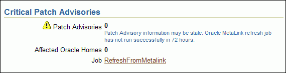

After you have configured the OracleMetaLink credentials, you can create a job to search for critical patch advisories for your installed software.
To create a job to search for critical patch advisories on OracleMetaLink:
On the Cluster Database Home page, scroll down to the section titled Critical Patch Advisories. Click RefreshFromMetalink.
When you click this link, Enterprise Manager creates the Refresh_From_Metalink_Job job, and then displays the Job Activity page.
On the Job Activity page, click Edit and then modify the scheduled execution time of the Refresh_From_Metalink_Job job to meet your business requirements. When finished, click Save.
Select the Refresh_From_Metalink_Job job and click Create Like.
Change the job name to Refresh_From_Metalink_Now, then click Schedule.
Select Immediately for the start time.
Select One Time Only for the Repeat interval, then click Submit and Save.
The Job Activity page appears.
Click REFRESH_FROM_METALINK_NOW.
The Job Run: REFRESH_FROM_METALINK_NOW page is displayed.
Refresh this page until the job status shows Succeeded.
