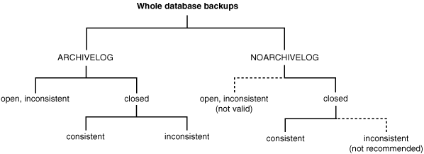

A whole database backup is a backup of every datafile in the database, plus the control file. Whole database backups are the most common type of backup.
As shown in Figure 15-1, a whole database backups can be taken in either ARCHIVELOG
or NOARCHIVELOG
mode and is either a consistent backup or an inconsistent backup. Whether a backup is consistent determines whether you must apply redo logs after restoring the backup.
Figure 15-1 Whole Database Backup Options

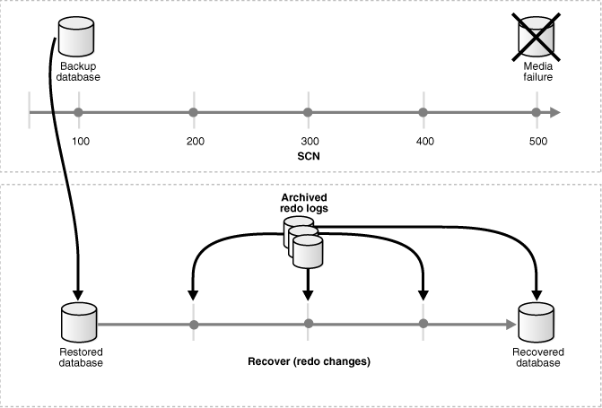

You can use archived redo logs to roll a backup forward in time. To recover a backup through the most recent archived redo log, every log generated after the backup was made must be available. In other words, you cannot recover from archived redo log 100 to log 200 if log 173 is missing. If log 173 is missing, then you must halt recovery after applying log 172 and open the database with the RESETLOGS

After the necessary files are restored, media recovery must be initiated by the user. Media recovery involves various operations to restore, roll forward, and roll back a backup of database files.
Media recovery applies archived redo logs and online redo logs to recover the datafiles. Whenever a change is made to a datafile, the change is first recorded in the online redo logs. Media recovery selectively applies the changes recorded in the online and archived redo logs to the restored datafile to roll it forward.
Figure 15-2 illustrates the basic principle of backing up, restoring, and performing media recovery on a database.
