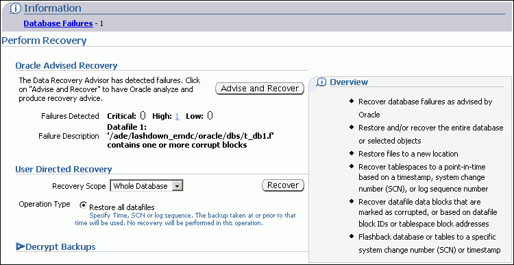

Data Recovery Advisor has both a command-line and GUI interface. The GUI interface is available in Oracle Enterprise Manager Database Control and Grid Control. You can click Perform Recovery in the Availability tab of the Database Home page to navigate to the page shown in Figure 14-1.

Oracle Database 2 Day DBA to learn how to perform backup and recovery with Enterprise ManagerA checker is a diagnostic operation or procedure registered with the Health Monitor to assess the health of the database or its components. The health assessment is known as a data integrity check and can be invoked reactively or proactively.
