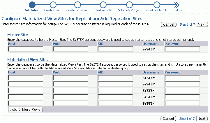

In Oracle Enterprise Manager, log in to the materialized view site as an administrative user, such as SYSTEM.
Go to the Database Home page.
Click Data Movement to open the Data Movement subpage.
On the Advanced Replication: Setup page, expand Updateable Materialized View Replication.
Select Configure Materialized View Sites for Replication.
Click Continue to open the Configure Materialized View Sites for Replication Wizard.
Complete the pages in the wizard to configure the materialized view sites. On the Create Users page, enter an appropriate password for the materialized view administrator. See Oracle Database 2 Day + Security Guide for information about choosing passwords. For more information about using the wizard, click Help for each page of the wizard.

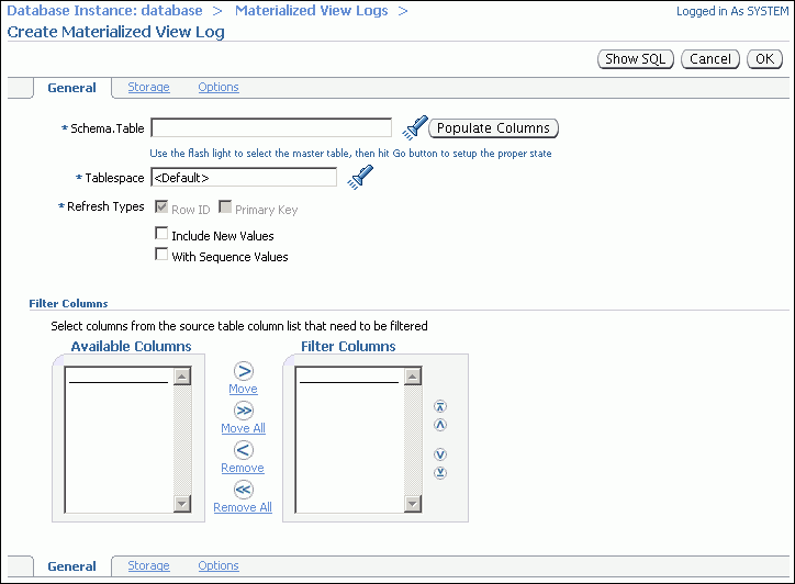

To enable fast refresh of a materialized view, configure a materialized view log for its master table at the master site. A fast refresh is more efficient than a complete refresh, because it updates only rows that have changed since the last refresh. See "About Materialized View Refresh" for more information.
To configure materialized view logs:
In Oracle Enterprise Manager, log in to the master site as an administrative user, such as SYSTEM.
Click Setup in the Advanced Replication section.
Select Create Materialized View log on source database tables for fast refresh.
Click Continue to open the Create Materialized View Log page.
Enter the schema name and table name for the master table in the form schema.table in the Schema.Table field, or click the flashlight icon to find the table.
Click Populate Columns.
If you have a specific tablespace for the materialized view log you are creating, then enter the tablespace name in the Tablespace field. Otherwise, leave <Default> in the field. Click Help for more information about the page.
Ensure that Primary Key is selected in Refresh Types.
You can also use theCREATE MATERIALIZED VIEW LOG SQL statement to create a materialized view log.A read-only replica of a table is appropriate for databases that provide access to the replicated data without allowing applications to modify the replicated data.

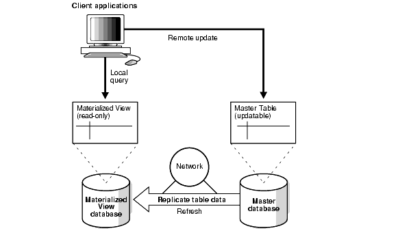

Read-only materialized views provide read-only access to the table data that originates from a master site. Applications can query data from read-only materialized views to avoid network access to the master site, regardless of network availability. However, applications throughout the system must access data at the master site to perform insert, update, and delete operations.
Figure 7-1 shows how a read-only materialized view works.
Figure 7-1 shows that client applications can perform local queries on a read-only materialized view at the materialized view site. These applications can update data at the remote master. The materialized view is updated with the changes at the master when the materialized view refreshes over the network.

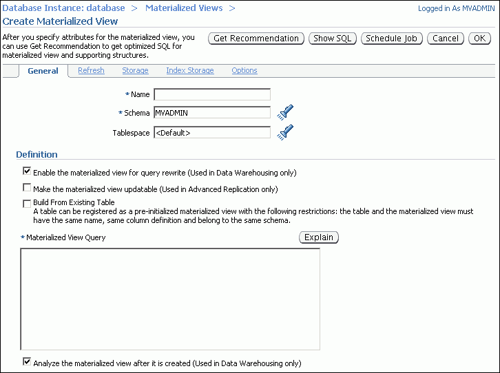

In Enterprise Manager, log in to the materialized view site as the materialized view administrator. The materialized view site is the database in which you want to create materialized views. The default user name for the materialized view administrator is mvadmin.
On the Advanced Replication: Setup page, expand Read-only Materialized Views.
Select Create Materialized View.
Click Continue to open the Create Materialized View page.
Complete the following actions to create the hr.employees_mvr materialized view:
Enter employees_mvr in the Name field.
Enter hr in the Schema field.
If you have a specific tablespace for the materialized view you are creating, then enter the tablespace name in the Tablespace field. Otherwise, leave <Default> in the field.
Deselect Enable the materialized view for query rewrite.
Ensure that the following are not selected:
Make the materialized view updatable
Build From Existing Table
Enter the following in the Materialized View Query field:
SELECT employee_id,
        first_name,
        last_name,
        email,
        phone_number,
        hire_date,
        job_id,
        salary,
        commission_pct,
        manager_id,
        department_id
FROM hr.employees@master_site
Replace master_site with the global name of the master site that contains the master table.
Deselect Analyze the materialized view after it is created.
If necessary, then set options for the materialized view on the other subpages. Click Help on a selected subpage for information about the subpage.
Click OK to create the materialized view.

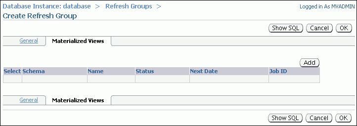

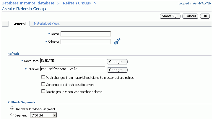

Create a refresh group and add the materialized views to it so that they are consistent with a single point in time when they are refreshed. In this example, add the hr.employees_mvr and hr.departments_mvr materialized views to the refresh group. See "Configuring a Refresh Group".
You can also use theCREATE MATERIALIZED VIEW SQL statement to create a materialized view.A read/write replica of a table is appropriate for databases that allow applications to modify the replicated data.

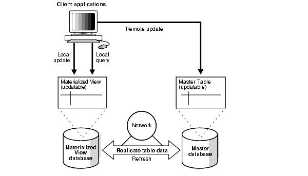

Updatable materialized views enable users to insert, update, and delete rows in the materialized views. When an updatable materialized view is refreshed, these changes are pushed to the master site and applied to the master table.
Figure 7-2 shows how an updatable materialized view works.
Figure 7-2 shows that client applications can query and update an updatable materialized view at the materialized view site. These applications can also update data at the remote master site. When the materialized view initializes a refresh over the network, the refresh includes two key phases. First, transactions that have been performed on the materialized view are pushed to the master site and applied as appropriate. Next, after resolving any conflicting updates, the materialized view pulls the changed row data from the master site and applies it.

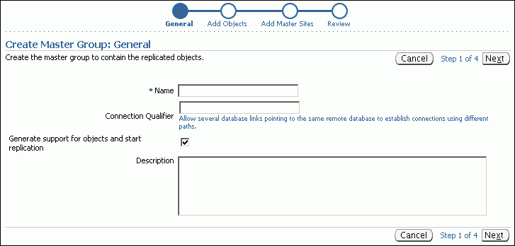

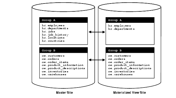

A replication group is a collection of replication objects that are logically related. Organizing related database objects within a replication group makes it easier to administer many objects together. At a master site, a replication group is called a master group. At a materialized view site, a replication group is called a materialized view group.
For changes made to an updatable materialized view to be pushed to the master during refresh, the following conditions must be met:
The updatable materialized view must belong to a materialized view group.
The materialized view group must be based on a master group at the master site.
The materialized view group can contain materialized views for all of the tables in the master group or for a subset of the tables.
Figure 7-3 shows two materialized view groups. Materialized view group A contains materialized views that correspond to a subset of the tables in the master group, while materialized view group B contains a materialized view for each table in the master group.
Figure 7-3 Materialized View Groups Correspond with Master Groups

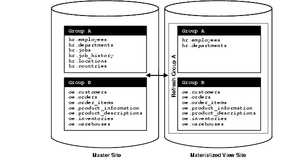

If you are using materialized view groups and refresh groups at the same site, then a single refresh group can contain multiple materialized view groups. A materialized view group is not the same as a refresh group, although it can contain the same materialized views.
Figure 7-4 shows a refresh group that contains two materialized view groups.
Figure 7-4 Refresh Groups Can Contain Objects from Multiple Materialized View Groups

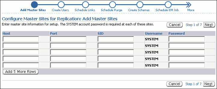

In Oracle Enterprise Manager, log in to the database that will be the master site as an administrative user, such as SYSTEM.
Select Configure Master Sites for Replication.
Click Continue to open the Configure Master Sites for Replication Wizard.
Complete the pages in the wizard to configure the master site. For more information about using the wizard, click Help for each page of the wizard.
When you finish the wizard, an Enterprise Manager job is scheduled to configure the master site. After the job runs successfully, the master site is configured, and it has a replication administrator. By default, the user name of the replication administrator is repadmin. You specified the password for this user when you completed the wizard.

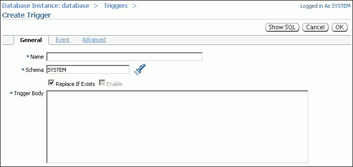

If you did not log out of Enterprise Manager after completing Step 3, then you can remain logged in to the master site as an administrative user.
Click Schema to open the Schema subpage.
Click Triggers in the Programs section.
On the Triggers page, click Create.
The Create Trigger page appears, showing the General subpage.
Enter the name of the trigger in the Name field.
Retain the administrative user name in the Schema field.
Enter the following in the Trigger Body field:
BEGIN
   -- The IF/THEN statement ensures that the trigger does not fire during
   -- materialized view refresh.
   IF (DBMS_REPUTIL.FROM_REMOTE = FALSE AND
       DBMS_SNAPSHOT.I_AM_A_REFRESH = FALSE)
   THEN
      :NEW.TIME := SYSTIMESTAMP;
   END IF;
END;

Expand Multi-master Replication.
Select Create Master Group.
Click Continue to open the Create Master Group Wizard.
Complete the pages in the wizard to configure the master group. For more information about using the wizard, click Help for each page of the wizard.
Tip:
On the Add Objects page, add the tables that will be master tables for the materialized views.
On the Add Master Sites page, do not add any additional master sites.
When you finish the wizard, an Enterprise Manager job is scheduled to configure the master group.

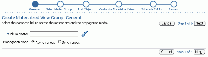

Select Create Materialized View Group.
Click Continue to open the Create Materialized View Group Wizard.
Complete the pages in the wizard to configure the materialized group. For more information about using the wizard, click Help for each page of the wizard.

When two or more materialized views must be consistent to a point in time, the materialized views should belong to the same refresh group.
To create a refresh group and add materialized views to it:
In Enterprise Manager, log in to the materialized view site as the materialized view administrator. The default user name for the materialized view administrator is mvadmin.
Click Manage in the Advanced Replication section.
The Advanced Replication: Administration page appears, showing the Overview subpage.
Click the number associated with Refresh Groups in the Materialized View Site section.
On the Refresh Groups page, click Create.
The Create Refresh Group page appears, showing the General subpage.
Complete the following actions:
Enter a name for the refresh group in the Name field.
Enter the owner of the refresh group in the Schema field. Typically, the materialized view administrator owns refresh groups.
If necessary, then adjust the Next Date and Interval settings. The Next Date setting determines when the next refresh of the refresh group will occur. The Interval setting determines how often the refresh group is refreshed automatically. You can click Change to open a new page that adjusts each setting. Click Help for more information.
If you have limited connectivity between the materialized view site and the master site, then you might want to refresh on demand. In this case, clear the Interval field.
Select Push changes from materialized views to master before refresh. This option specifies that, during refresh, the materialized view site pushes changes made to updatable materialized views to the master tables before refreshing the materialized views.
Click Materialized Views to open the Materialized Views subpage.
Click Add to open the Search and Select: Materialized View page.
Use the search tool to list the materialized views that you want to add to the refresh group.
Select the materialized views that you want to add to the refresh group.
Click OK to return to the Materialized Views subpage. The selected materialized views should be listed in the refresh group.
Click OK to create the refresh group.
